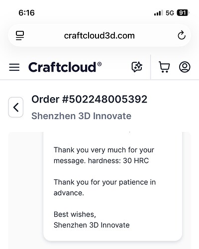

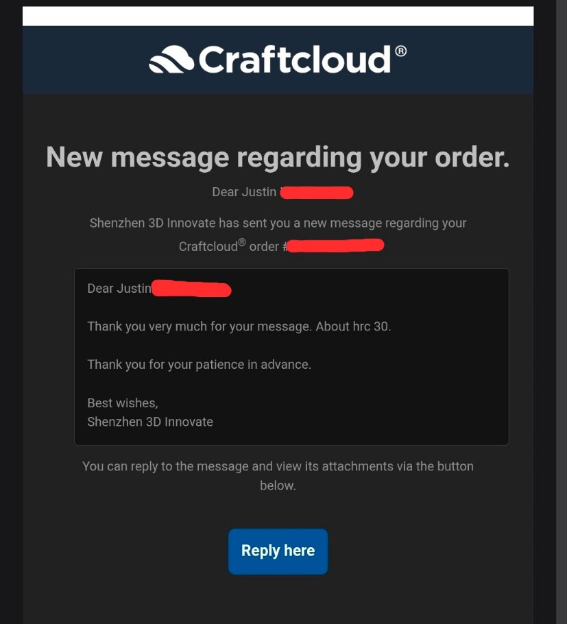

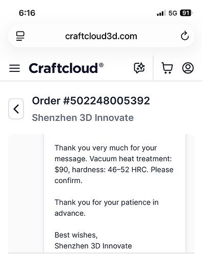

I hope this isn’t the case for me. I ordered spurs from shenzen that should be arriving in the next week. I won’t have any way to test hardness tho.
They’re claiming 30 hrc is to be expected.
Yup same here.

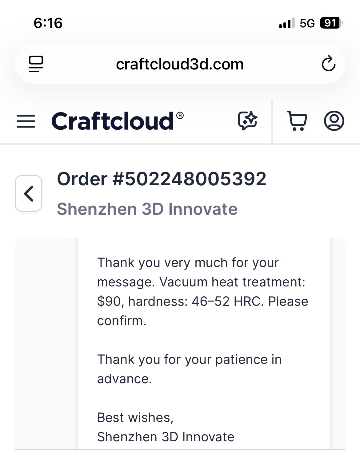

Or $45 additional per spur gets 46-52HRC
You requested hardening right?
https://forum.esk8.news/t/diy-onewheel-based-on-nitrox-xl-10/92384?u=pecos
Somehow this one wheel thread became about hardening? Maybe there’s some crossover
I opted for no hardening on these because I want to make sure tolerances fit before I spend the extra $90 for hardening. I’ll test to see if they wear down excessively and if they do will order another set with the hardening included.
These are for a medium power board so maybe that will help them last longer.
I have a feeling they may last a while, especially if the wheel gear is the same or lesser hardness
Isn’t +90 for hardening very expensive? You can get cnc gear with hardening for less than a slm gear with hardening
They quoted me at $75 to harden four truck clamps and four driven gears. Wondering if it’s inconvenient for them to harden fewer parts so you pay more? That or their pricing is just inconsistent.
$45 per spur for additional hardening, does seem excessive. I contacted Konlida which I believe is cnc. I know others have used them from this forum and was quoted $160 per spur for the smaller quantities I’m looking for. Price drops to $100 per spur for quantity of 10 but that’s not realistic for my project. (Tito used Konlida and the quality is very impressive).That was 42 crmo quenching and blackening. I think I saw someone have spurs made from sendcutsend and they were showing wear so don’t want to go that route.

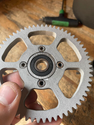

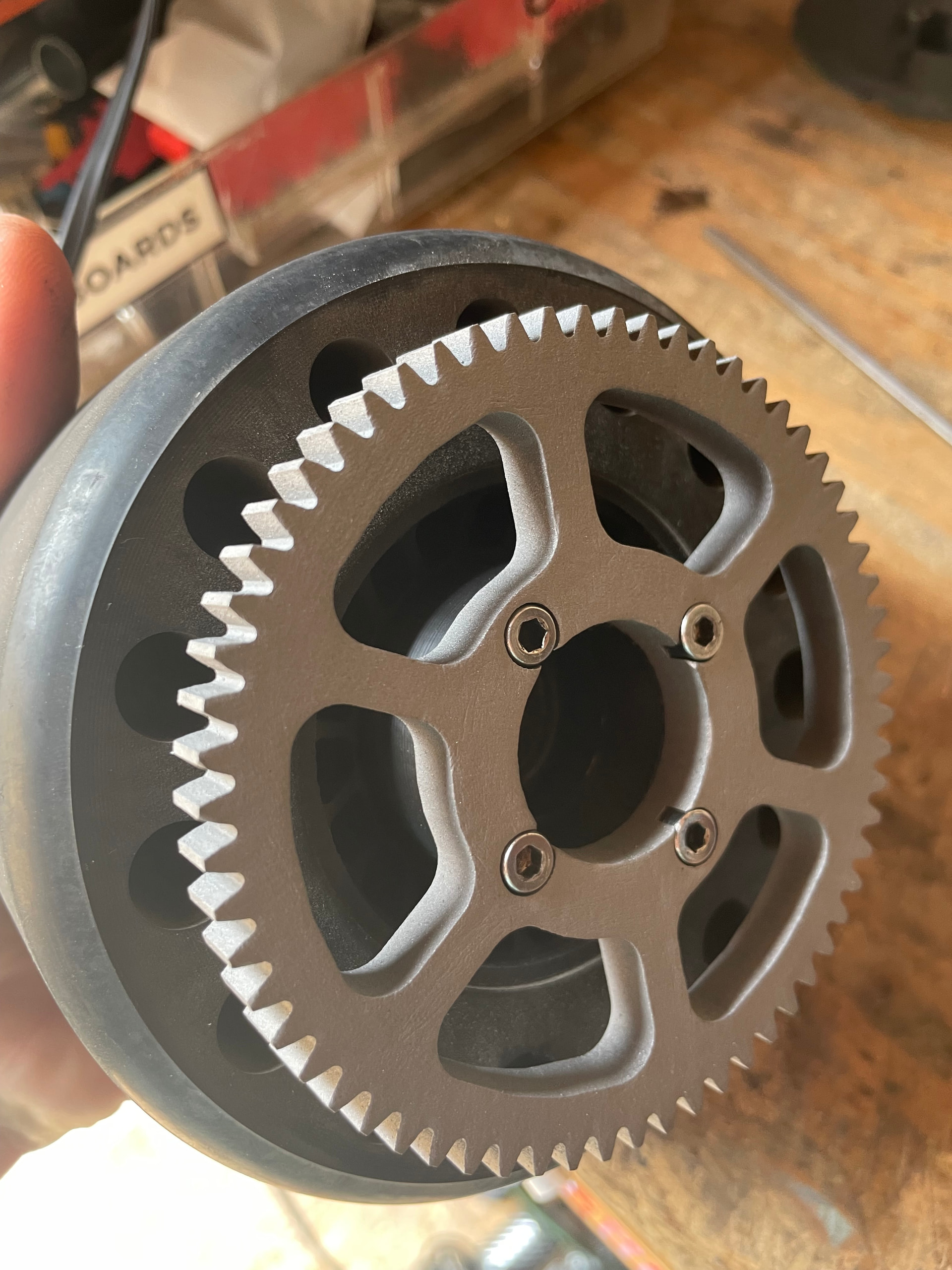

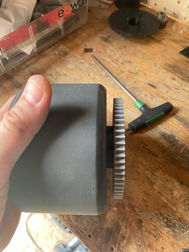

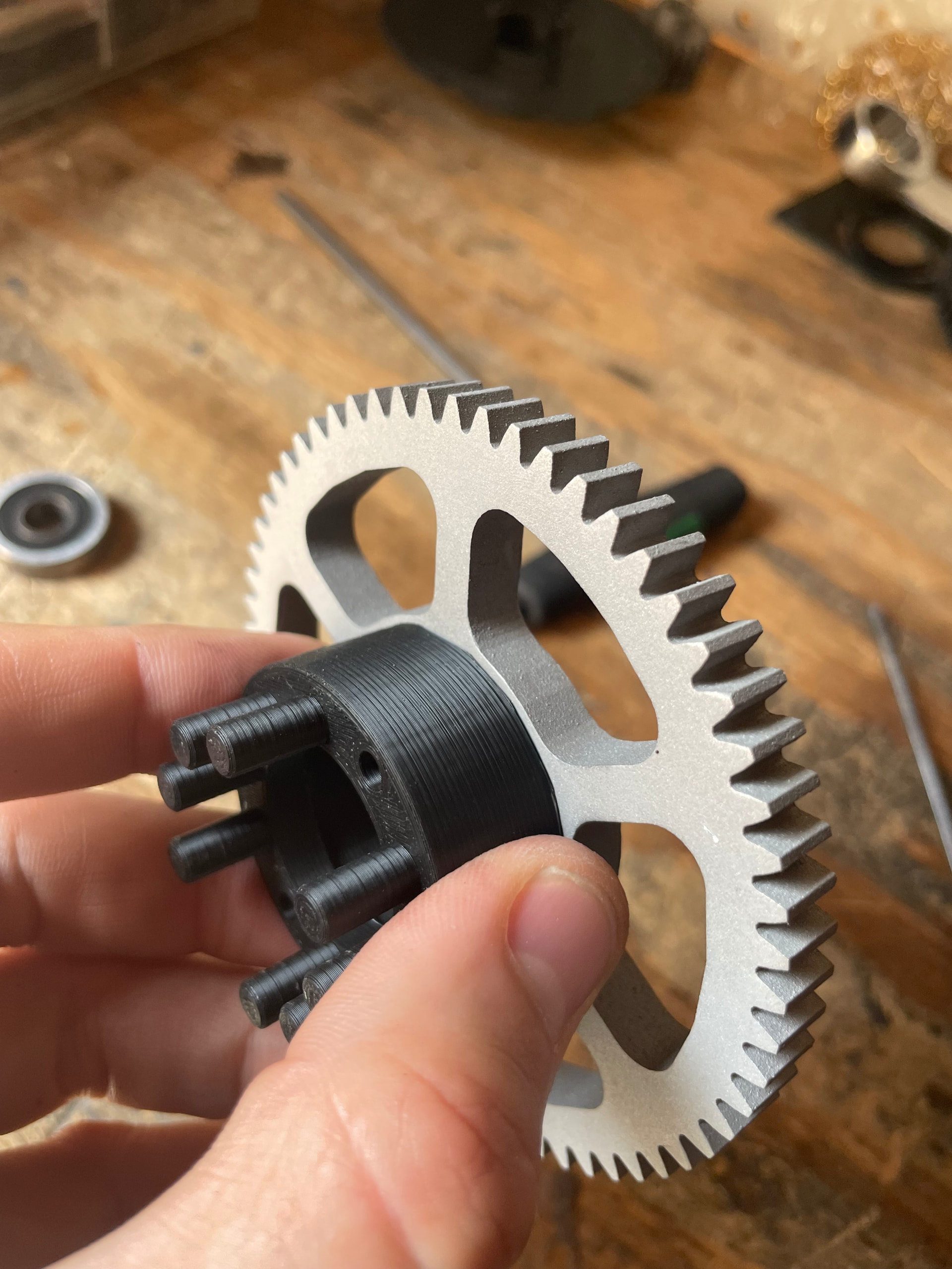

Just received my first SLM gears. Very impressed by print quality! Unfortunately I ordered the adapter part from another vendor that experienced the part breaking when tapping and had to reprint it. So waiting on that part to arrive to test these out!
This is for an open gear project I’m working on for 125mm wheels 63/21.
