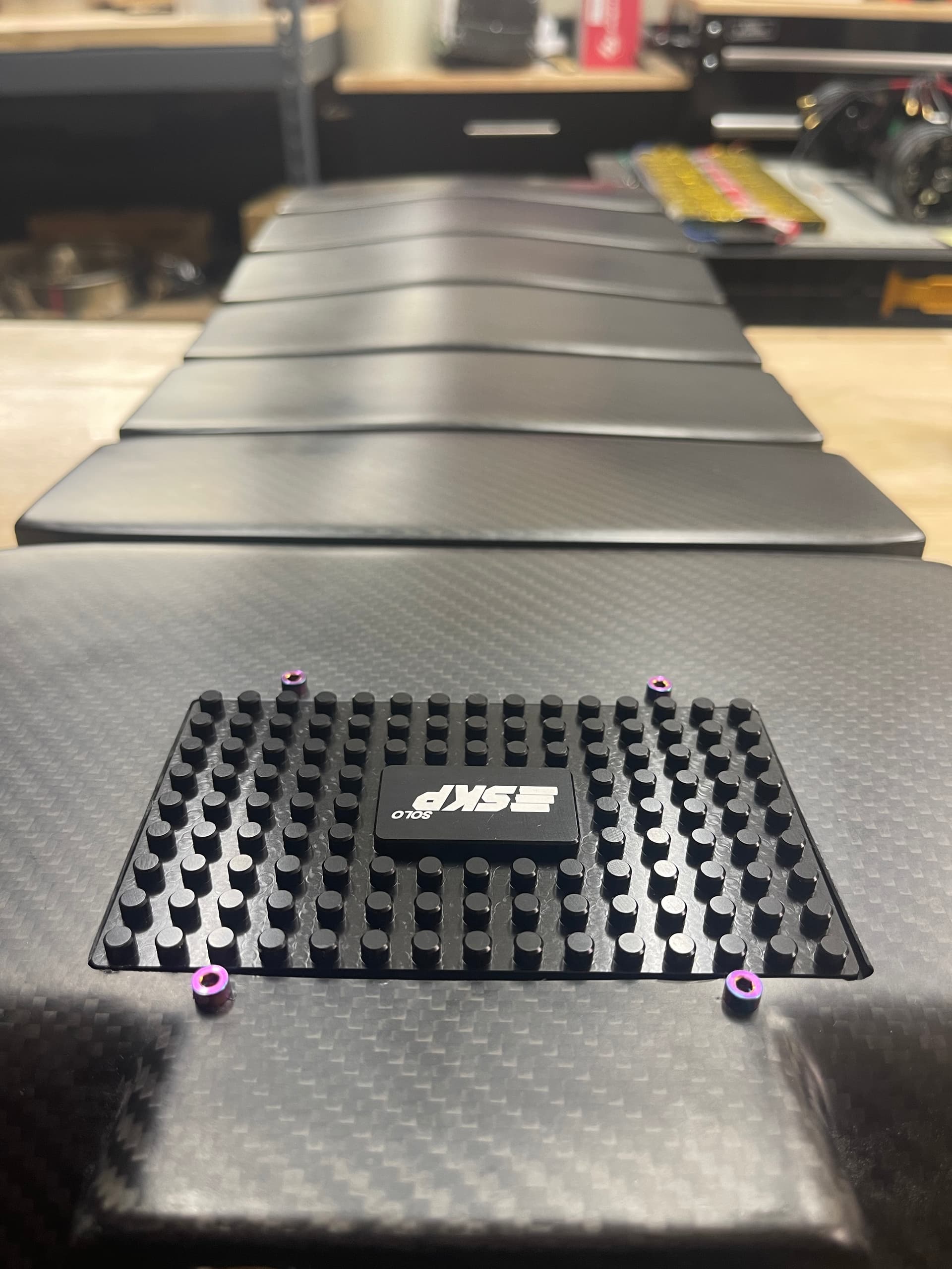

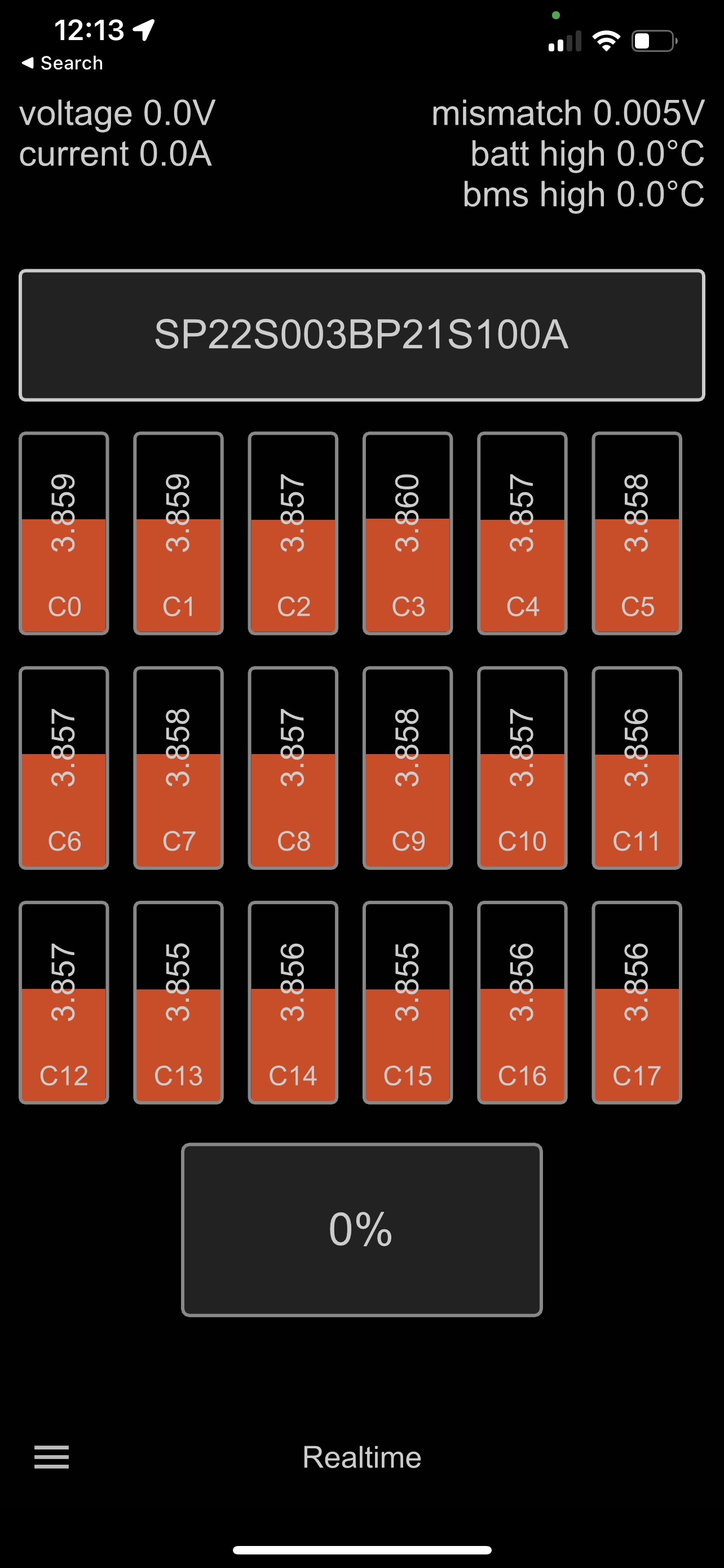

Impressive board! What bms is in that beast? Balancing specs look great.
Good old LLT 18s smart BMS the older square one
Good bye and good riddance unity!!!
can a lego attach to that heatsink and if not why not :joy:

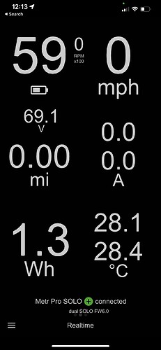

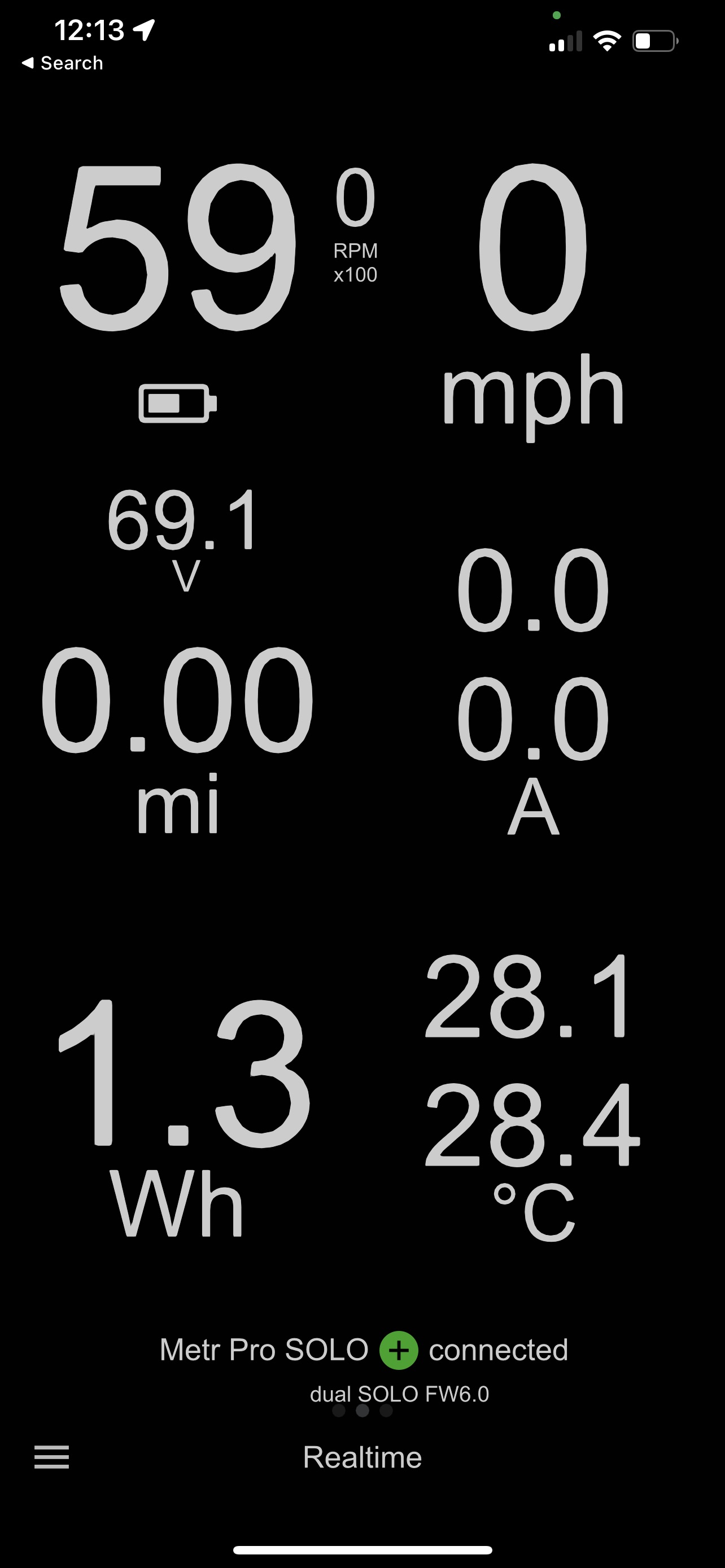

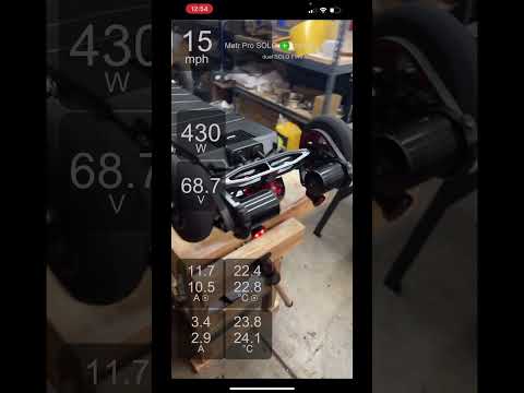

Speed is inaccurate tho, I entered 16t motor pulley but it is actually 18t :dizzy_face::fire::sunglasses::sunglasses::fire::fire::zap::zap::zap::zap:
What BMS are you using and how does it connect to the vesc for data?
metr has support for connecting to LLT bms over BT

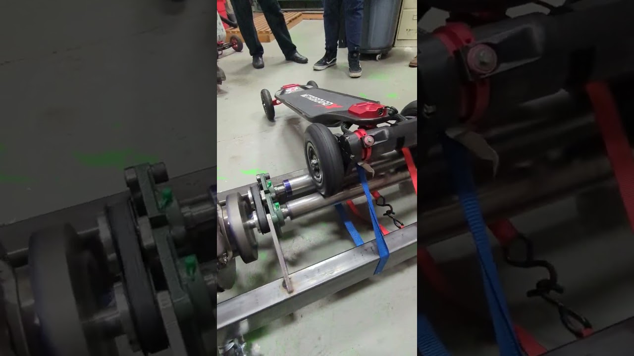

Dyno ready for load tests almost! Just need to find a better tie-down system than random ratchet straps lol
Wait where’s the blower to feed the motors air? lol
Rachet straps and wood chucks for the front wheels are basically all they use for cars
Is the final goal to have the board level similar to a car dyno?
The angle of the board has absolutely zero effect on the performance so we don’t really care about that
I am not as concerned about motor heat as esc heat, for sure some sort of ride similar air flow should be added to the set up
I’m thinking more weight on the board? I suppose you could literally just tie weights too it as well .
But is is strapped down. At the trucks. That would simulate some weight
Oh yeah that is totally true. Didn’t think about that.

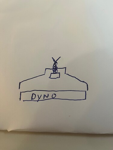

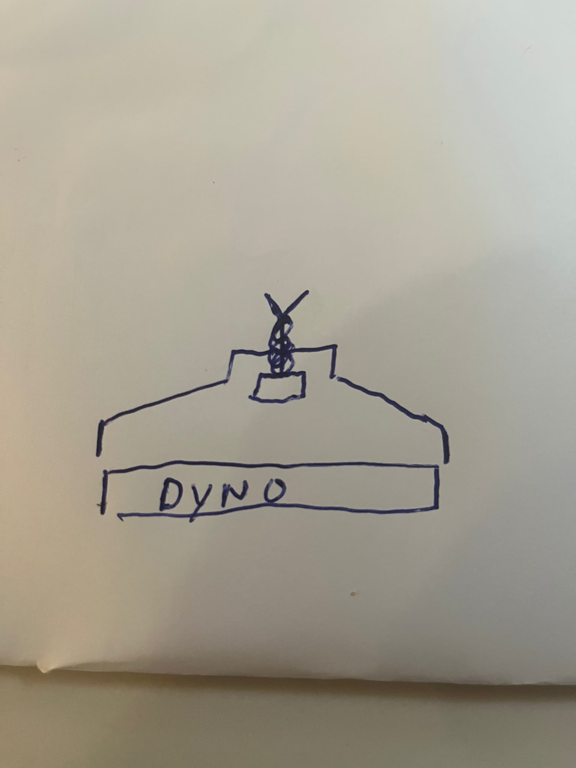

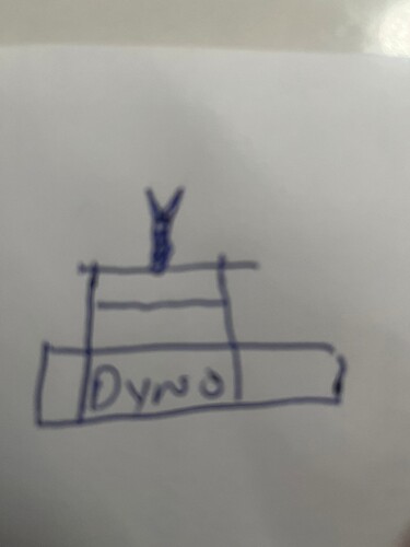

can you use an attachment (arm )with spring preload perhaps that attaches either from the square tube at the back side the arches over to fix the board in pace or simalarly (sp?)an attachment that slots in to the sidesto fix it in place. the sloted attachment points would be where the blue strap is on the floor, (sorry im not explaining my self well) make an fixture that attaches to theflat plate near the blue strap,use some strong springs to positively engage the board(or threaded adjustment )have the fixture have sloted tabs to attach to the flat plate with square or round tube,where it engages the deck have a H shape with pates. Ill add a crude drawing in a second, cool dyno
Or 2 uprights on either side of the deck with a cam over that has a single attachmend to the back square tube, againg a strong spring or threaded rod gives the finl adjuetment. Sorry if this is all stupid cryptic and or obvious,just trying to help, improvisation is my fore te, im the Mac Guyver of heavy engenering construction
Hell just 2 upright Stanton’s with an angled flat plate that is adjustable below the deck, corresponding flat plate adjustable above with foam on both . Ignore my stupid ideas I can’t help it I see solutions everywhere
