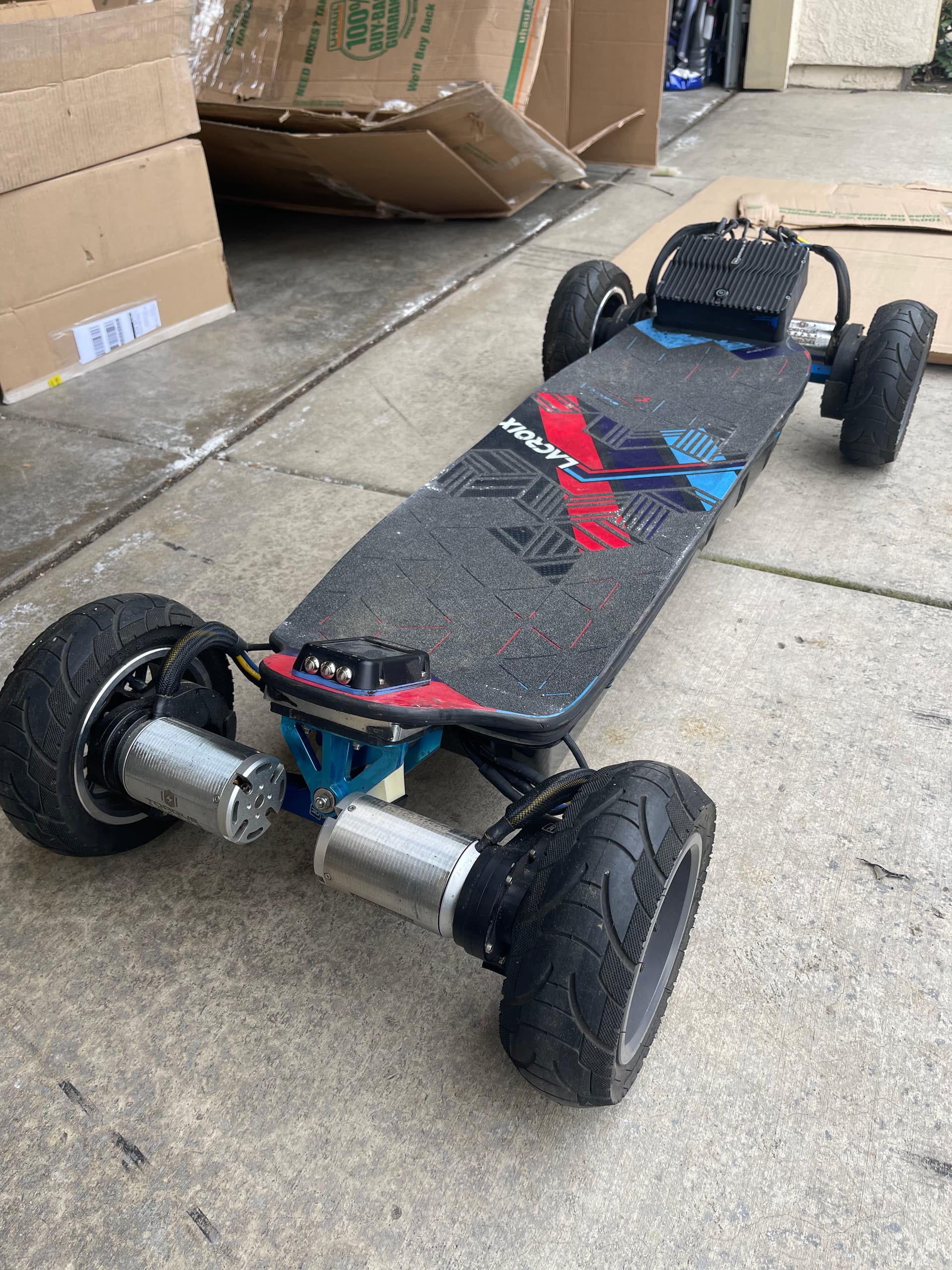

Next custom board is almost complete, customer asked for best carving possible, low speed and insane torque!!
Finality 1:4 gearing 60a barrels
125KV SKP 6485 motors
12s4p p42s
Stormcore
Barrel Deck and enclosure
10 degree front wedge riser
Maytech remote
This isn’t my normal time of go to board, but man making a tight radius turn like that is super fun :rocket::crazy_face:
Haven’t applied the grip tape yet, but I have a feeling once I do this thing will turn in 6’ radius maybe less
In June of 2021 I finished a board with the very first Finality gear drives I ever purchased from @3DServisas
These have NEVER been serviced installed around June and sometime in July the board became 4wd by adding more geardrives to the front
Sometime later that year the board sold to @WAVMOB who has been mobbing around Florida for a few years now on it!
Every good board needs to be serviced!!! Things still seem to be running really well and the battery is dang near perfectly balanced (18s12p that was shipped fully charged :dizzy_face:…and held at FedEx for unknown reasons for 2 weeks)
Will be a tearing into the gear drives replacing the motors for SKP 6485 and stormcores for Solos sometime at the of the month when more solo stock arrives and I ship all pending orders(by this coming Monday btw)
Now the board as it sits today
