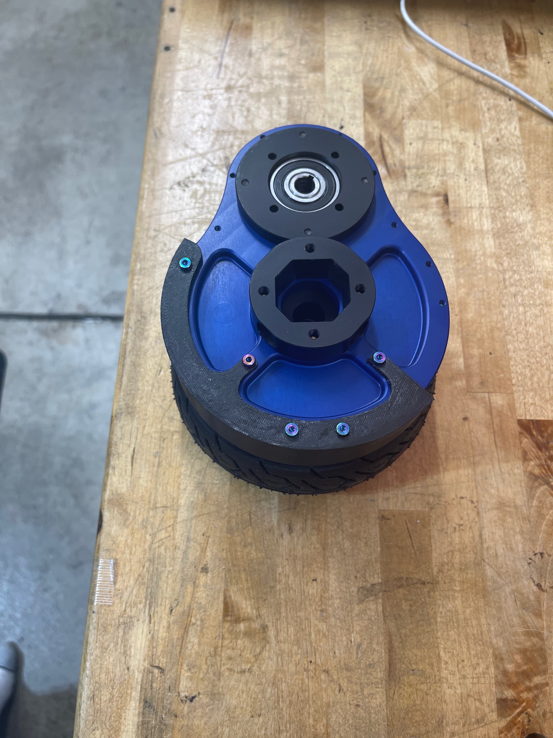

127mm its large because I believe mod 2 teeth are used in that drive…possibly mod 2.5
Ah got it, so what’s the smallest wheel you can run on the 5:1?
5:1 is really chonky, only reason I didn’t get. Feel like it wouldn’t work great off roading with 8”, but maybe I’m wrong :man_shrugging:t3:
Depends on where you ride, but I don’t see any issues with 200mm or 8” I personally run 8.5” on these and I guess if you are riding in places without many pot holes you could even throw on some 160mm tires
Lol never mind, I wouldn’t mess with 160mm
160 below and 150 on top
LOL, damn
8”
7”
8.5 works out well tho
Eh that doesn’t look like enough clearance at all for offroad on 7, 8 is even pushing it
Those 8.5 look more reasonable but they aren’t offroad tires lol
Yeah I’d say 9” minimum for rough off road.

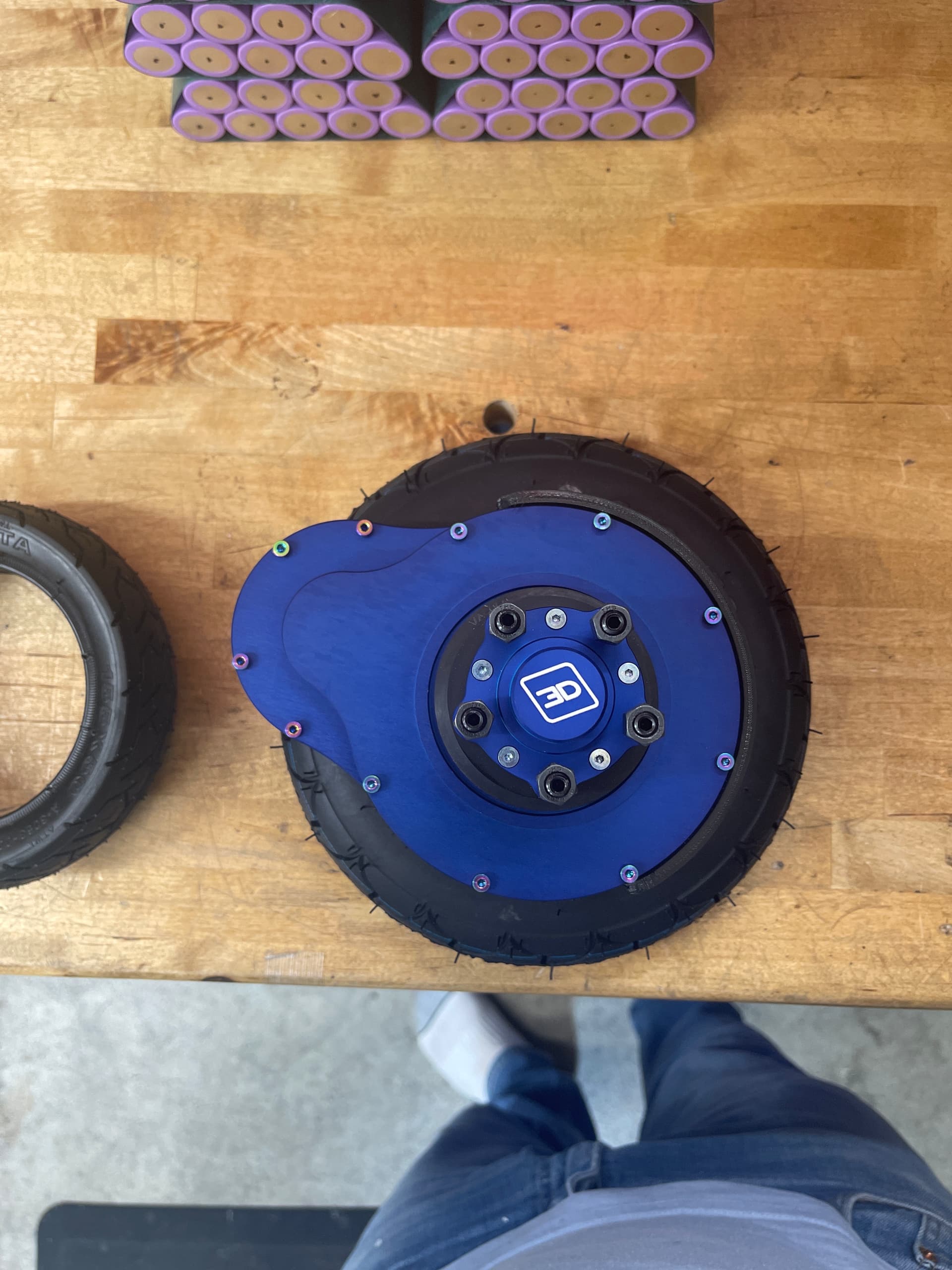

Yeah it depends on the type of off-road you are doing. But yeah 9” is like the best Size for true off road also keep in mind all these tires are deflated and such and the picture angles may not tell the full story
About 45-50mm clearance
Here is a pic of an inflated 8.5” tire
You’d need to make the mod smaller…
Oh yeah that’s not horrible, but again not offroad tires. For on road this would be cool, but I’d probably want to look at higher voltage, even 5.2 to 8.5 inch on 190kv 100a motor is not great torque
