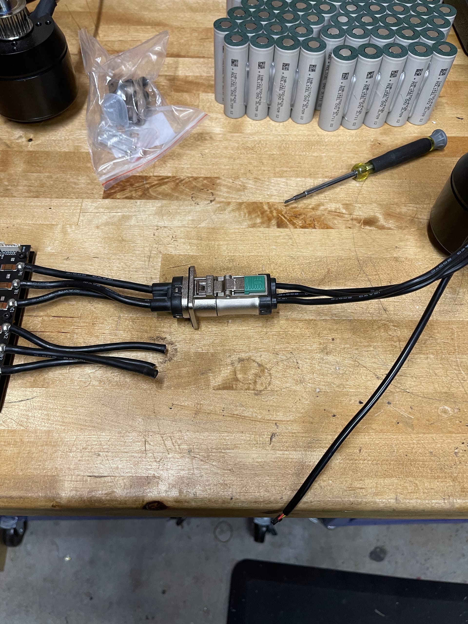

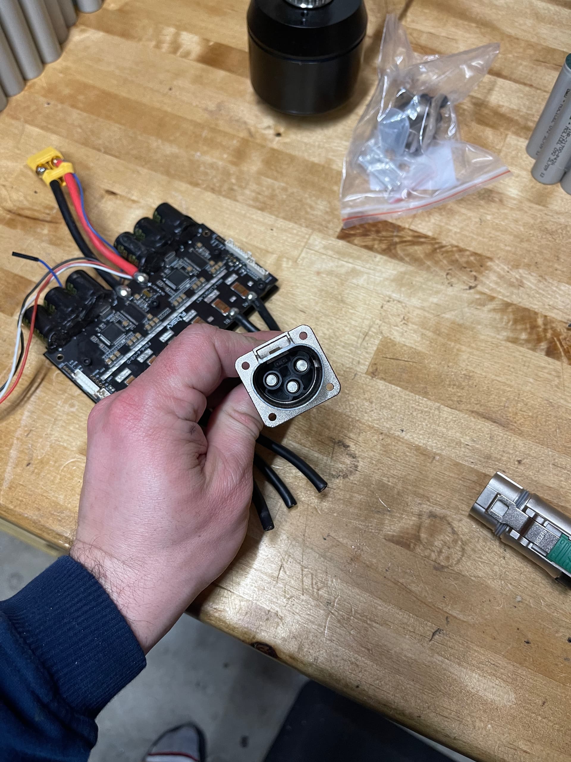

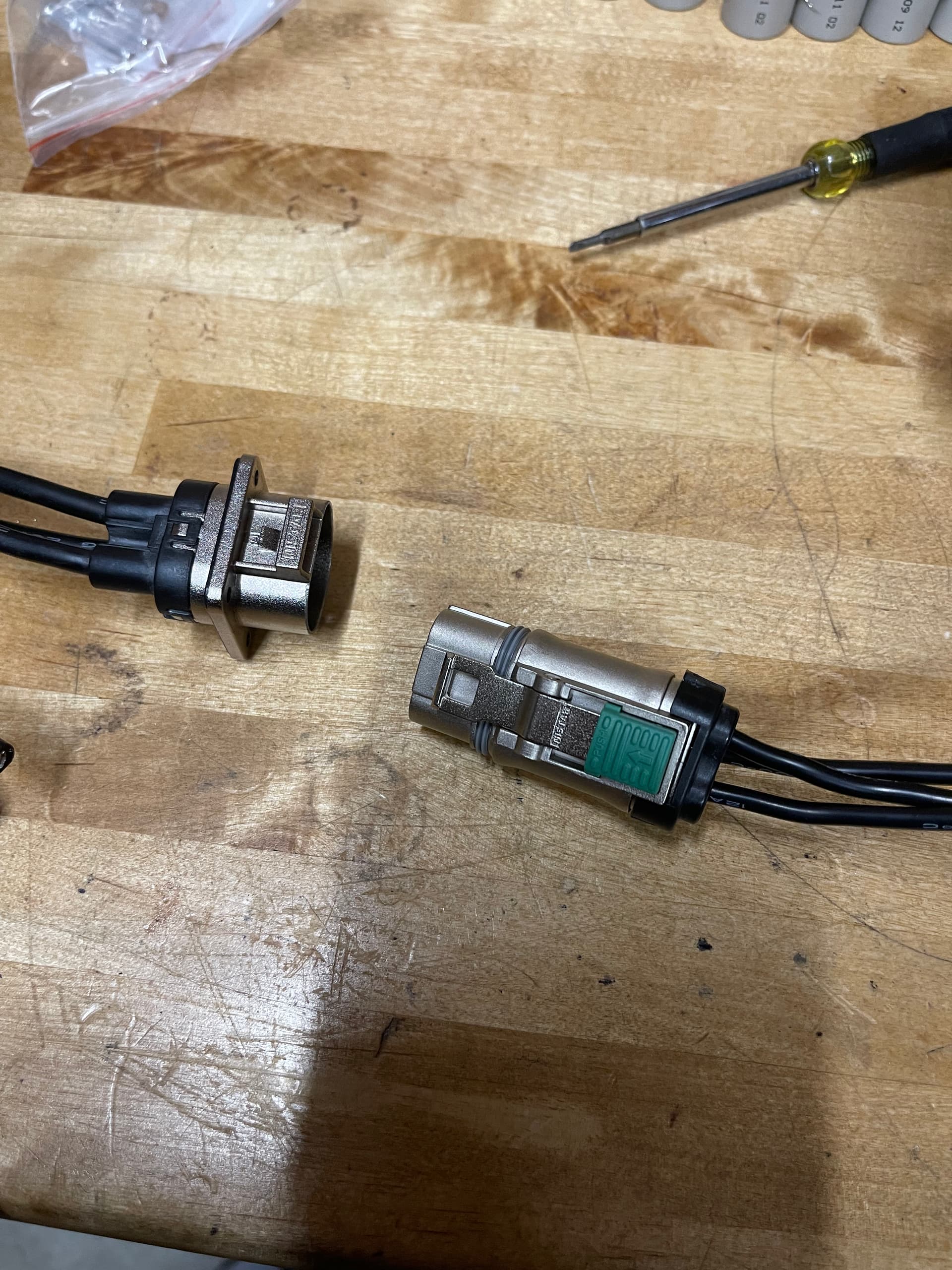

Well these turned out pretty ok
Fuckin beefy. What are they?
I might just call them that…beefy. They are a touch bigger then I wanted, sourced them in alibaba. Ip67 or whatever water tight connection and fairy easy install. Rated at 45amps per pin continuous. Hoping they will make me a slightly smaller version for 12awg wire and like 30amp…would be perfect also the female is panel mount and I love that

Very solid connection tho

Are they completely custom? Got a link? xD
so nice, would for sure be nice if they could make it a bit smaller, at least not as long on the male/motor phase side
Yes custom 3DS rim, I’m sure it will be coming to their store soon, if you would like a set let me know, I have a few.

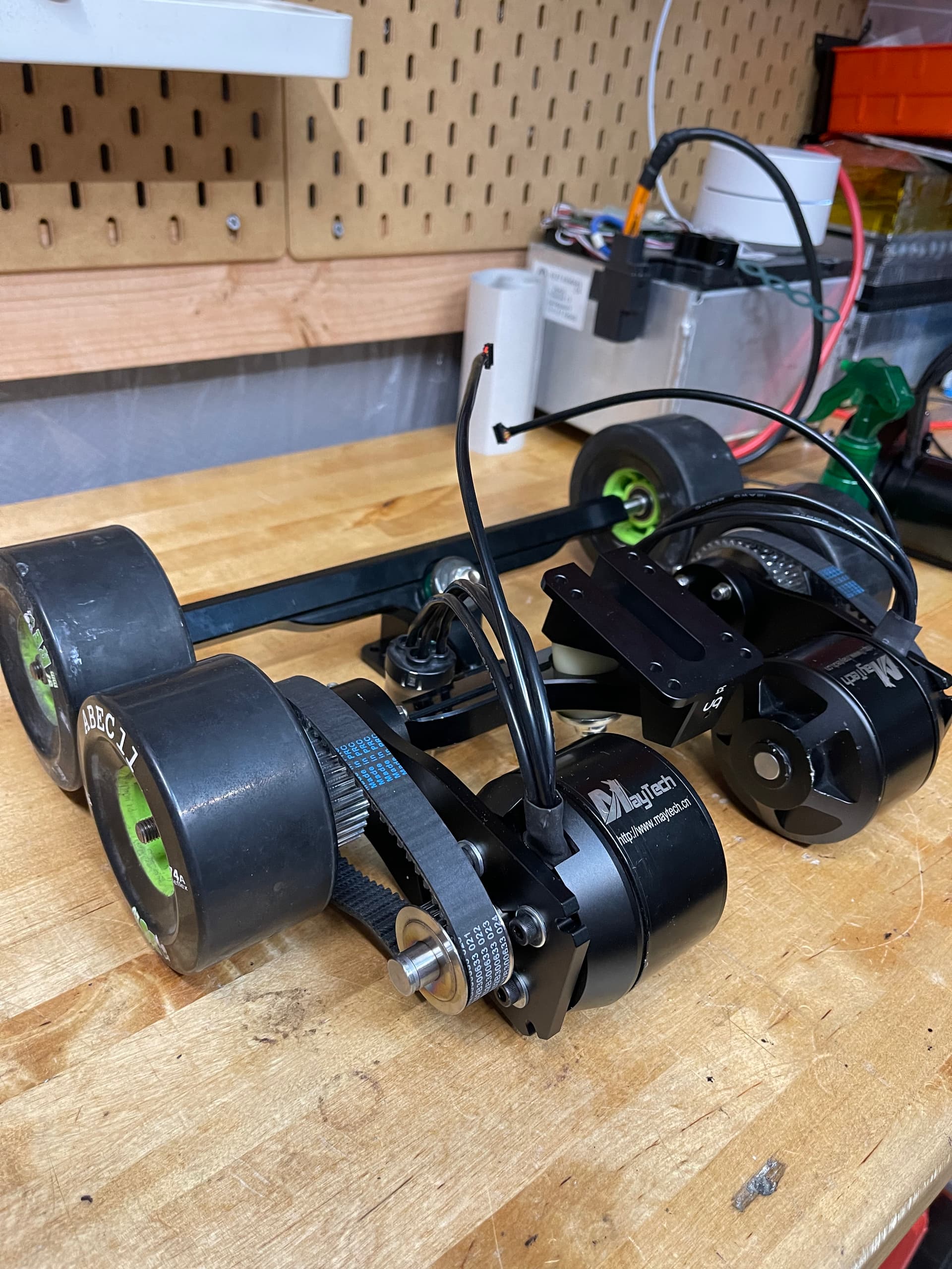

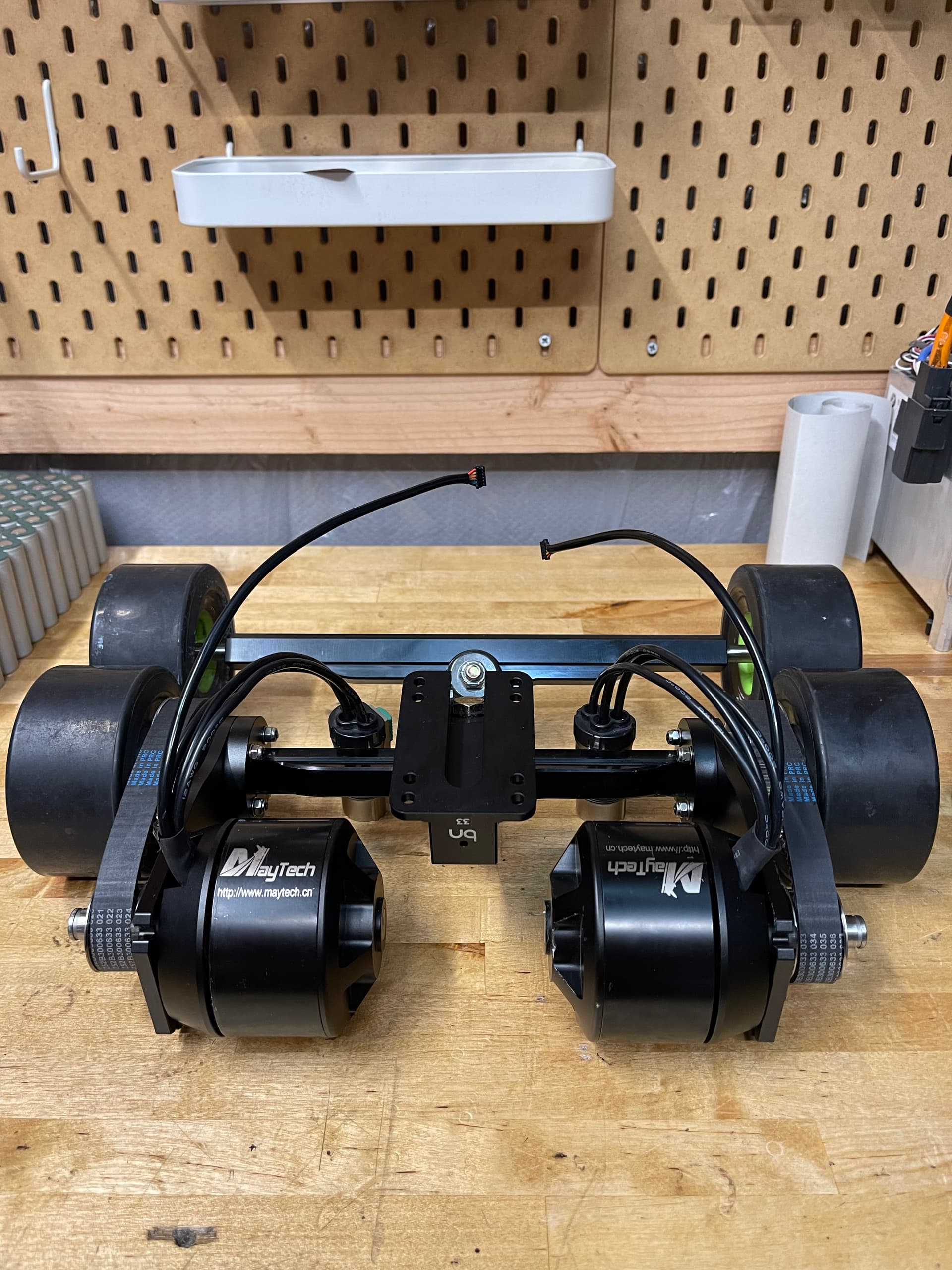

Just put this together for some fun
BN270 hangers
Idler mounts
Maytech 8075
97mm abec
1:2 ratio
Not sure what voltage would be most fun :laughing: might sell this set up once zoobomb 111s arrive
