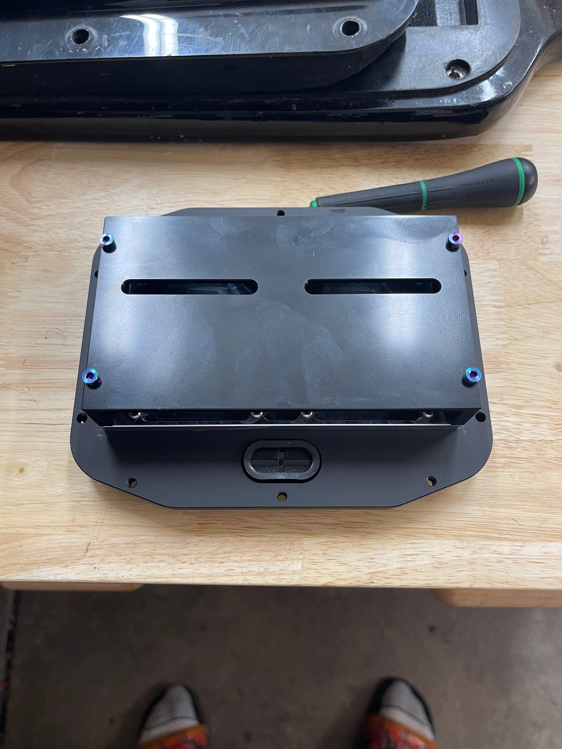

@Skyart does this mean that the heatsink on the top-mount dual option will come pre-drilled for a bolt pattern that will match one of the ones already in the 3DS enclosure?
By the way, when you get that up on the site I think it would be a good idea to include a pic of it in the enclosure to show how much space is still available in there. From measurements it looks like it should be a comfortable fit.
Yes
There is an aluminum plate inside that enclosure that other ESCs would mount to, you remove this plate and the solo dual heatsink mounts straight to the bottom of the box heatsink
Il add pics of this tonight

You take part the enclosure
Remove 4 bolts on the underside that hold this raw aluminium piece
Bolt solo dual top box enclosure down using the same 4 bolts
