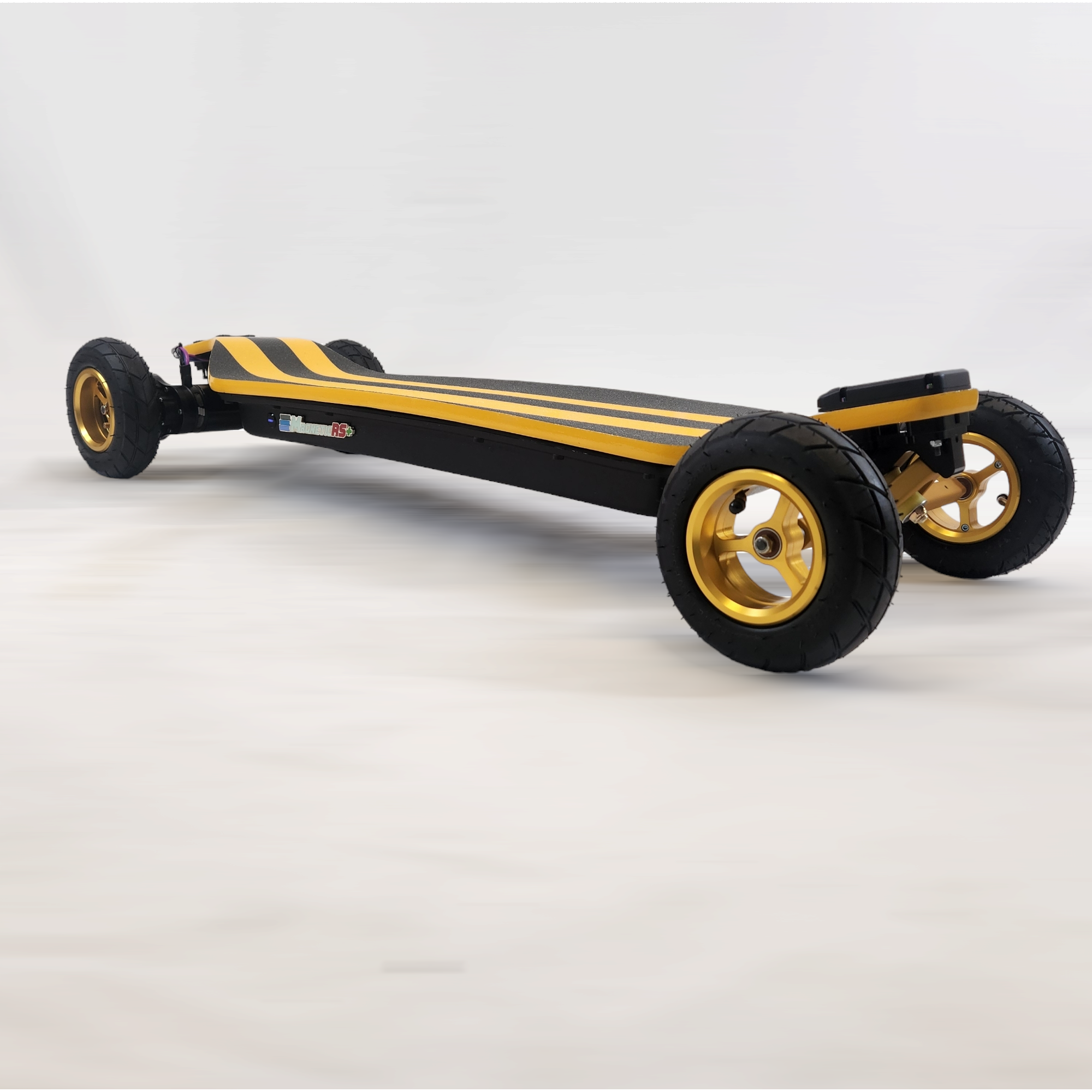

Thank you! If you love your Evo and are wanting it scaled up and made fit for a larger battery…this is it! Also if you been contemplating pneumatics but love thane, can’t recommend the BKB 150mm enough, they are the perfect transition into AT without loosing the feeling of thane that some many love.

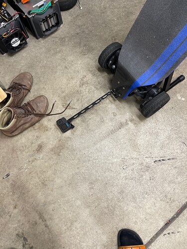

This has got me thinking about an ideal camera mounting setup for filming stuff like this. What failed on the one in the vid when it fell off?
Cheaper aluminum mount, I am going to try @SabreDynamics claw mount next :grinning:
Will ship it out tomorrow :slightly_smiling_face: Should work for what you need, I’ve tested similar camera angles :metal:
I think the extension was the real issue, it puts quite a bit of leverage on the mount
Yes, the longer the extension the more the leverage. Another issue with a longer extension is that they can swivel down a little with many vibrations, since the gopro thumbscrew clamping pressure will decrease as it comes a looser. When offroading with a 25 cm extension I had to tighten the screw from time to time. On a later ride I put a bolt through the ribs of my extension and used it as a holder for a skate bushing which got wedged between the bottom of the extension arm and the top of the deck. This prevents the arm from swivelling down, works like a damper stop basicly.

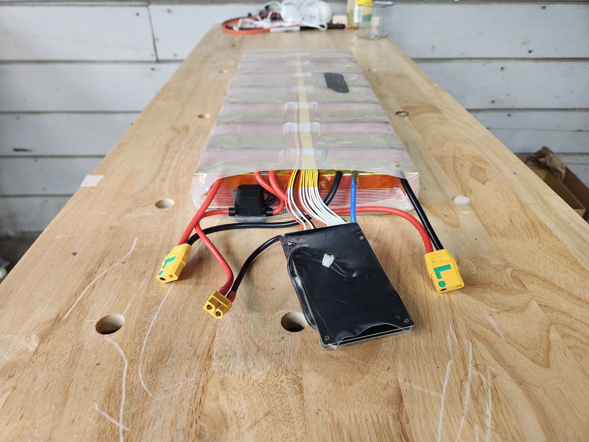

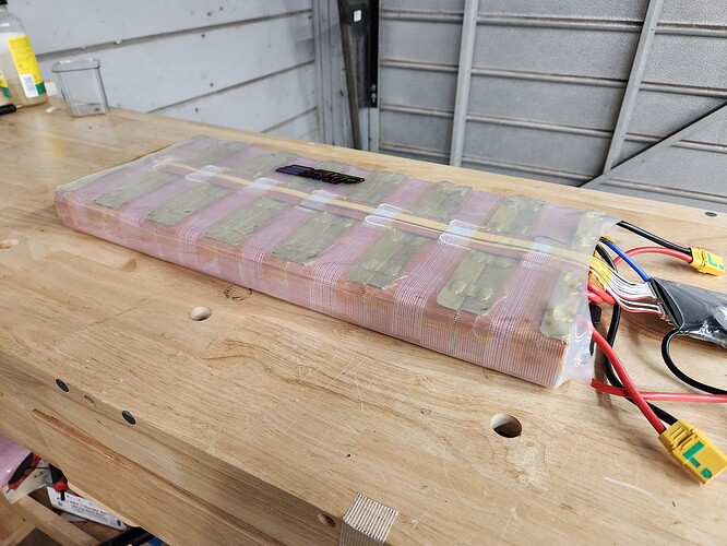

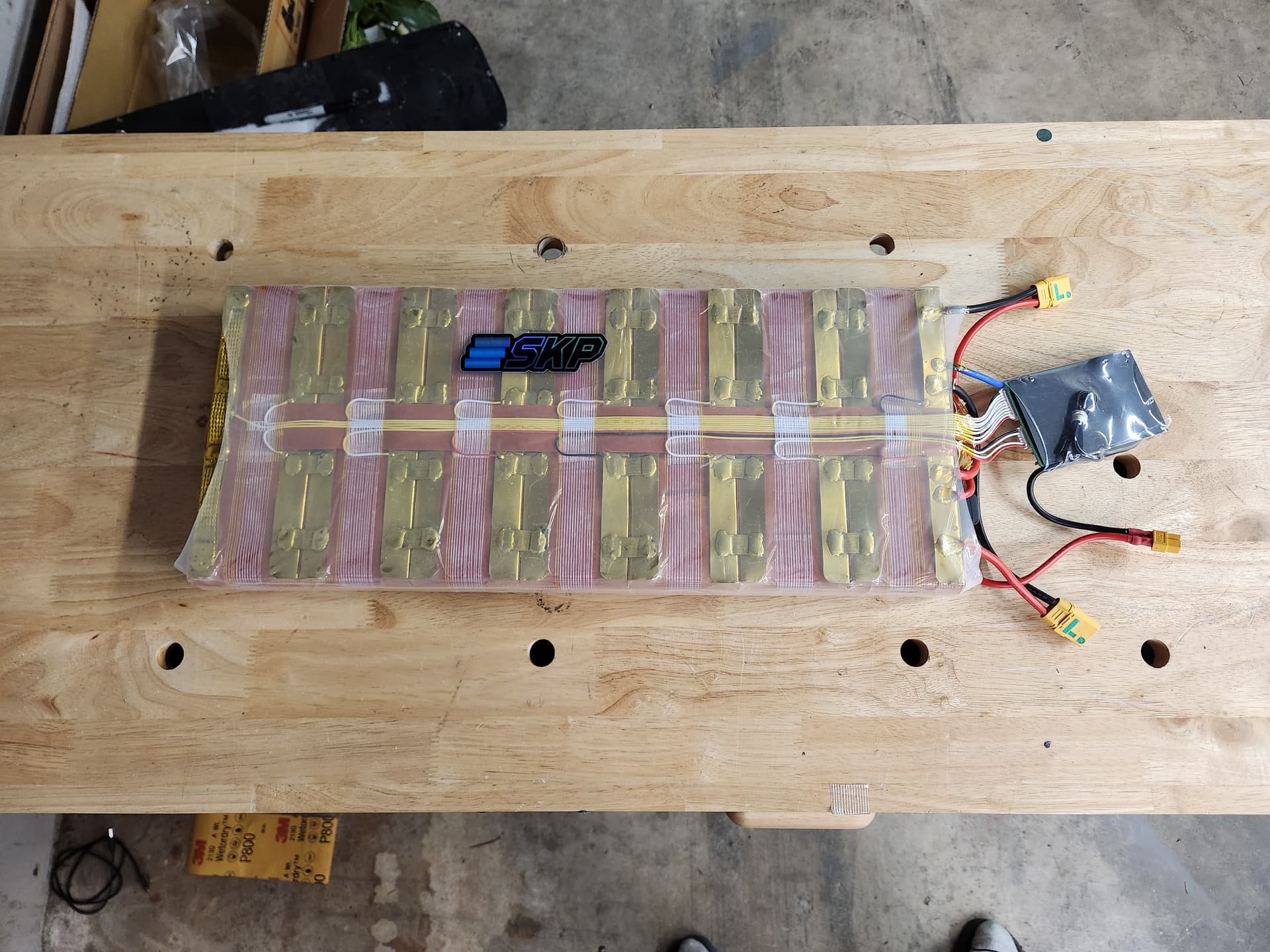

Official Magnetic R battery 14s10p LGM50LT and Samsung 50S for those that want a bit MOAR AMPS!
Also one of the first batteries to leave my shop without me doing any work on it…the shop guys are getting good… real good
