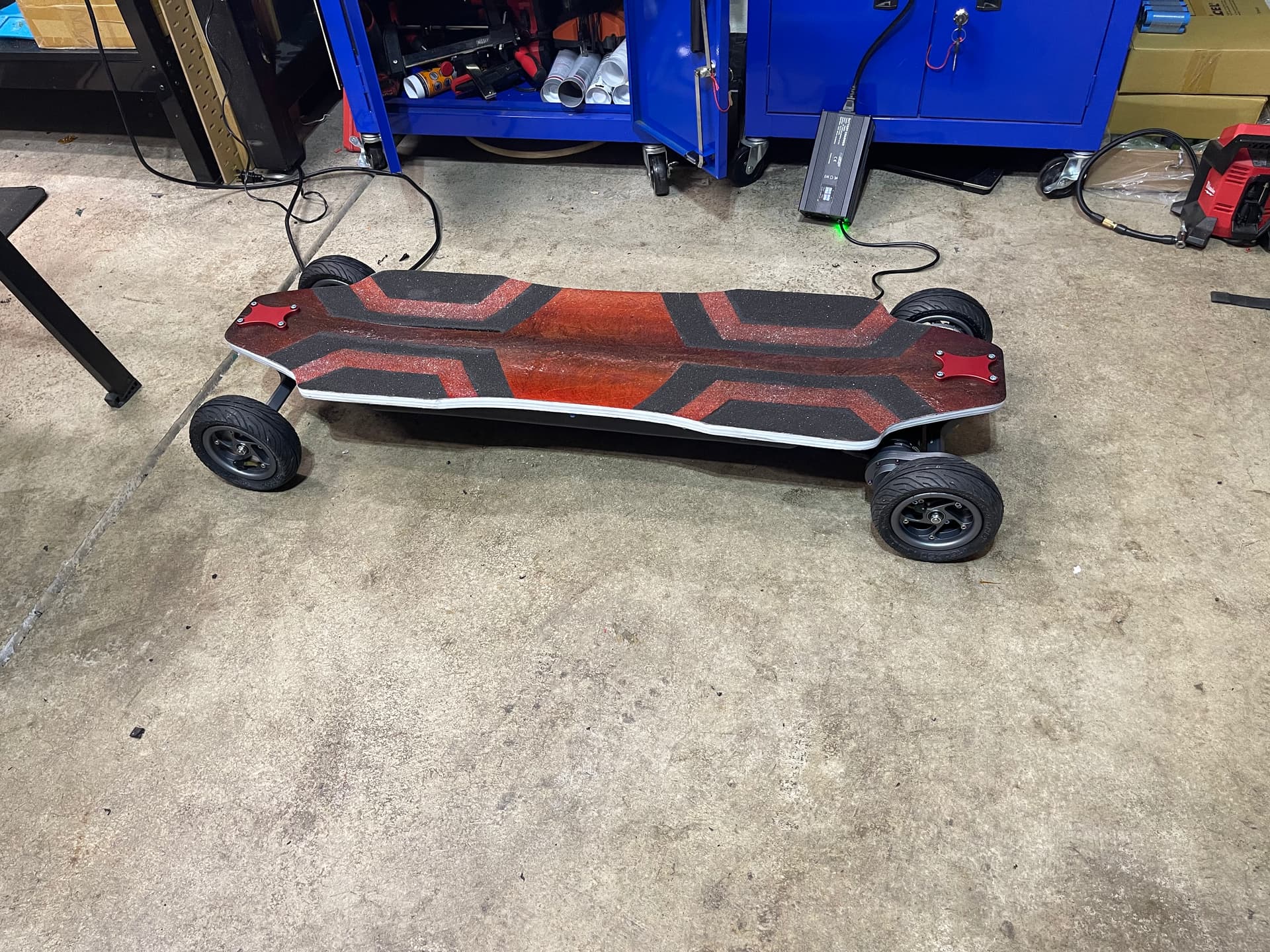

What does his setup look like? I’m assuming he’s bombing up some hills really fast?
1:3 helical
6485 173kv
6” TB tires
12s8p p42a
He is going up and down in elevation about 800-1000’ a few times in that ride

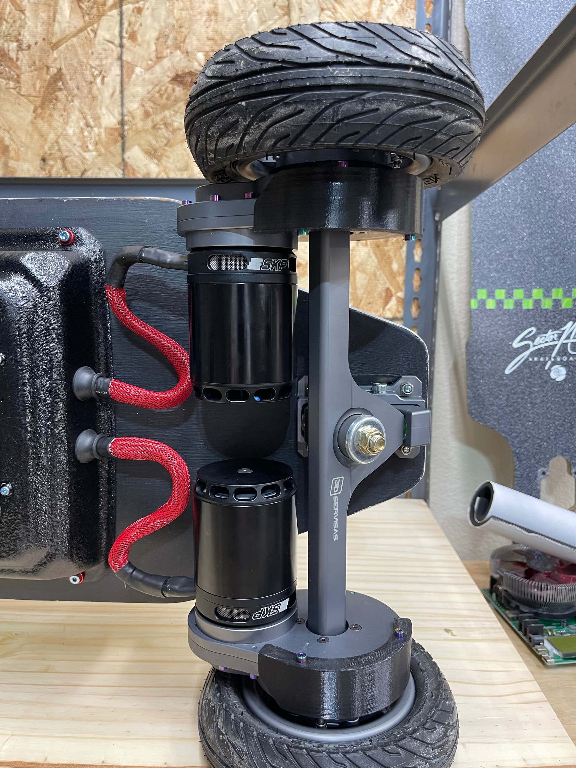

Can’t wait to abuse test these 7490’s on my build, i’ve tried to make everything else as bulletproof as possible lol.

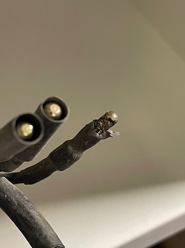

That’s good news, because…
… those are no good.
Disclaimer, not my picture.
Are those the crappy banana plugs or whatever they’re called?
:point_up:
They are not ideal, but I’ve been pumping 100 motor amps through these motors with those connectors and have not had an issue with a single one :man_shrugging:t2: But yeah the other connector is better for sure
how come the crap ones are used on flipsky and maytech/lacroix motors
I believe that is a rhetorical question
Companies take shortcuts where ever they can, it’s easier and cheaper to get the shitty connectors
