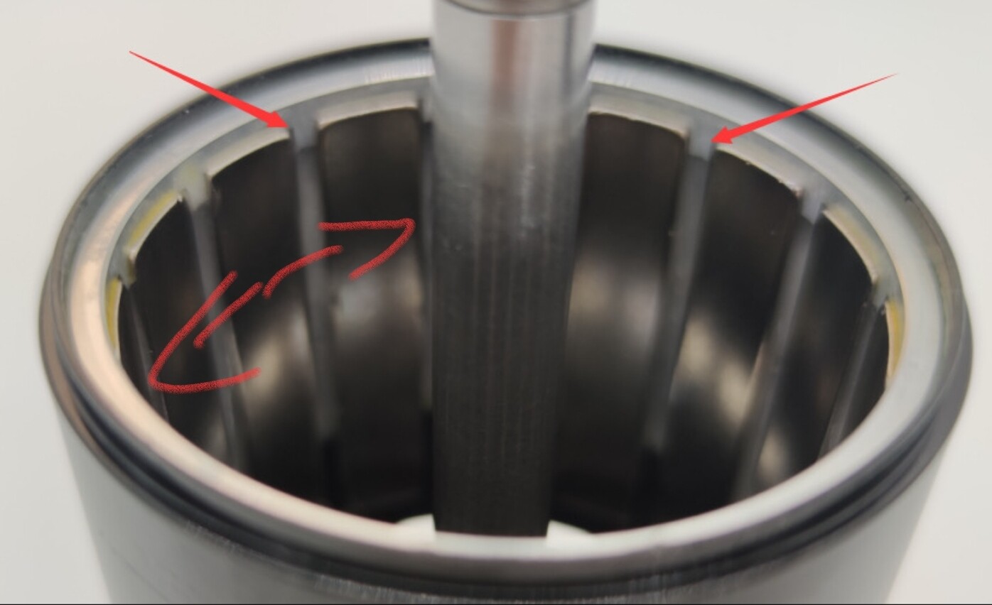

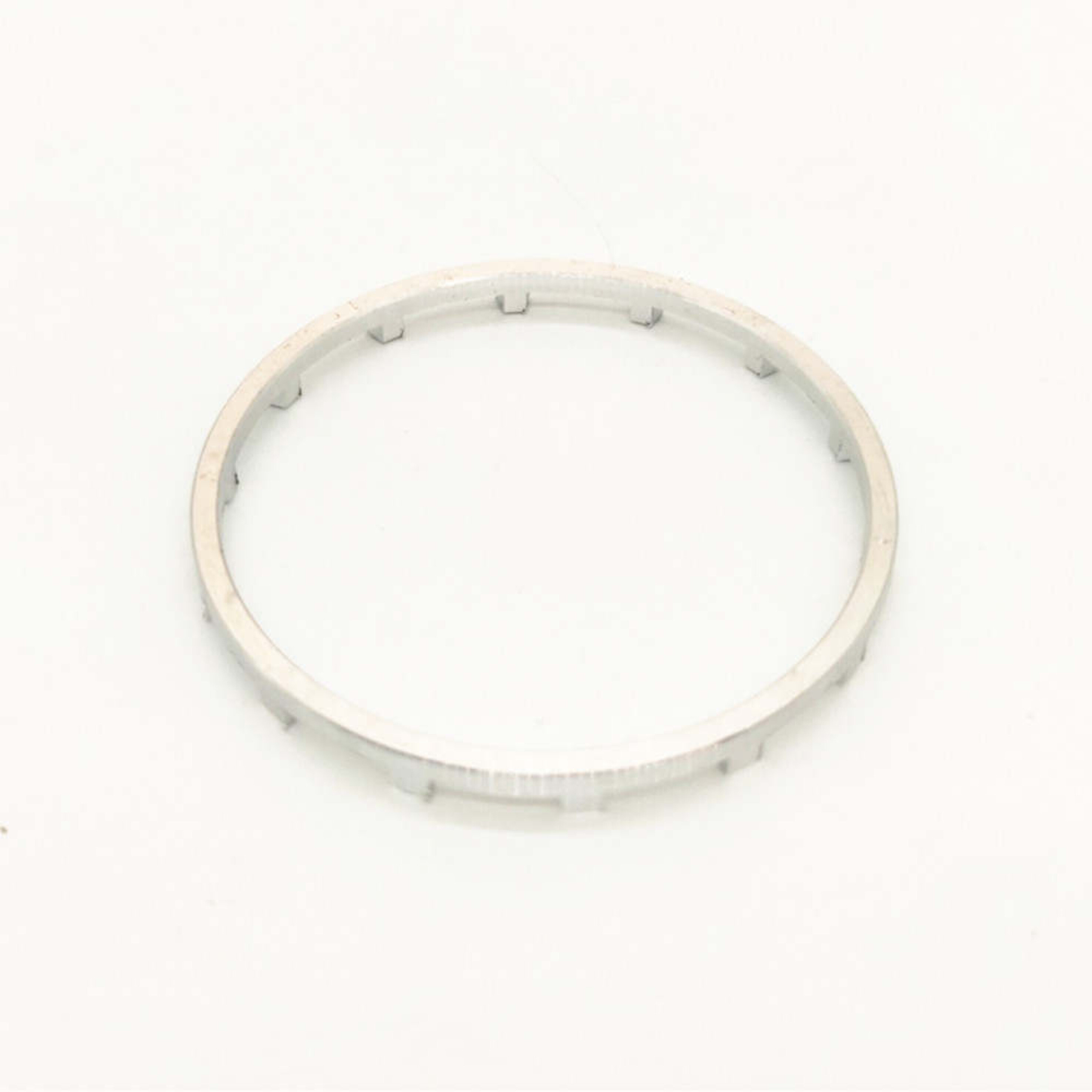

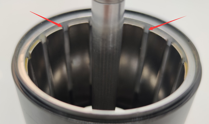

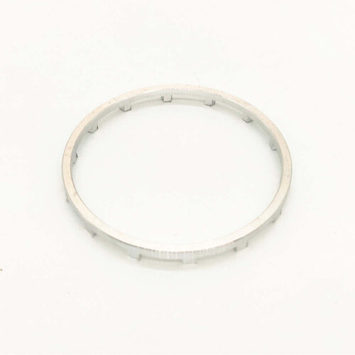

Retaining ring

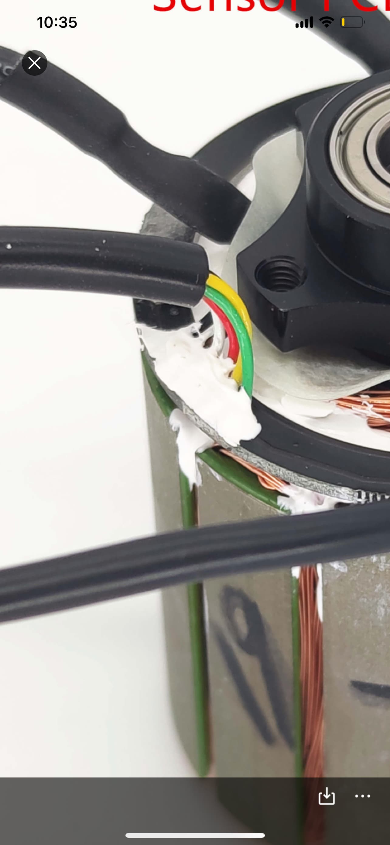

Sensor wires sleeved to the max @Andy87

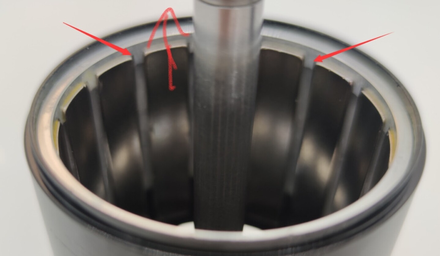

Ive never understood this piece. Is it to keep the magnets from sliding out this way?
Or from breaking side to side this way?
The retaining ring does make sure that the magnets aligned properly parallel to each other and as well help preventing movement in sideways and upwards direction.
Can confirm. I’ve had older TB motors without the retaining ring where the magnets were held on with adhesive and not epoxy. Overtime one of the magnets shifted so it was crooked and the motor made a weird electronic noise at certain RPMs. Those retaining rings along with epoxy to prevent the magnets from moving towards the stator are a big upgrade for any motor.
If done properly, yes.
My old TB Motors also had the retaining rings but each ring came loose after 5km. Needed to send them back to the US.
Unlucky batch maybe.
