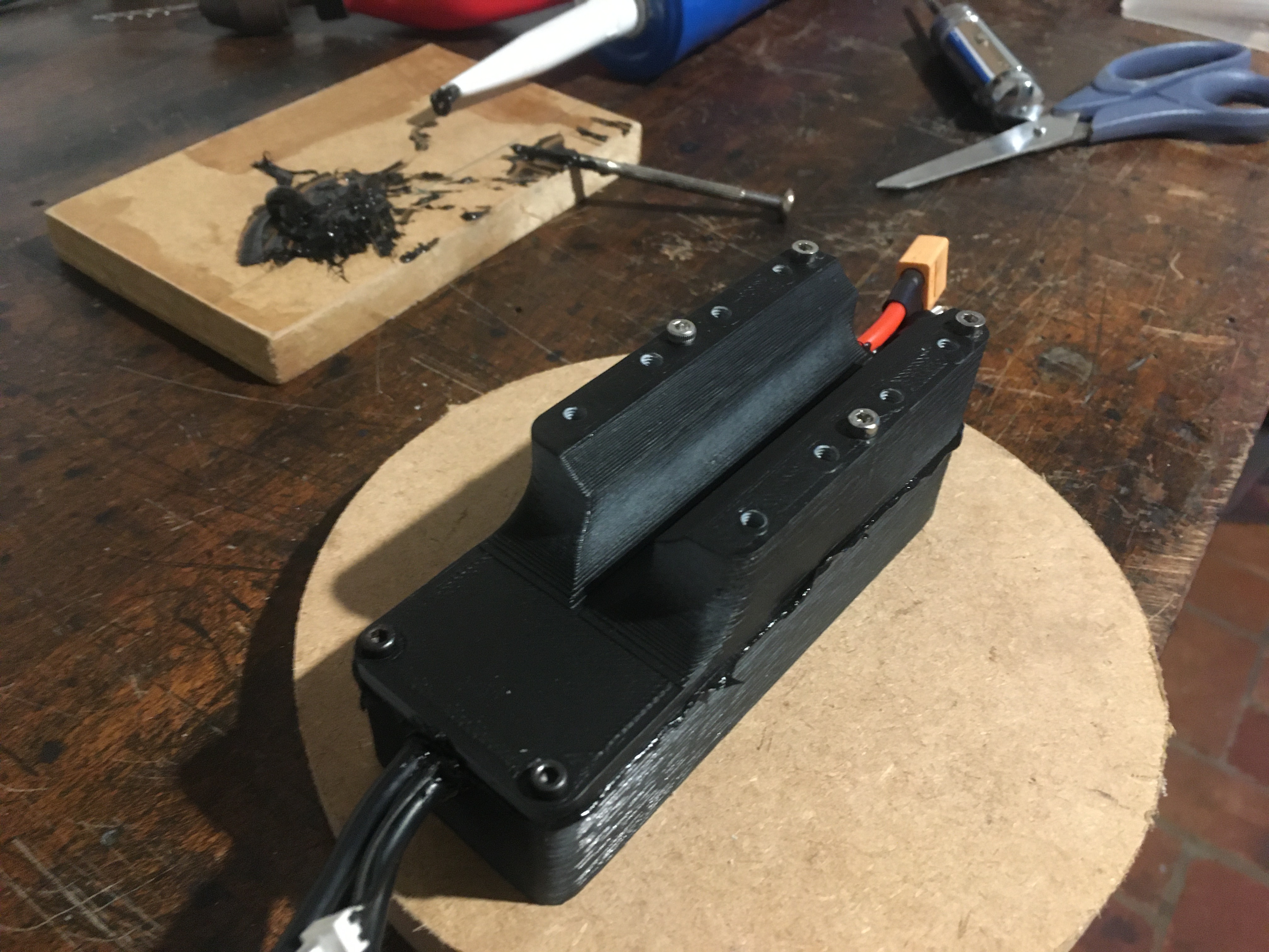

Everything sealed up, hopping no more problems appear, and a nice squeeze all around
Also the battery is almost done, and I found this bag with a quick disconnect that fits the battery perfectly

And with the bag, surprisingly stealthy. The mount could probably almost be disguised as a water bottle bracket if you needed to…

The water bottle idea is really nice, even better than the bag. The first version the plan was to make a water bottle lookalike to house everything, VESC and all, but I completely forgot now that only the battery will be removable

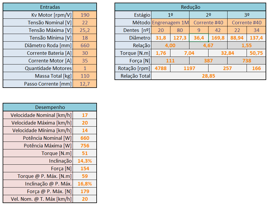

Another concept I’ve been working on is to have just a single motor drive the chainring, climbing would be improved a lot, of the highest gear we are looking at 20 km/h, versus 47 km/h of the current setup, but the biggest advantage is being able to spinup the motor and get out of the crap efficiency zone of the VESC
The idea is to use the gears that had been bought for my gear drive as a first stage
The gearing would be 20/80 on gears, 9/42 on chain, and the normal bike gearing, the tallest being 22/34
Maximum theoretical climbing is 17% at the same 35 A motor current as the friction drive, this can be increased if needed
Based on the drawing, are you sacrificing the large chainring as a drive, and only pedaling the mid and low gears? (I also thought sprockets bottomed out at 11, but hadn’t looked into non-bike 0.5" pitch sprockets)

Exactly, I have a 9 teeth one that came with a brushed motor I bought a long time ago

For speed, any thoughts about increasing your s count again? At 230 kv, you can support a full 10s sliding in just below the ~60k erpm limit to make up for the lower gearing, no comment about how much heat the motor would be subjected to at those volts/speeds though… Might be worth a trial even with the unbalanced pack to see how it fares going almost 70% faster.

For this setup it doesn’t make much sense, only thing it would do is decrease the battery current, at full charge the crank is already spinning at 240 rpm, way above a normal cadence, to take advantage of increasing the voltage the gearing would have to be way more aggressive, probably another stage to add
