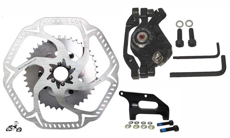

Worst case if regen isn’t enough for the Mtn Bike trails im after, then I’ll make an adaptor to have the disk brake next to the rear sprocket like this : https://www.bicycledesigner.com/images/zMotorized-Rear-Disc-Brake-Kit-with-caliper.jpg
This is exactly my initial idea, I’ve even bought a 26 teeth sprocket, but to maximize torque I would have to go 3 stage gearing or use a really big pulley on the first stage
Or fit bigger rotors to have more than 26 teeth on the wheel
If it’s sprocket diameter you’re concerned about, Instead of the standard #40, you could opt for a smaller pitch like a #25 or something that’d get you your ratio without interfering with the caliper boss. I think a go cart’s #219 could work?
That’s a good idea, just have to check in the smaller chain can take the load

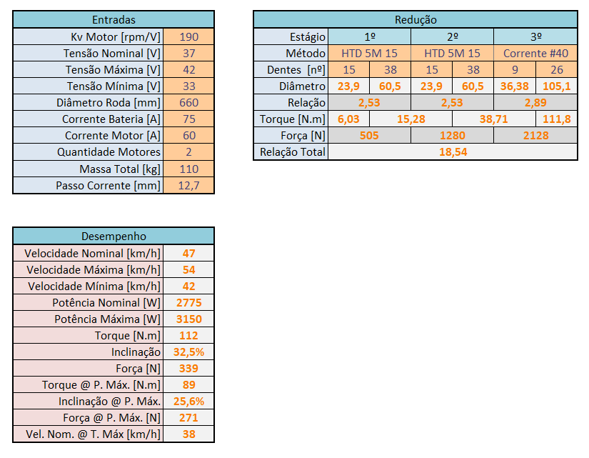

So I made an spreadsheet to calculate the performance, and more important, size the components and make sure they can take the load
The initial plan of doing 3 stage is not looking good, it would mean going 25 mm wide on the belts for the second stage, so the drive train would start to get bulky and complex
It’s in portuguese since I didn’t think to share here first, if anyone want to play I can translate it
For two stage it looks better, a standard #40 bike chain can take the load with no problem. I would have a pretty big chain ring on the rear wheel, but no problem. First I need to measure on my bike the minimum teeth number that clears the rear caliper to determine the first stage gearing
