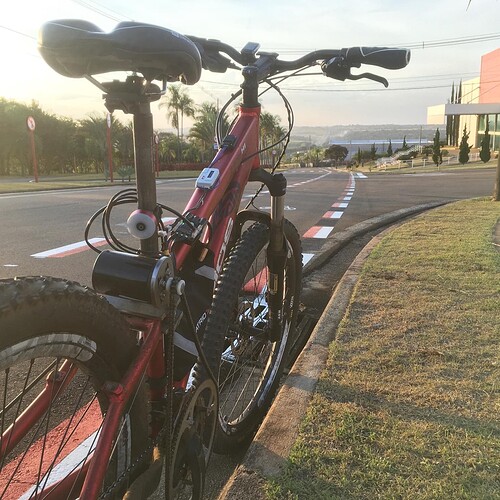

Discovered a fatal flaw, it you ride on the right (wrong) type of mud, it starts building up on the motor, and since the motor is hot, it dry fast and become really hard, up to a point everything starts vibrating, if not cleaned regularly I fear it might snap the motor or pop the tire
Some parts I was having to stop every 500 m
You could attach a scraping thingy on the mount?
Good idea, will see how I can mount it
Also that motor isnā€™t exactly sealed, be mindful of rocks and whatnot making it into the stator and scratching or cracking everything. I use thin metal mesh that I can bend around contours.
Iā€™m keeping an eye on it, this motor already have a lot of miles on it from my previous boards, and still going strong
Carry on then brother.
The bike is doing great apart from the minor problems already described

For the next version I will do the motor directly geared to the pedals using a #25 chain, gearing will probably be around 10:1 using a 9T and 90T sprockets, chain is on mail, I want to measure it first to be sure, all sprockets will be laser cut stainless
I want the bike bike working so I can get back to riding far, since I donā€™t commute right now and barely have places to go, none to be exactly due to corona, all will be bolted to the frame, the battery will be house in the triangle with a 3D printed and stainless combo enclosure, with room to the FSESC and this time space to play around if I want to add more things to the bike

Guess I never updated here and completely forgot
The above setup worked reasonably well
But it has its problems and itā€™s not reliable
The main issue is that the the crank shaft isnā€™t rigid enough, so your chain tension changes as you pedal, and there isnā€™t a sweet spot or itā€™s tight enough to not skip but still loose enough to not have a ton of drag and too much tensions which will break the chain and motor
So the solution is to make a spring loaded tensioner, didnā€™t start yet because I still havenā€™t found a good way to do it
But first step was to replace the motor pinion, the laser cut ones worked but again not good enough, specially since I needed to make some 3D printed spacers to lock it in place, and that cracks way to easy
Got this comercial pinion which had a 6 mm hole, had to drill it and surprisingly it came out perfectly centered with a jig and tons of double and triple checking before drilling
So, I have a plan, now letā€™s print the plan again because I screwed up the first time since my laziness prevented me from going upstairs to get my calipers to measure the tube, and instead I used a ruler to do it, which went totally wrong
