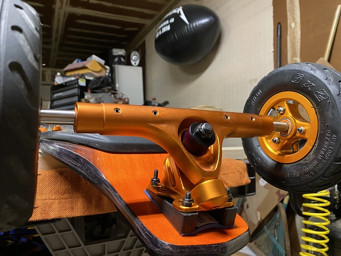

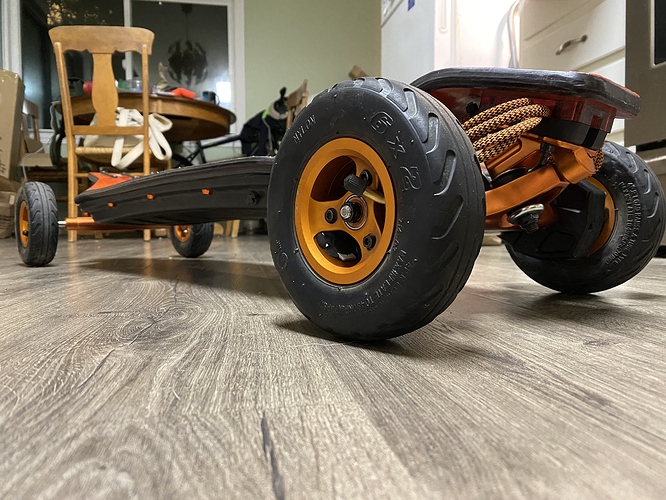

Skid Mark v2 being commissioned!
Changes:
Precision Kahua Trucks
MK2 Avio gear drives w/ 3.3 Ratio (previous was 3.75)
Dewedged front down to 50° final angle
Dewedged rear down to 30° final angle
Balanced wheels
Old:
New:

where’d you get the precision kahua trucks?? :eyes:
love the orange also! :heart_eyes:
Just send @haggyboard.timo your social security number and a blank check :+1:
does your wire sleeving you used come in blue? never seen one that clean and want to try and replicate it. also what gasket did you use out of the enclosure?
It’s probably available in blue as well, I can’t remember. The rubber gasket is the option @eBoosted offers when purchasing one of his enclosures.
The Kahua baseplate comes with 15mm height boardside bushings and 13mm height roadside bushings.
Riptide StreetSeries/Longboard combos are the same 28mm total.
I’m running front: SS Barrel/Cannon rear: SS Barrel/Magnum. The locknut just goes on all the way right at the start of the bushings’s adjustability
