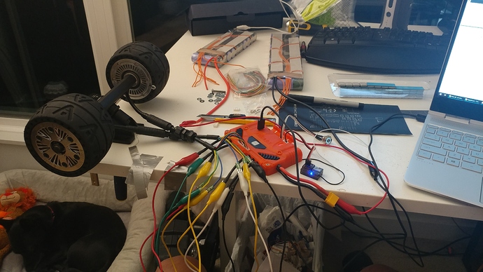

I’ve done 43 mph on bergs and they feel great. Vibration from the rear is a small issue though, just as you can feel on the board when you run the wheels on the bench. I’ve ordered some wheel weights Im waiting on, hopefully I’ll be able to balance the wheels with them.

Haven’t read that much on balancing tbh. I figured I’ll just place the weights (probably counter to the valve) and try to get some smooth free rolling. Since you can feel the vibrations while you run the motors on the bench, I figured it shouldn’t be too hard to find out if you’re going at it the right way

i was getting pretty significant vibrations until they got balanced out with wheel weights. had to use up to 10grams per wheel to balance them.
different wheels, but same idea.
with 6shooters, i just let it hang on the axle, and i could see the wheel settling at a specific point, so the bottom of wheel at that point would be heaviest. so place weights opposite of that, then hand spin to see if there’s less wobble. not scientific at all, but close enough.

one sure way to know whether it’s imbalanced is to just free spin it. if the wheel settles at a specific point every time, you know it’s imbalanced. when it’s balanced it’ll stop at any point.

This is what I did also, and it makes a big difference. I’m surprised basic balancing of pneumatics isn’t commonplace around here. Every pneumatic wheel/tire I have is imbalanced to some degree. Bergs, 6 shooters, MBS wheels, etc. It’s to be expected from such small wheels, and a chunky valve stem that isn’t compensated for. I’m suprised nobody has created a wheel that has an extra bit of material built into the rim on the opposite side of the valve stem to counter the imbalance. Then I would expect the wheels to have little to no imbalance. But for now, it’s effective to just use small stick on weights, and hand spinning to get it close to perfect. The slime probably can help too, but without weight balancing first, most or all of that slime is going to pool up in the tire on the side opposite the valve stem, and I’d really prefer it stays more evenly distributed inside the tire, for obvious reasons. I don’t go much over 30mph, but the balancing weights definitely help smooth out the ride.
