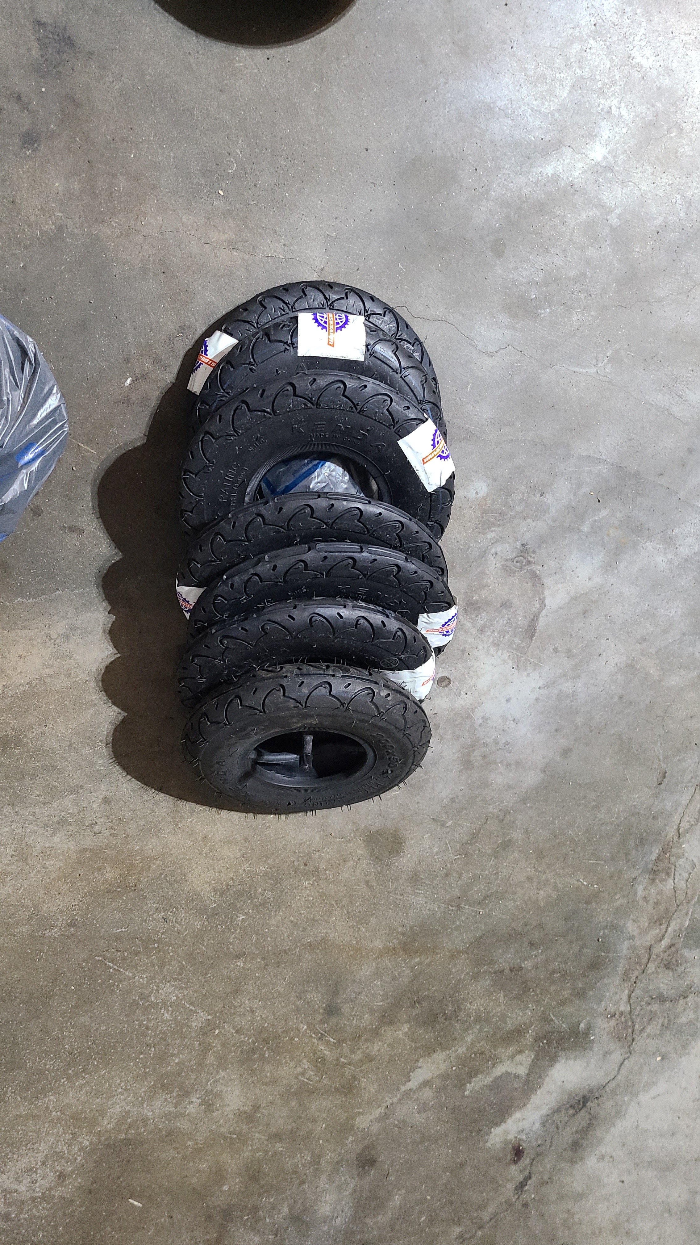

Anyone got a link for one of these “Razor Tires” that are the less crappy ones?
These are the ones @Venom121212 recommended.
branded clever that metroboard also sells and are the ones above that held up better. the the oringal ones in the post.
but they’ve gone unavailable. :frowning:
https://www.amazon.com/dp/B0021XPF9U/
@Venom121212 further recommended
https://www.aliexpress.com/item/32844085521.html

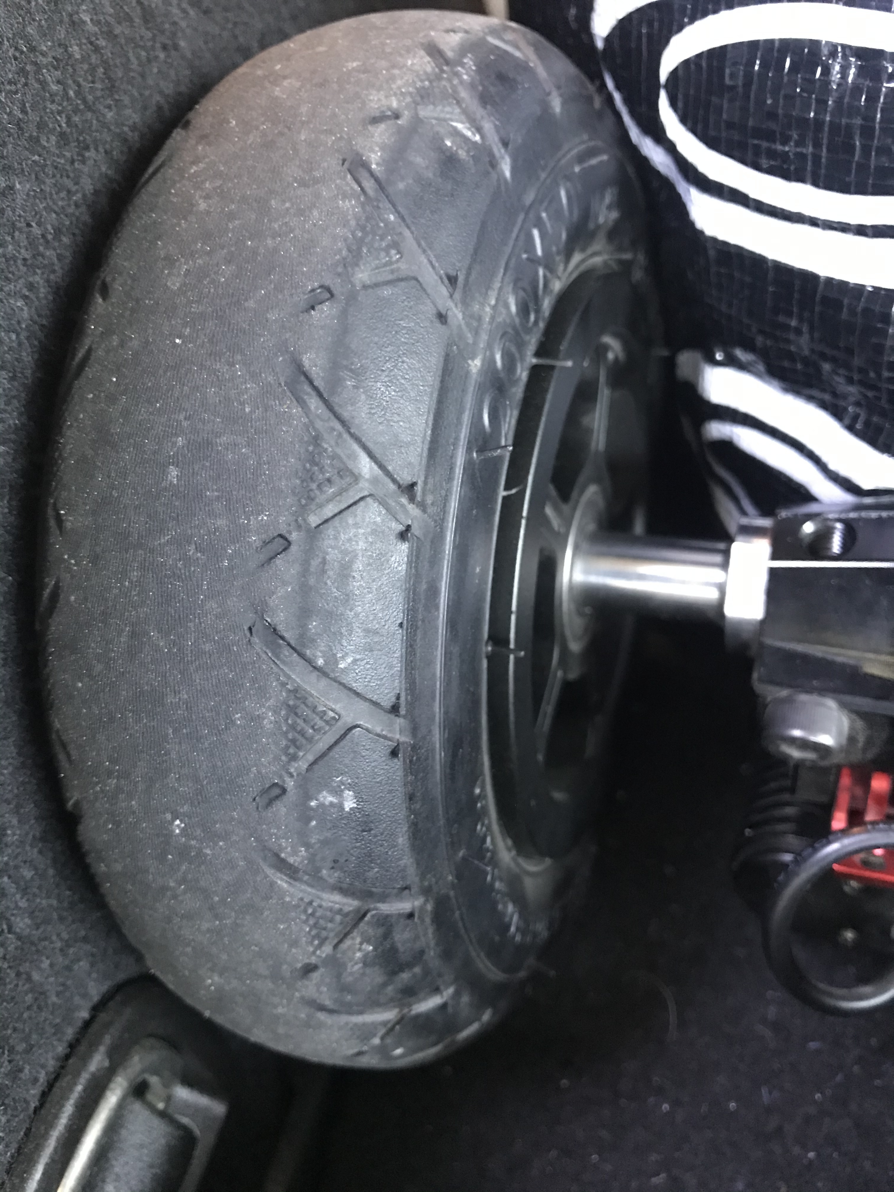

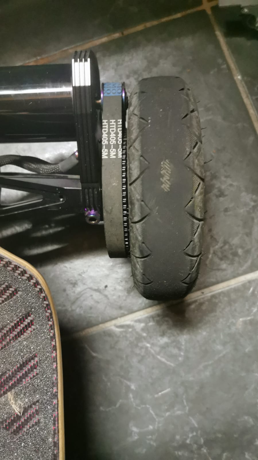

So this clever set. Has lasted 6 short course sessions and at least 5 group rides. Bald for the last 3 sessions. But still not showing threads.
This is a stark contrast to the original set in the post. Which looked exactly the same. This set lasted as long as my Kendas.
d00d, that looks like a great wear pattern, and width on that tire… it looks like it served you well!
did you notice in their lifespan a moment where they felt they gave way? or was the loss of performance new to old imperceptible?
I transferred these tires in their earlier pictures from stock MBS rockstar II rims to the nazaré with hellcats wide rims halfway through their life. so hard to make traction comparisons.
But, they’ve been pretty decent even when balding. and that is maybe due to the wider contact patch?
probably… i’m pretty impressed with the wear and contact patch… you must have your pressures dialed
do the fronts look appreciably better/worse? or do you rotate them?
fronts look the same at this point. i didn’t rotate them. i usually wear down the backs first by a fair bit didn’t notic that this time. but I think they reached “bald” first.
how weird… me too… the backs always seem to go away first
You obviously must be turning more aggressively
BTW… I really haven’t “felt” an appreciable performance loss on the metros from broken in to worn out, except at the very end… when they get sketch

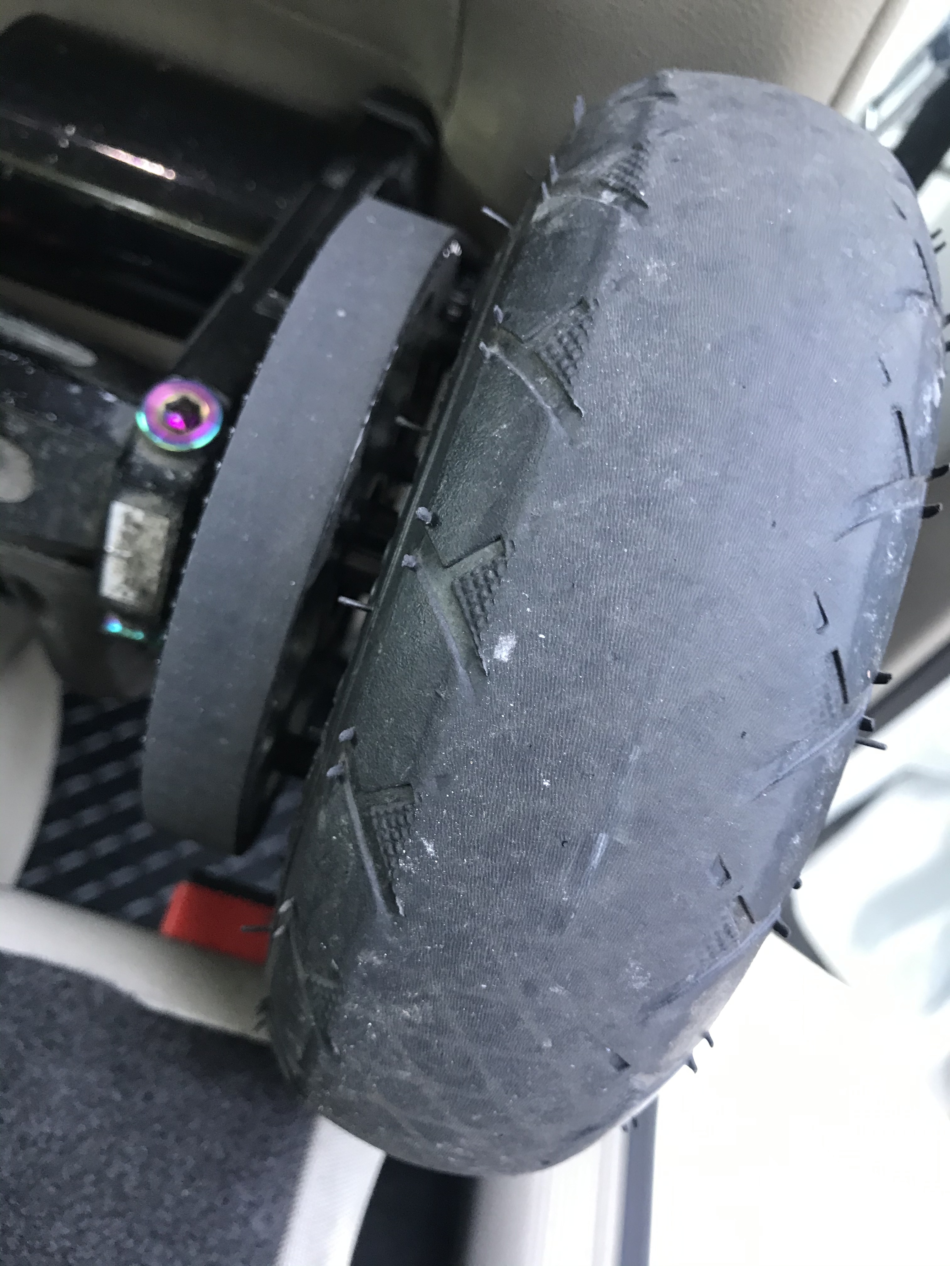

I got less than 500 kms out of the Clevers
I’m not going easy on them by any means but ffs! That’s a new set of rear tyres every 6 rides or so!
I was getting much better longevity & performance out of Evolve 7". Those and the Kenda 909’s seem to be much thicker at the contact patch. Even when the tread pattern has worn through, you’ve still got life left in them. When you’ve lost the tread on the Clevers, you’re on borrowed time.
