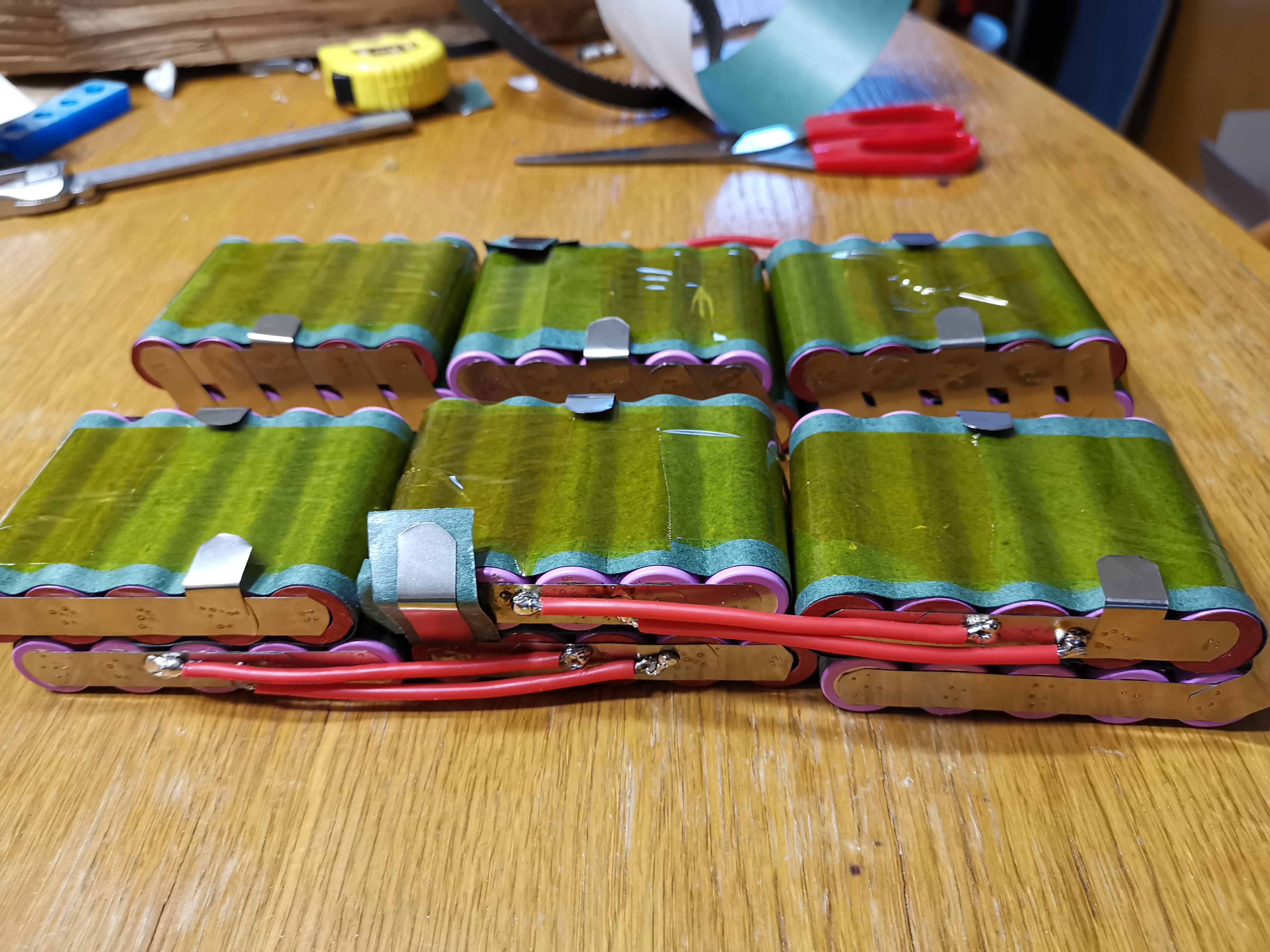

Enclosure is fibreglass and how would I know if the battery is flexible

@tinp123 Is it a flex battery
hand + battery
if bend
battery = flexible
if no bend
battery = no flexible

If the battery is super stiff, a meepo deck will be too flexible
Battery has some flex, because series connections are wires, but there is cardboard between rows, and cardboard won’t allow flex.

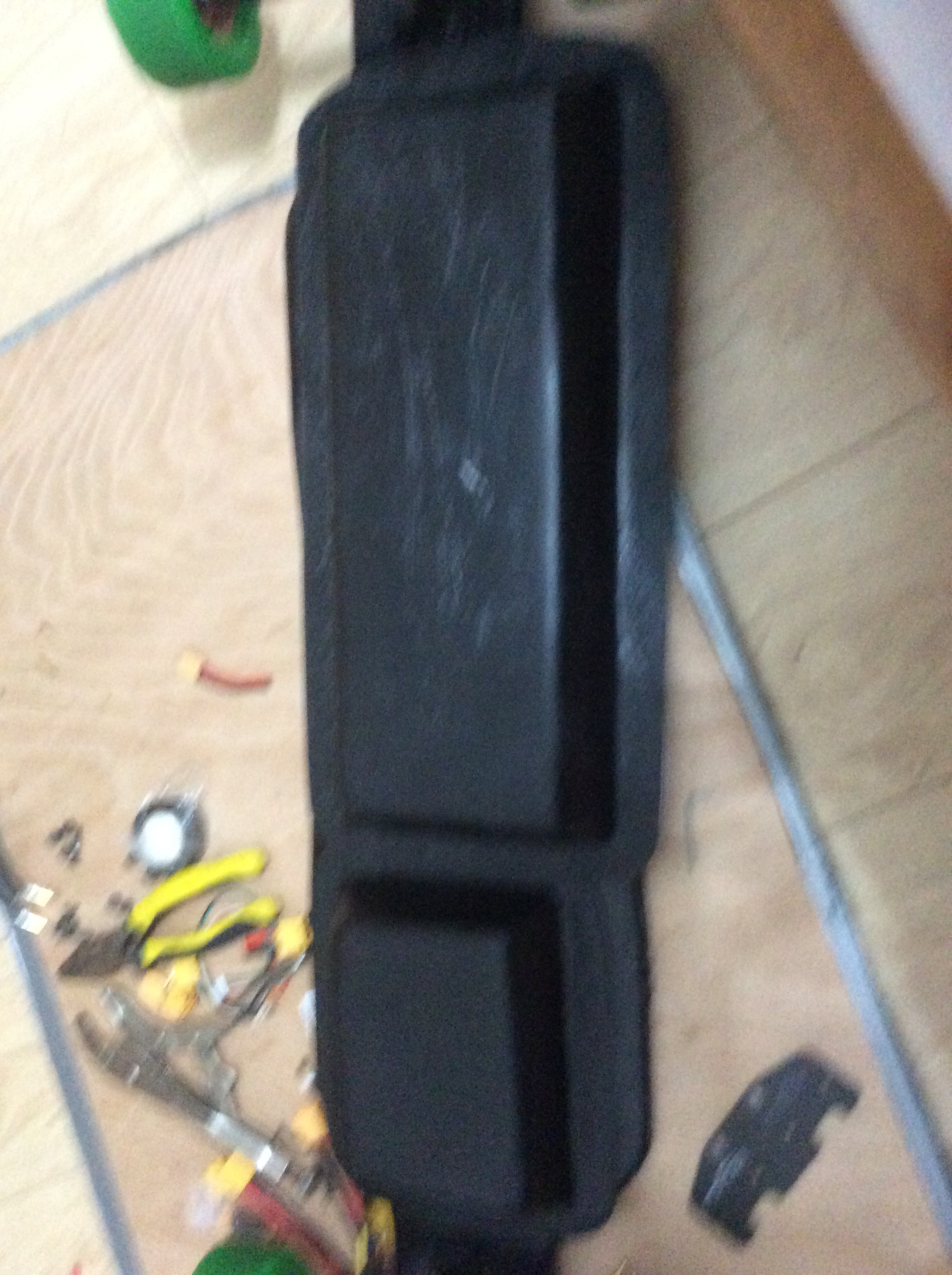

As I found this is what happens when I try fitting the enclosure on my deck
No space

This is what happens when a builder doesn’t do any research and just ask questions at random.
I thought there would be space for it as I was told battery is 40cm long however I see now that the enclosure is to big for it

Can you trim those enclosures down?
Skunk
June 12, 2019, 6:53pm
#17
It’s really hard to tell what’s going on in that picture
As in I could by an inch or two but what I am asking is would that battery still work if the deck has a slight flex
After trimming it down you would have around 5cm in the middle for flex to happen
Is that enough

The flex isn’t just going to automatically happen between the enclosures, the whole deck is still going to flex.
