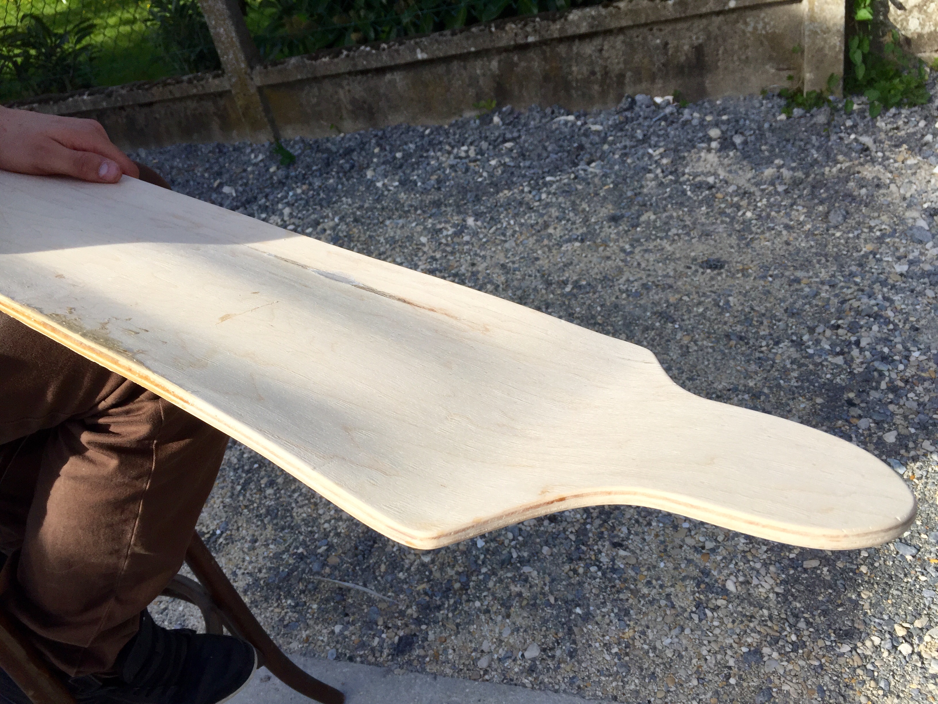

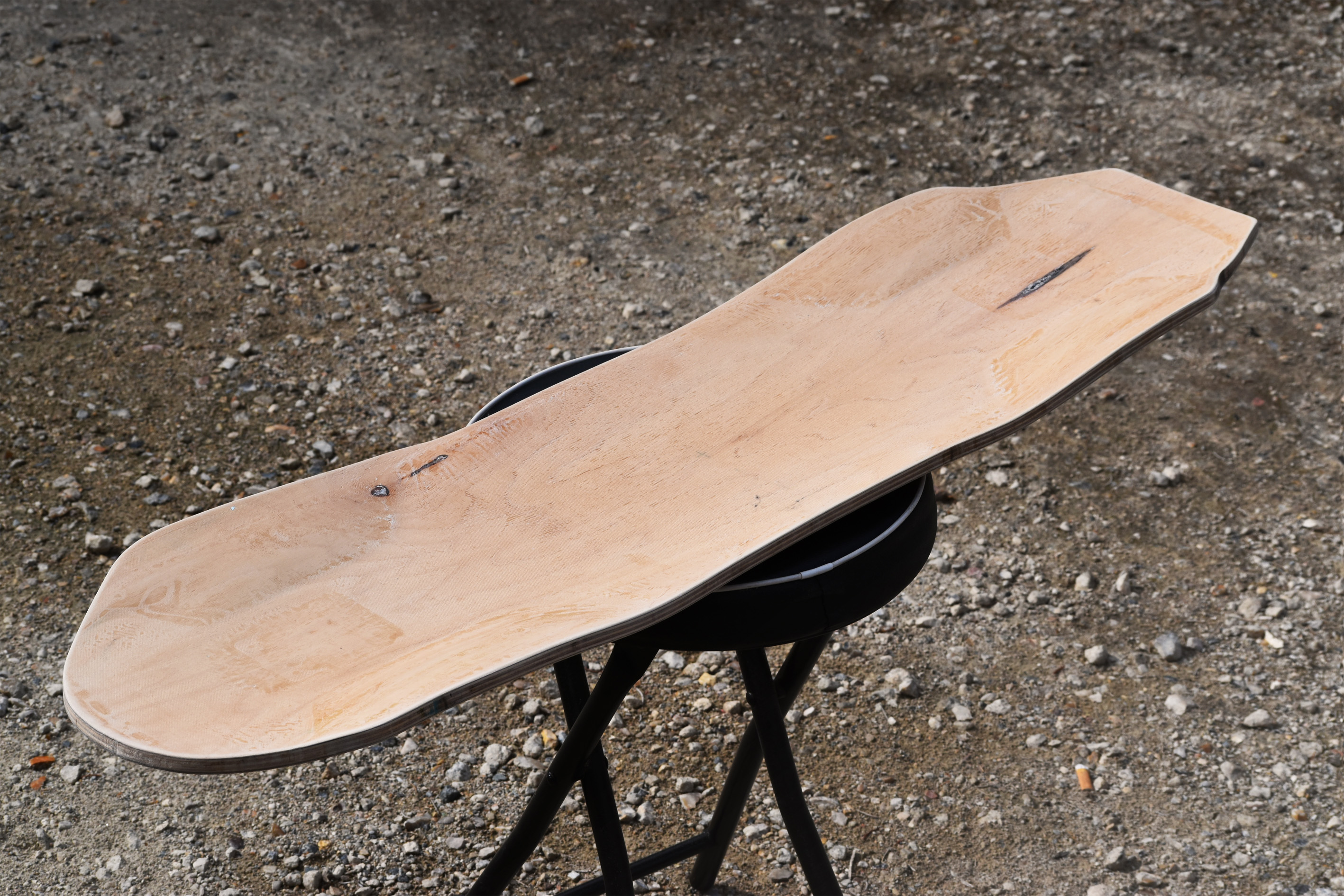

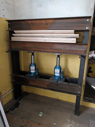

Show us ya deck press
Do you make the moulds yourself?
Elle sort d’où ta presse :joy:
Du même endroit que ma CNC, que mon tour et ma découpe laser :blush:

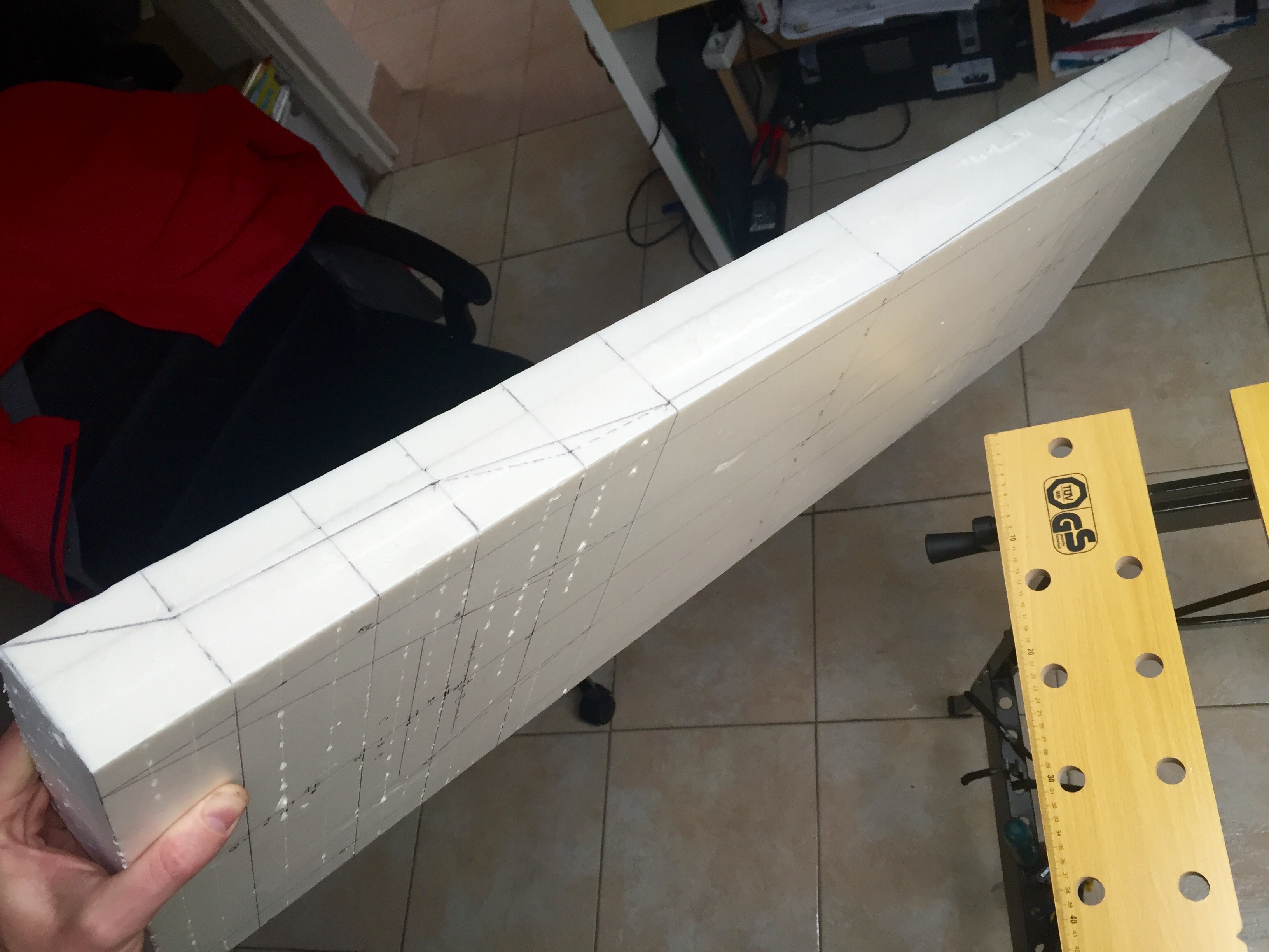

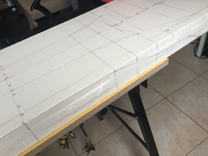

I have this thing.
Thats very similar to how I wanna make mine :ok_hand:

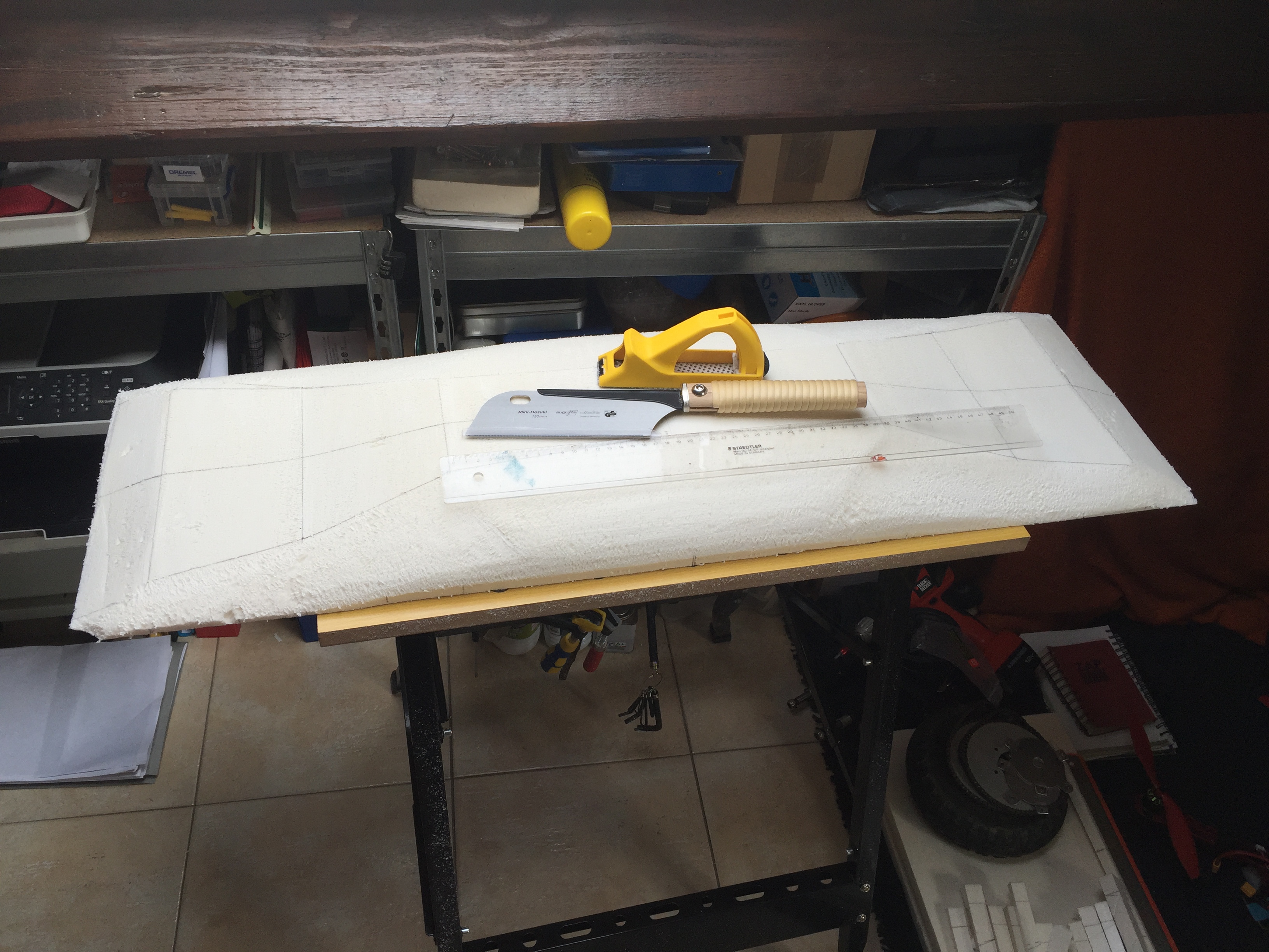

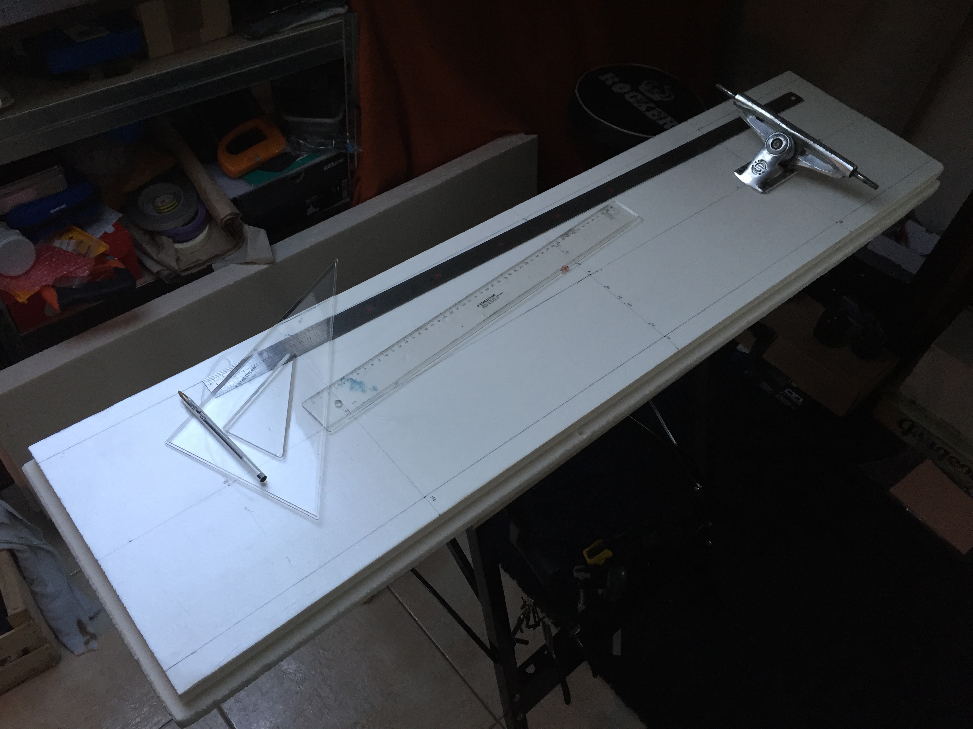

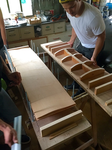

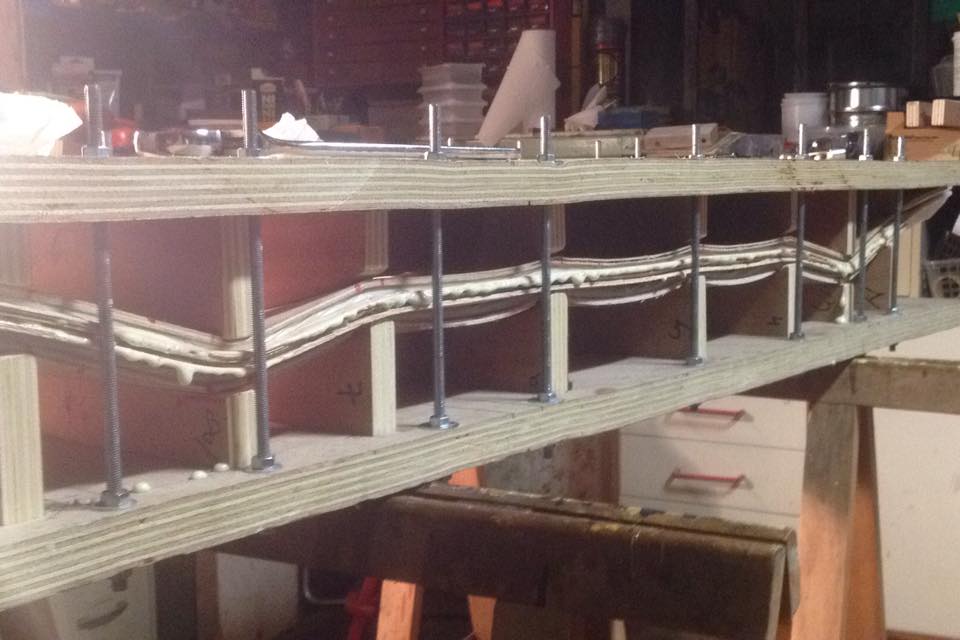

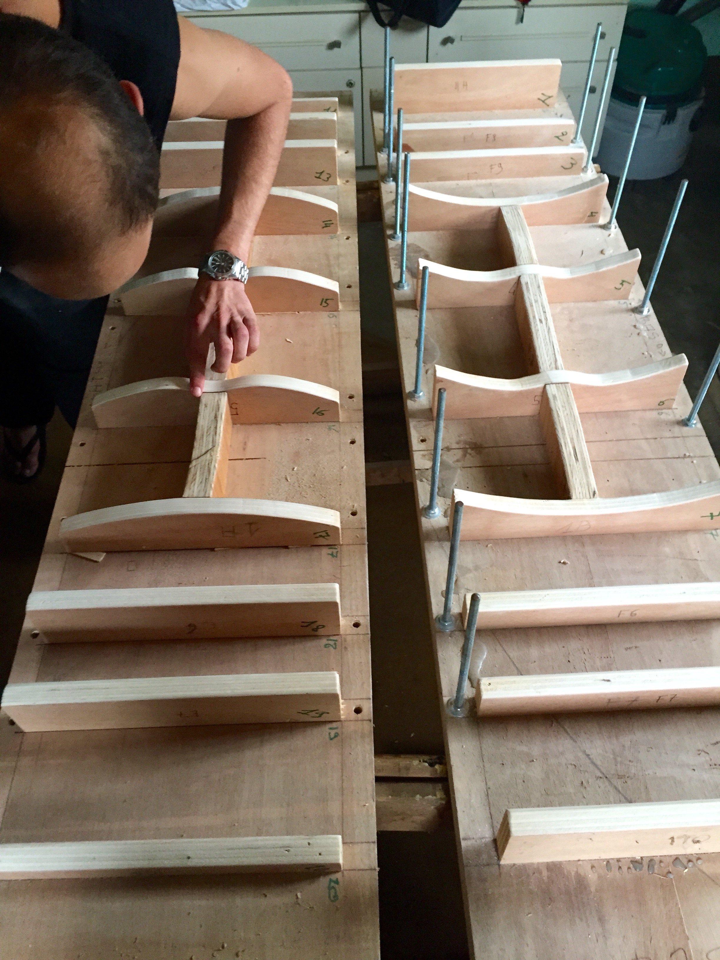

back in 2015… we tried it with friends :
Then I find the “roarockit” method easier for self production deck :

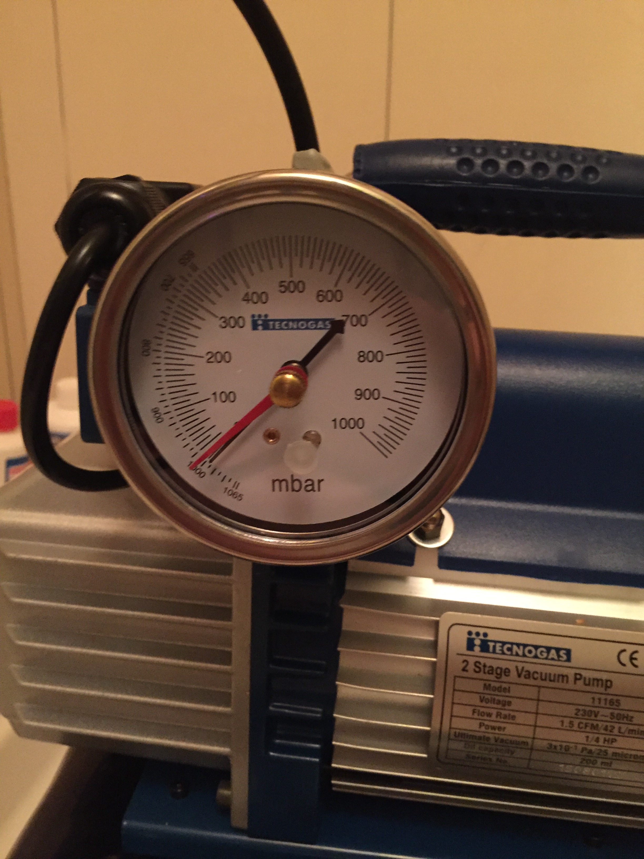

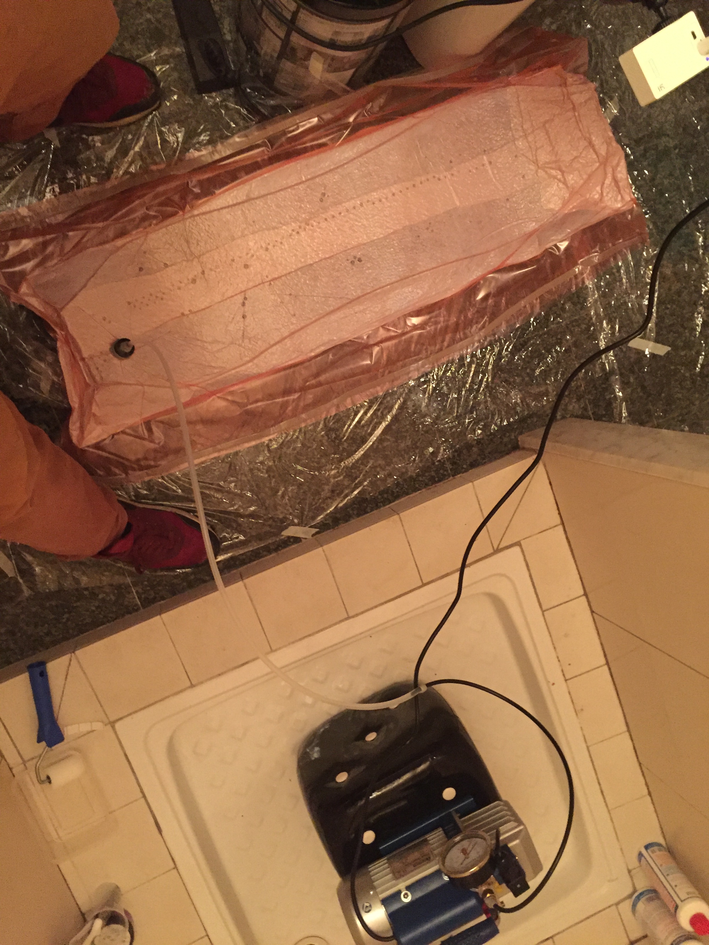

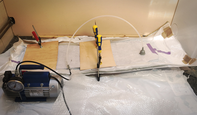

My deck press setup now :sweat_smile: :
Nice! Vacuum is better than my Rusty T-Rex (that is what I call it because of funny sound those bottle jacks makes when I drop them down. Just like from Jurasic Park movie :wink: ) I’ll try a vacuum and resin soon and se how it works for me.

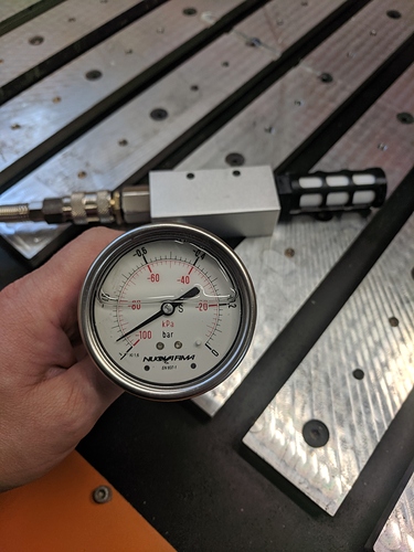

Is your bag setup reusable? And does that pump hold a pressure? I made my first attempt using similar method but had a leak that i couldn’t get rid of now I’m looking for a vacuum that holds a certain pressure
yes, by cutting one side when finished you can reuse the bag. Yes pretty strong.

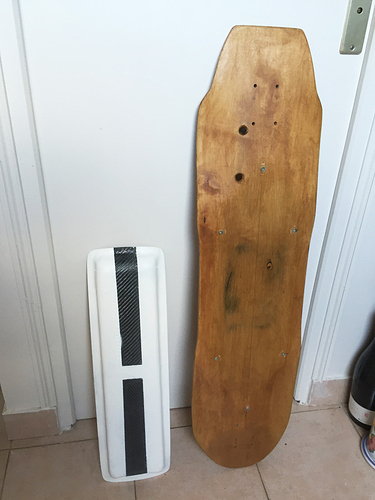

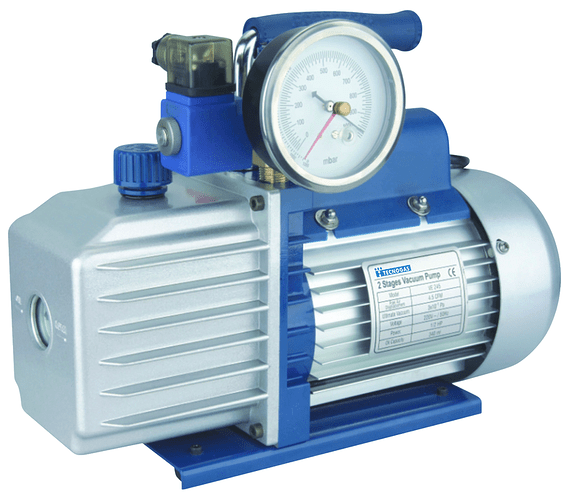

I use this one :
I should be able to find the box somewhere ^^ and take a picture if you need.
