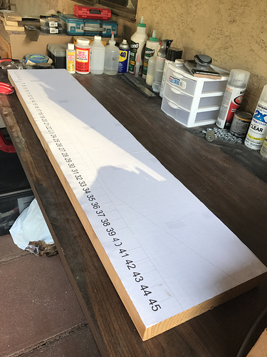

Ma man @257 press for his Komodo MTB decks (sort of MBS Pro 90 clones) from few years back…
Nice!
What was the cloth for?
I’ve often wondered if when making the mold like this, you need to accommodate the thickness of the deck as well? Or is the straight cut through good enough?
Gotta ask him. But my guess …probably to protect the wooden press from the dripping glue… who knows (??)

To my knowledge and understanding, which is limited, but I did look a little into it a bit ago, there is no need to compensate for an offset. If anything an offset would be harder to get consistent results with
