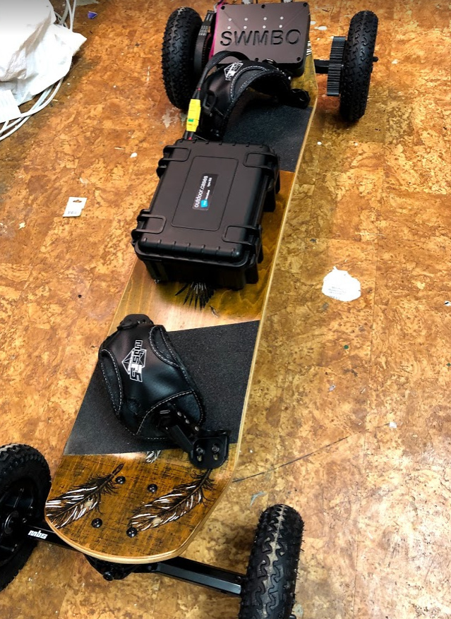

Things are moving along slowly, i now have most of the stuff assembled. I got the batterybox mounted, and soldered the serial connection for the batteries.
I also got the vesc box mounted, and finished version 0.9 of the box lid, still in pom.
I went with nice cable glands, i considered either epoxying the cables for water proofing or just use some sort of rubber gland. But in the end i went with what i know works.
It’s a tight fit in the vesc box, but it closes, barely
. Still waiting for threaded inserts to keep the lid closed, and 4mm bullet connectors to get the motors powered up.
Starting to look good! Carefull with those metal cable glands though, cover your phase wires in thick rubber or electrical tape in that part to make sure vibrations dont cut throught the insulation and short your leads.
Thanks, I’ll add an extra layer of heatshrink on the inside of the box, the outside is going to be protected by both heat shrink and some braided cable protection. The same stuff i used on the connection between battery and vesc box.
I’ve finally had a bit of progress again. I got the lid cnc’ed in alu. It looks awesome! And received the 4mm bullet connectors and wiring from @Anubis. Now i can hopefully complete the vesc box assembly and mounting while i wait for the motor mounts to be machined. But it’s getting close to finished!

So the build is finally ready for testing
. During final assembly I realized that my vesc enclosure was too small, so a new box had to be fabricated on the cnc. But really, the last few weeks has been all about the motor mounts.
The motor mount design changed a bit, I added tabs for a cross bar, and adjusted the shape just a bit. This is the final result.
Today has been all about getting all the wires done correctly, updating the focbox firmware, and slowly learning what is what in the vesc tool. If anybody has any tips for initial changes in the focbox setup I’m all ears. I only had time for a small trip around the block. But compared to my Evolve Gtr, it is insanely powerful
. Mission accomplished.
