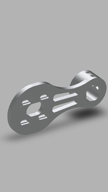

Im not MBS, but I would recommend 2 part tabletop epoxy (or any clear 2 part epoxy you got on hand). I dont think it really matters that much. This is shaping up to be a nice build, im really interested to see what you do with your motor mounts, especially these;
In fact, I like these so much that I think you should make the finished mounts this shade of pink.

For motor mounts I’m starting with the simple one without idler. I think the prototype needs to be a bit longer to allow for full adjustment of the idler pulley, and I would really like to keep this as simple and compact as possible. Hopefully gonna get them cnc machined next week.
