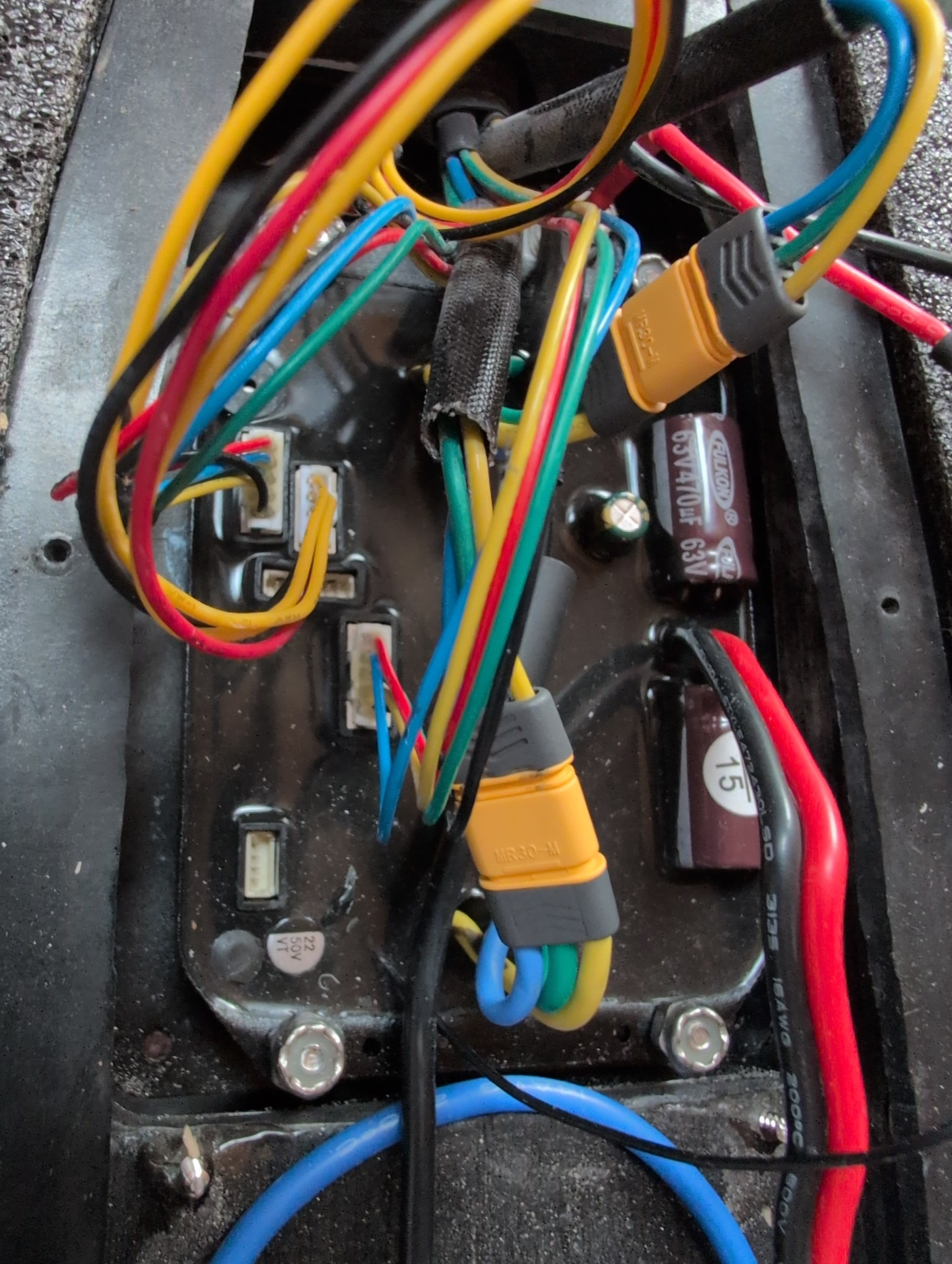

Installed a new Puiada ESC, much smoother acceleration and braking, also much stronger on both. I have to test it on hills but it may even be able to turn 120mm wheels. Unlike the old Lingyi it allows customizing the acceleration and braking curves. And it doesn’t slightly cut power when going over bumps like the Lingyi. Push to start is nice too.

The brakes on this ESC are certainly strong, and I like the parking brake feature too.
