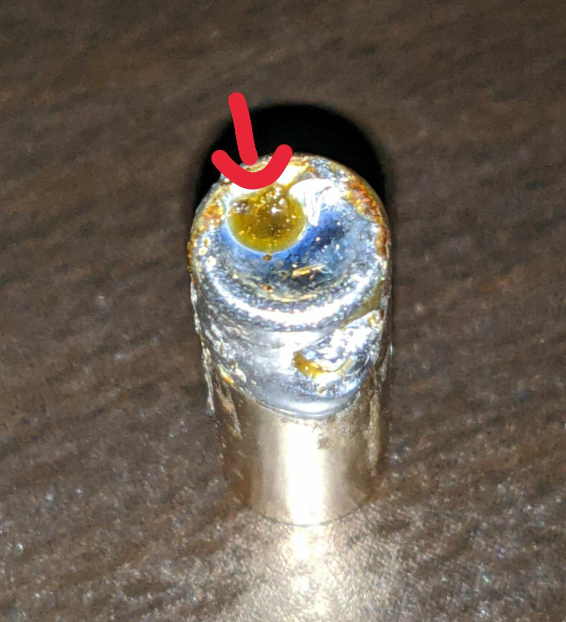

Mine has 2.5% but it seems way more than that.
I always have huge puddles of flux remaining like here on the test bullet
If ever you buy one, this one is really the best. You can change heat temperature (6 different levels) and also 2 speeds for air flow.
Yes mine does not have huge puddles like yours. There is noticeable residue that needs to be cleaned with isopropyl alcohol.
