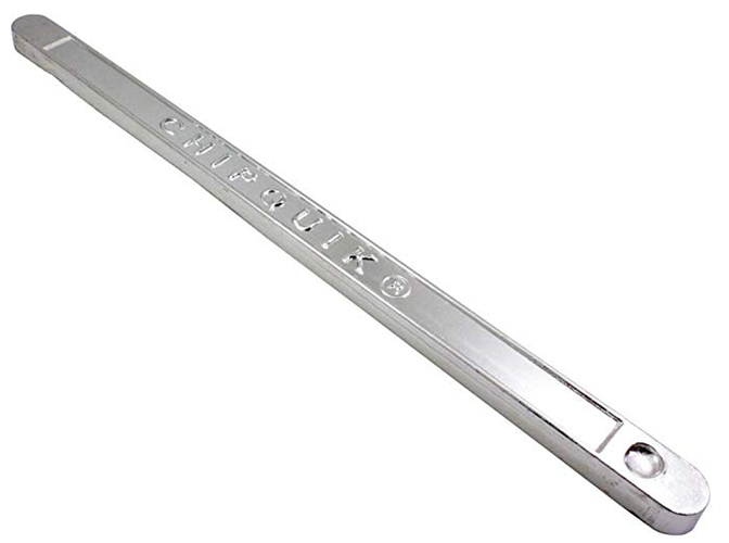

You use solder that’s sold as a big stick in 1 pound sizes. Flux the wire separately.
1lb solder bar
Read the Spec Amass state

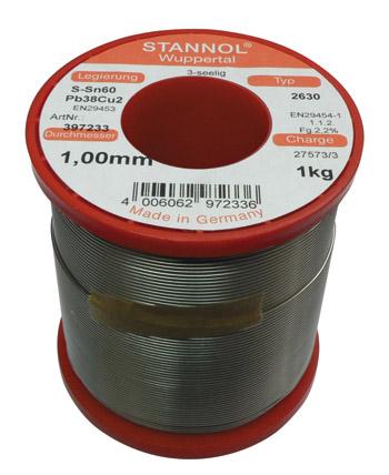

Does somebody know where i can get 60/40 solder in the EU?? Or can anyone recommend lead free more?
Only locally (just ask me) and some left stock online.

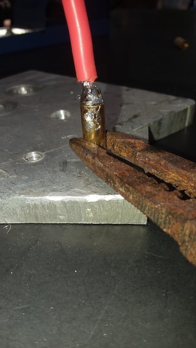

First bullet connector, it’s amazing how much a proper iron changes doing medium jobs.

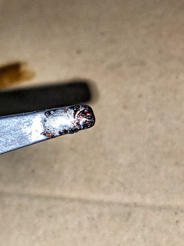

This is why i’m looking for new solder.
Mine is with way less flux smoke. Strange.
Also this
Do you have a damp(feucht) sponge to clean the tip?
sure. What you see is the flux burning up after applying solder. If i stick it in a wire ball to clean it its gone. Thats just from the Flux inside the solder.

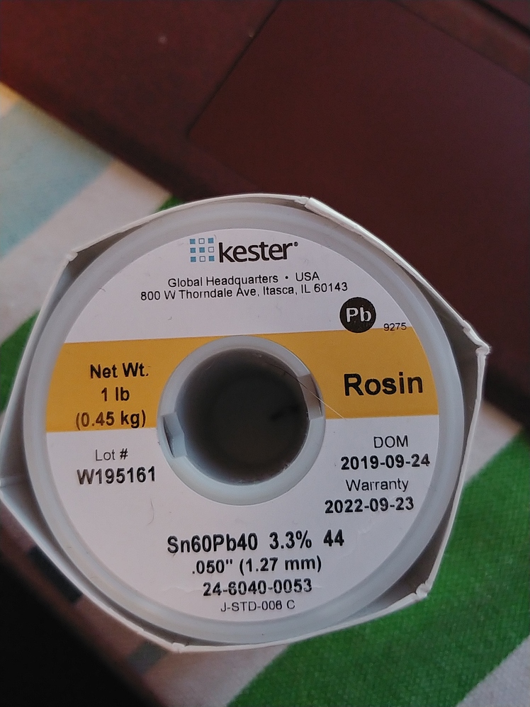

That depends on the flux percentage. Mine does that. I have kester 1.27mm 3.3% wire.
Most wires have have 1 to 2% of flux
