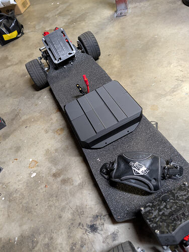

Anyone have experience with an easy access enclosure that opens by hand, no tools?
I’m picturing removable panels, so i̶f̶ when I’m late for a flight, I can quickly disconnect all my battery modules for TSA to fondle. This is also my first build, so quick access and regular inspection seems like a good idea even away from the airport
Top-mount pelican case enclosure is exactly what you’re looking for. Doesn’t get easier access than that. I dont even have a charge port or power button on Mistfall, because opening the box to plug/unplug stuff is so easy that it’s not worth having external ports.
Top mounted sounds amazing! Would totally do that on any other deck- this is a boardup folding deck though, so it’s gotta open from the bottom.
I got the nylon-like hard TPU mentioned above, hopefully I design something that doesnt vibrate apart lol!
