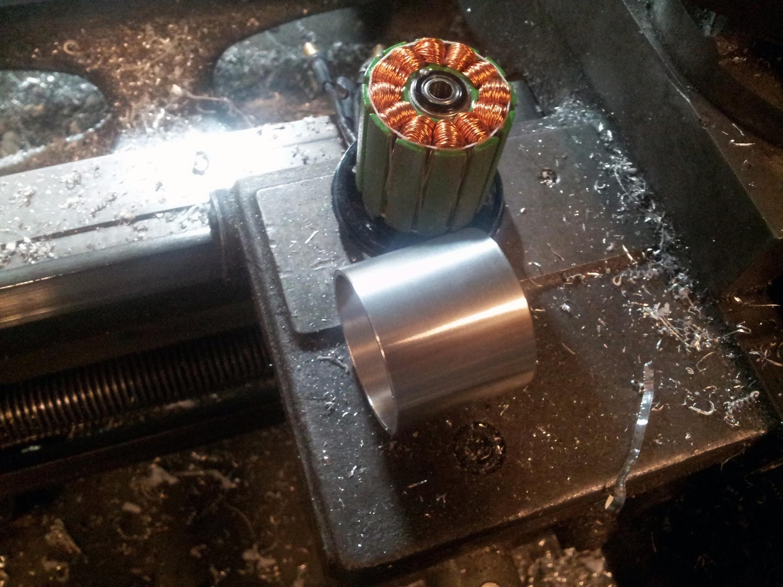

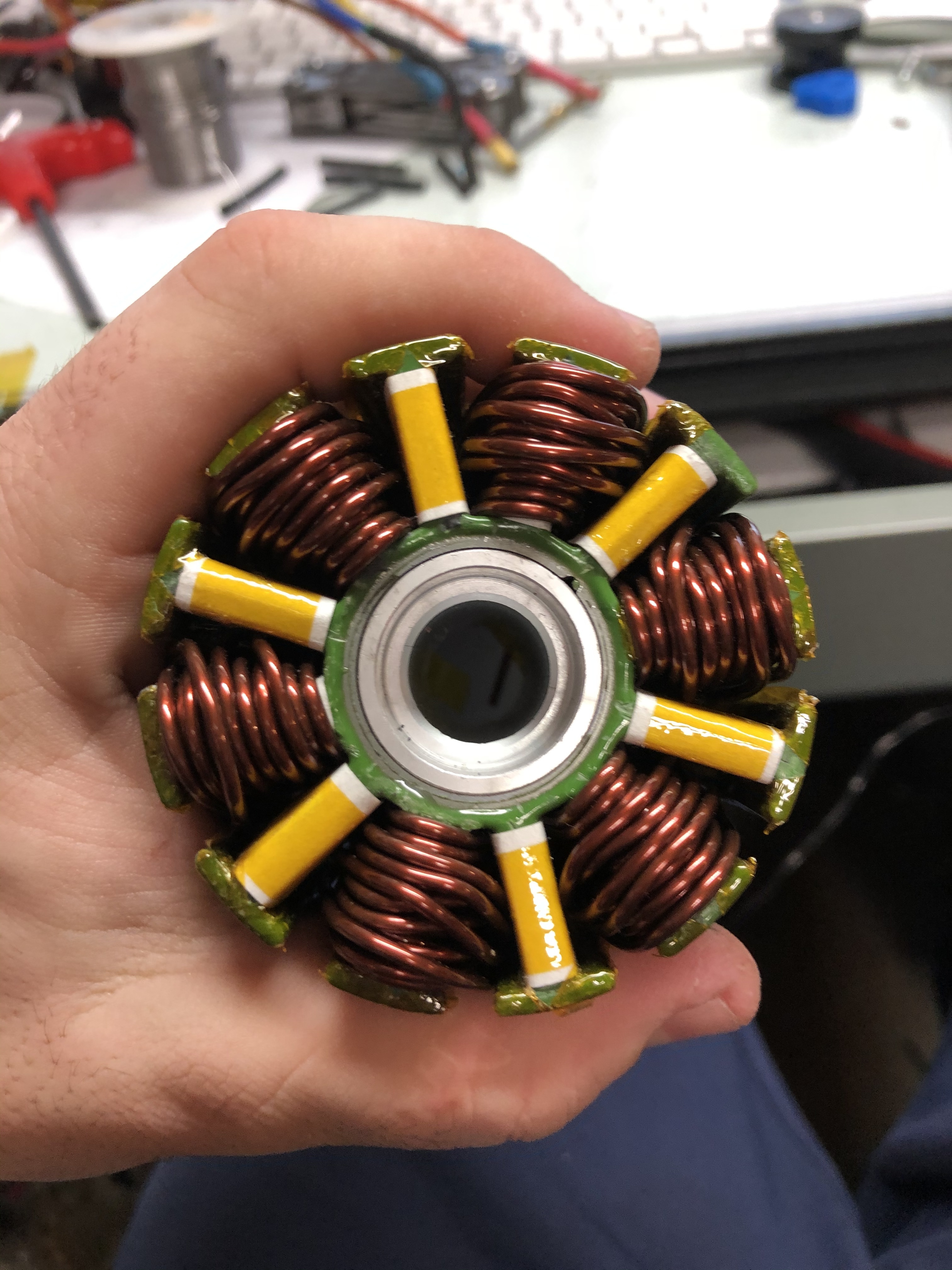

14 AWG single strand is a pain to wind. Here’s what it looks like on my 80100 motor stator. Not a perfect fill but definitely better them factory.

Not sure about it however just compare my wire and the one posted, I’m 18awg there.
Fills as dense as this is impossible to achieve with single strand. The wire is too stiff.

I think the answer here is, is single strand better? Probably, if you calculate the wire size perfectly, and you have the patience to sit there and carefully slide each wire through the slots, taking care to line each run perfectly and not cross the wires which will add massive air gaps, not working the copper too much and weakening it, etc etc.
