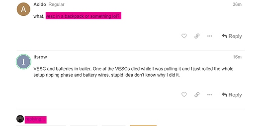

what, vesc in a backpack or something lol?
VESC and batteries in trailer. One of the VESCs died while I was pulling it and I just rolled the whole setup ripping phase and battery wires, stupid idea don’t know why I did it.
If they were shit tier 4.12s, are you sure it died due to the long phase wires?
