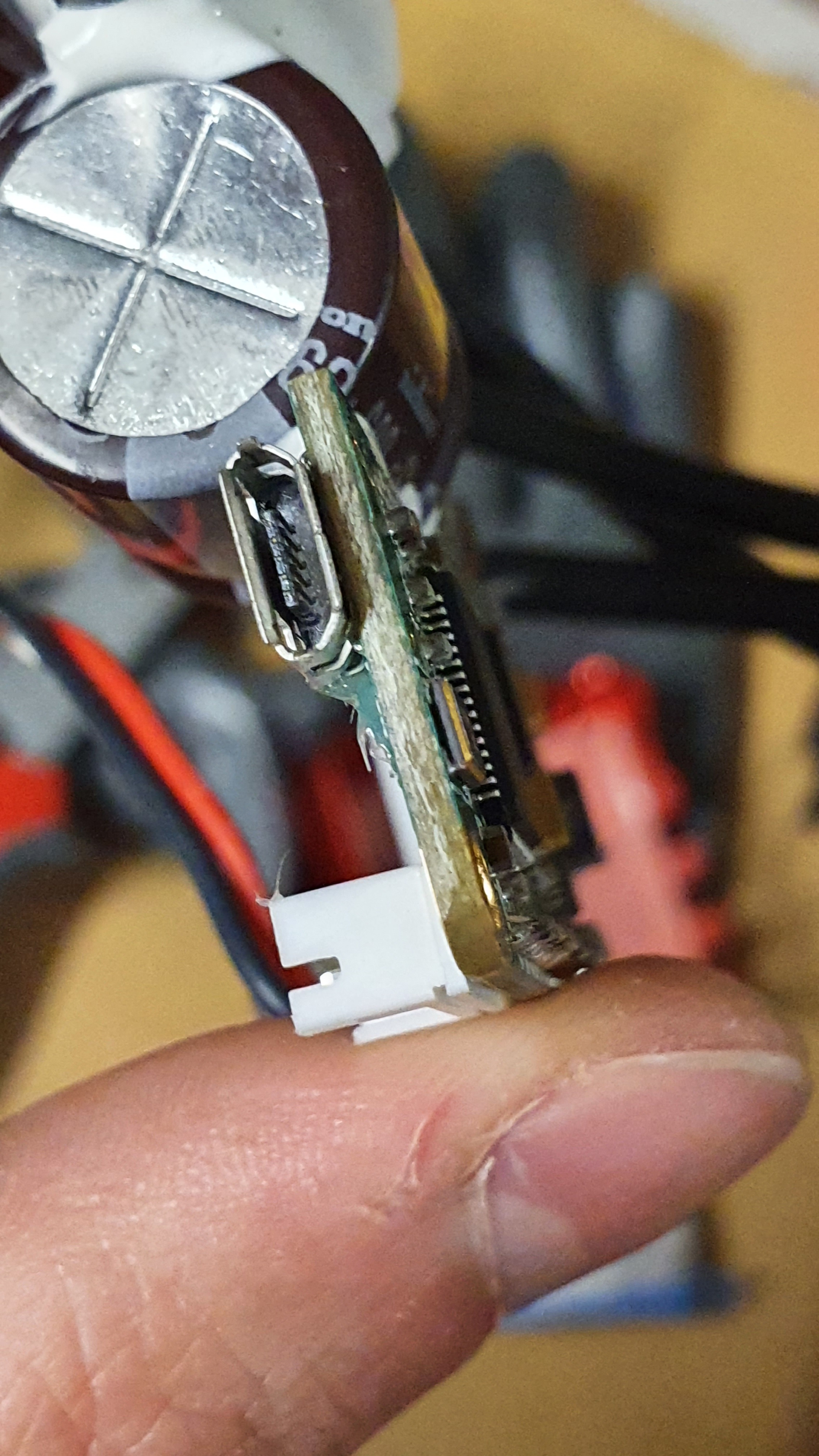

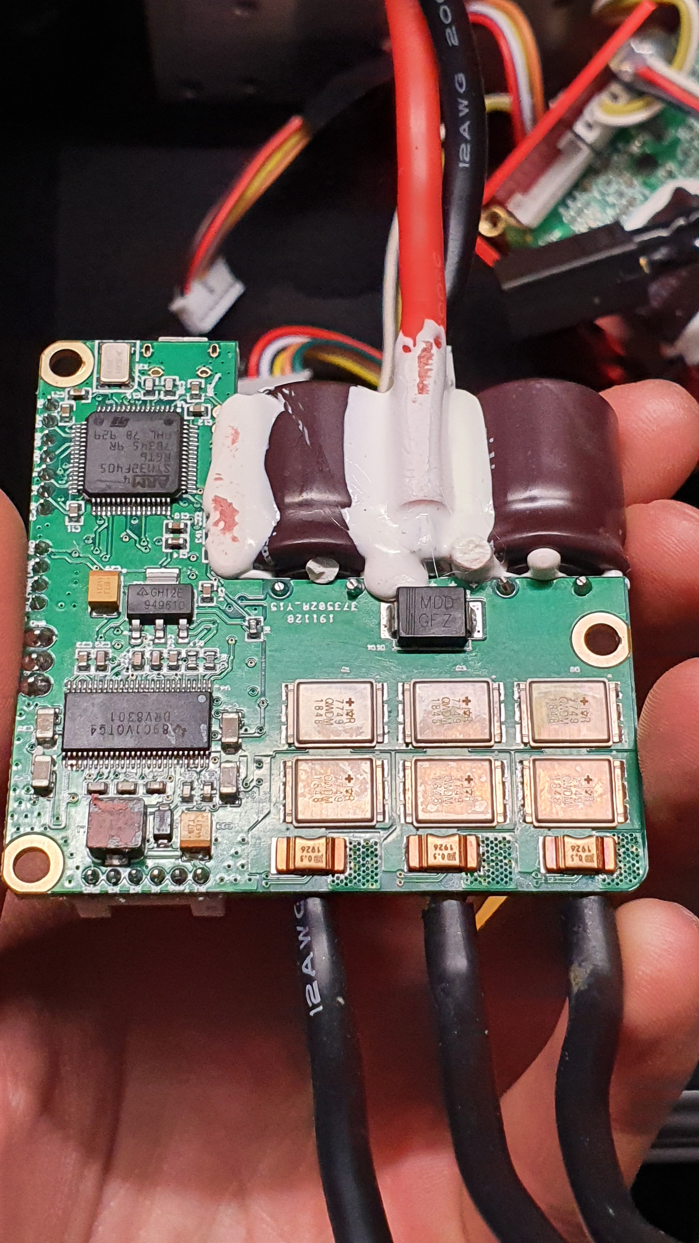

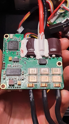

Took a closer look at the neoboxes today. Replacing the phase leads because the solder creeped up about 10mm into the wire making it very stiff at the connection points. And @kook mentioned some pins had significant stickout so I snipped them a bit shorter.

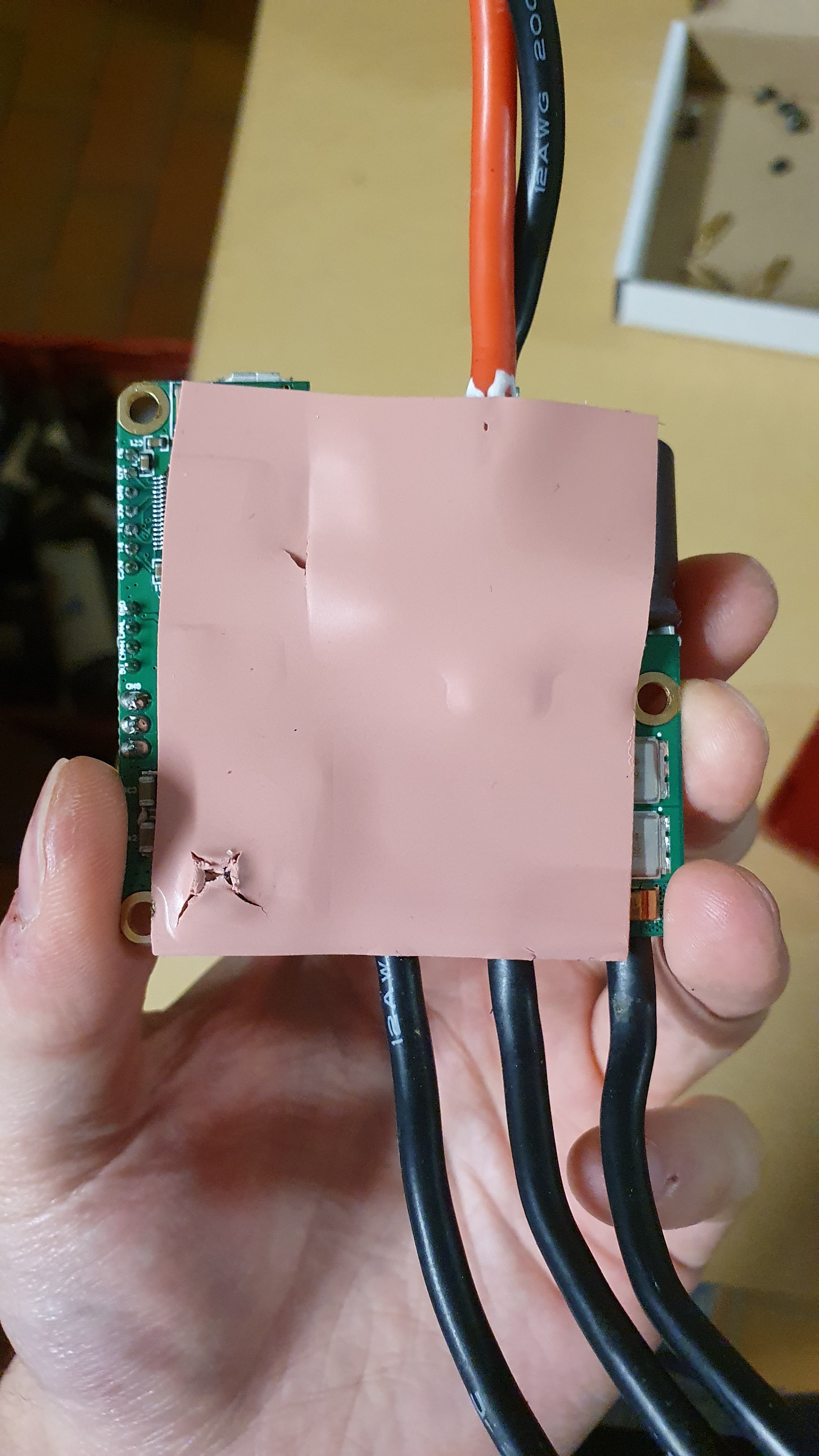

First thing I noticed was that the thermal pad on the PCB was not making contact with the case at all. @Sn4Pz mentioned this a while ago should have checked then. Anyway, I ended up cutting off a piece and doubling the pad up on the fets, now it should make contact, curious to see if the temps get lower, will probably do a ride today to find out.
Some pics:
Did the same thing. Snipped the pins shorter and put an extra layer of Thermal pad on the fets. Not the one from the neobox itself but a different (probably less effective one?) Haven’t tested it yet.
