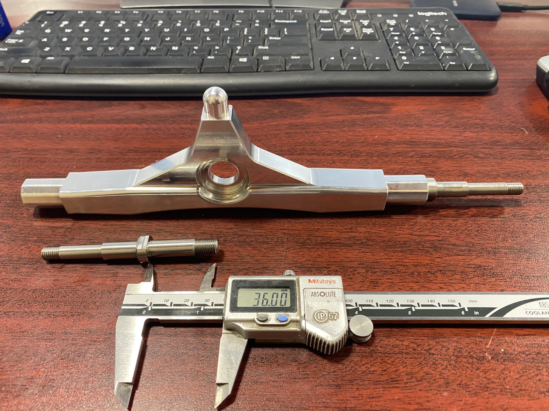

So, the axels that I make have a flange that tightens to the hanger face, which in turn distributes the load to the face of the hanger. I could make them 30mm long though.
These are the axels that I made for my RKP’s
36mm is a little overkill.
Axels will extend 54mm from the hanger, made from 17-4 SS. 10mm dia, and 10-8 stepped available.
Overkill is excellent. Trucks have histories of failing, especially due to cyclic fatigue.
Ok this is sweet I’m going to take a set your work is so nice and custom :yum: I’ll telegram you :call_me_hand:
Still got make a few and test them
Sure, well my Boardnamics 10-8 step down axles on Surf Rodz 179mms bent on their first outing riding Abec 107s….
I’d say I ride fairly conservatively - and have never bent axles before.
I’ve since changed to 10mm axles and are solid so far. I’d consider using these trucks on 10mm axles only when on thane. 35mm of support inside the hanger for the axles is a good idea for sure. 20mm might not be enough?. 54mm long axles is also a good length to make sure there isn’t too much bending leverage on them
Am guessing the threaded hole for the axles is deeper than the thread on the axles- so the flange meets up flush on the hanger face- are any axle grub screw holes there too?
I had a real fun time getting my bent axles off when they were red loctited in… so using 243 only now
Also the hanger bushing seat looks a little restrictive compared to the Surf Rodz- is that fair to say?

OK, cool! I could not tell by the previous picture

What’s the downside of a longer length for axle embedment? Weight? I’d suggest that any small weight increase, in favour of increased strength or durability is worth it.
Batteries are heavy. Trucks really aren’t.

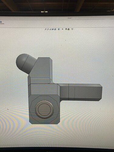

@Savage1 can you provide a cross section of the bushing seat?
I’m sure dimensions would help
