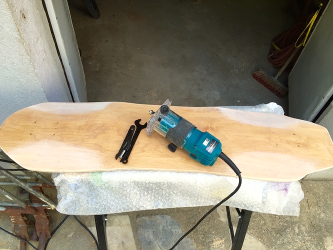

1 - Make the deck :
The custom deck (9 plies), my 1st DIY one !
I love this pic !
cut ends !! Beatiful DIY 37" deck

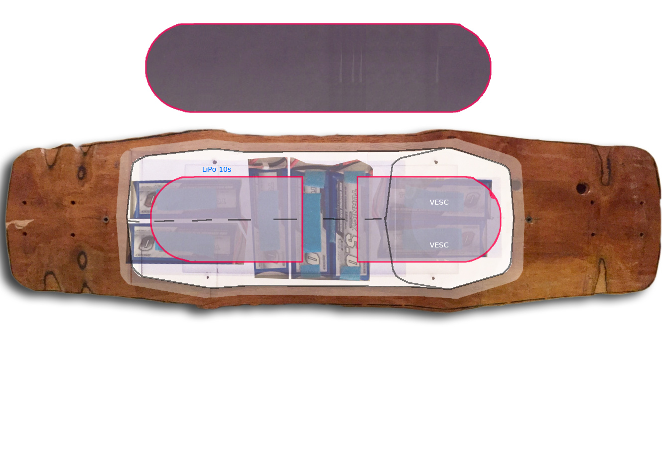

The layout (long and slim battery pack around 16mm) :
I resized and adjusted the symmetry of the deck easing of some 100g and familiarized myself with the trimmer.
Then I went to dig the deck of the center, beautiful fail nicely caught! So I finished my ripping planing and sanding until a beautiful flat :

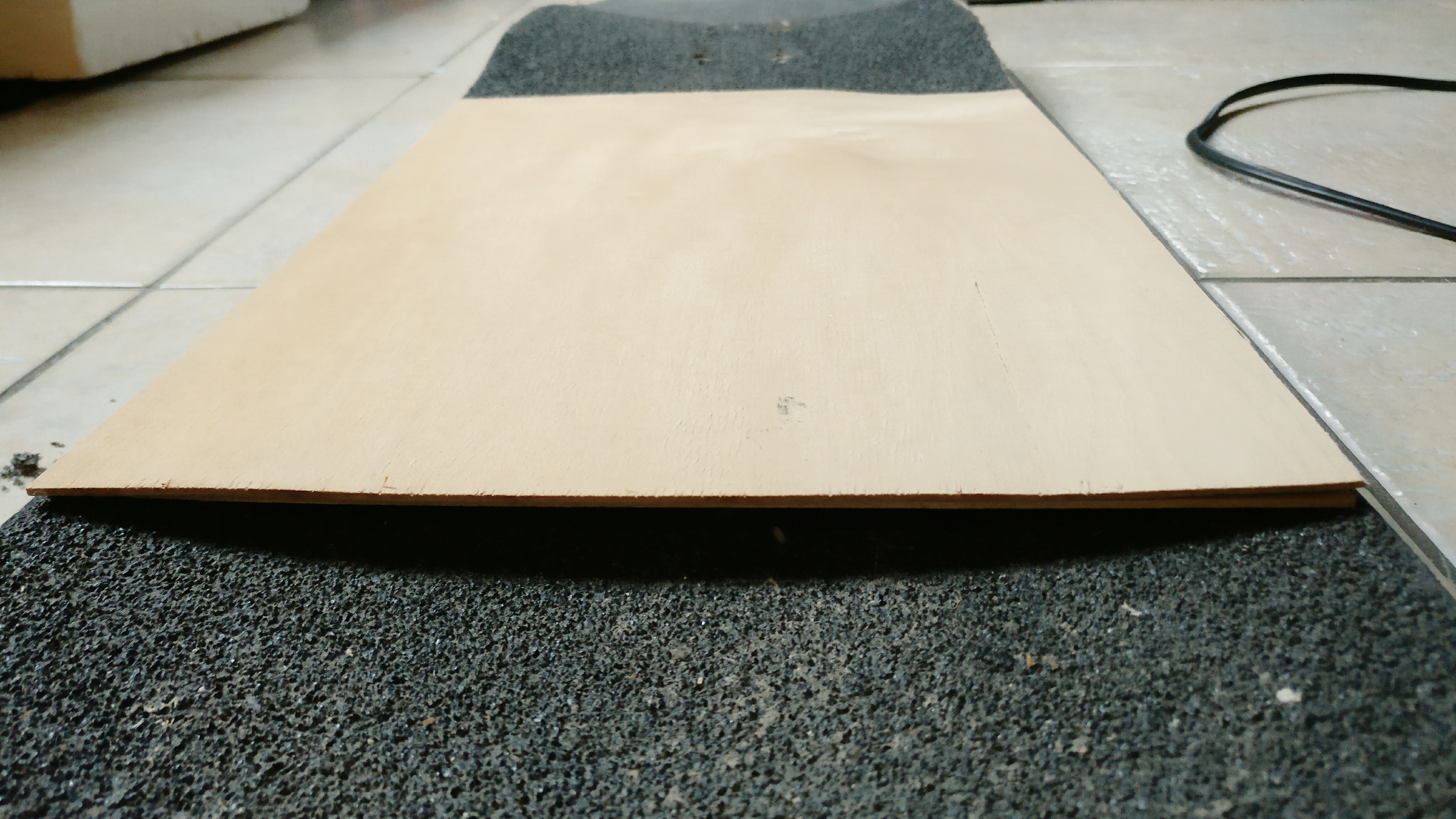

And here the profile of the 9 layers (7 wood and 2 carbon) :

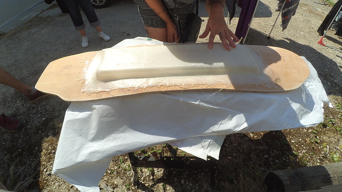

now the enclosure: I wanted to change a little technique and tape the mold directly on the deck (wrapped in cellophane) less tape to be applied but equally complicated …
done! (but I have a problem on a flange, will apply a second pass of fiber with some deco !)
like Whitepony suggests me

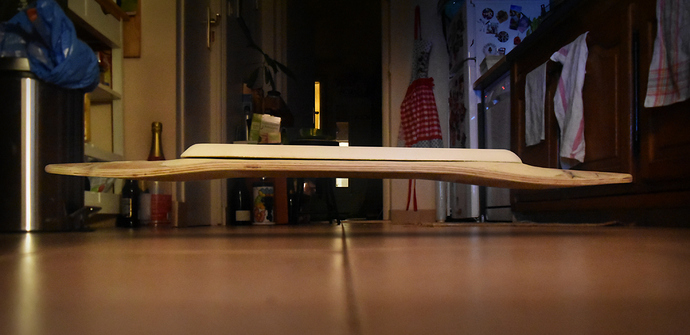

2 - Make deck enclosed
sorry, pict is better for you than frenglish word :
TADA ! It’s flat

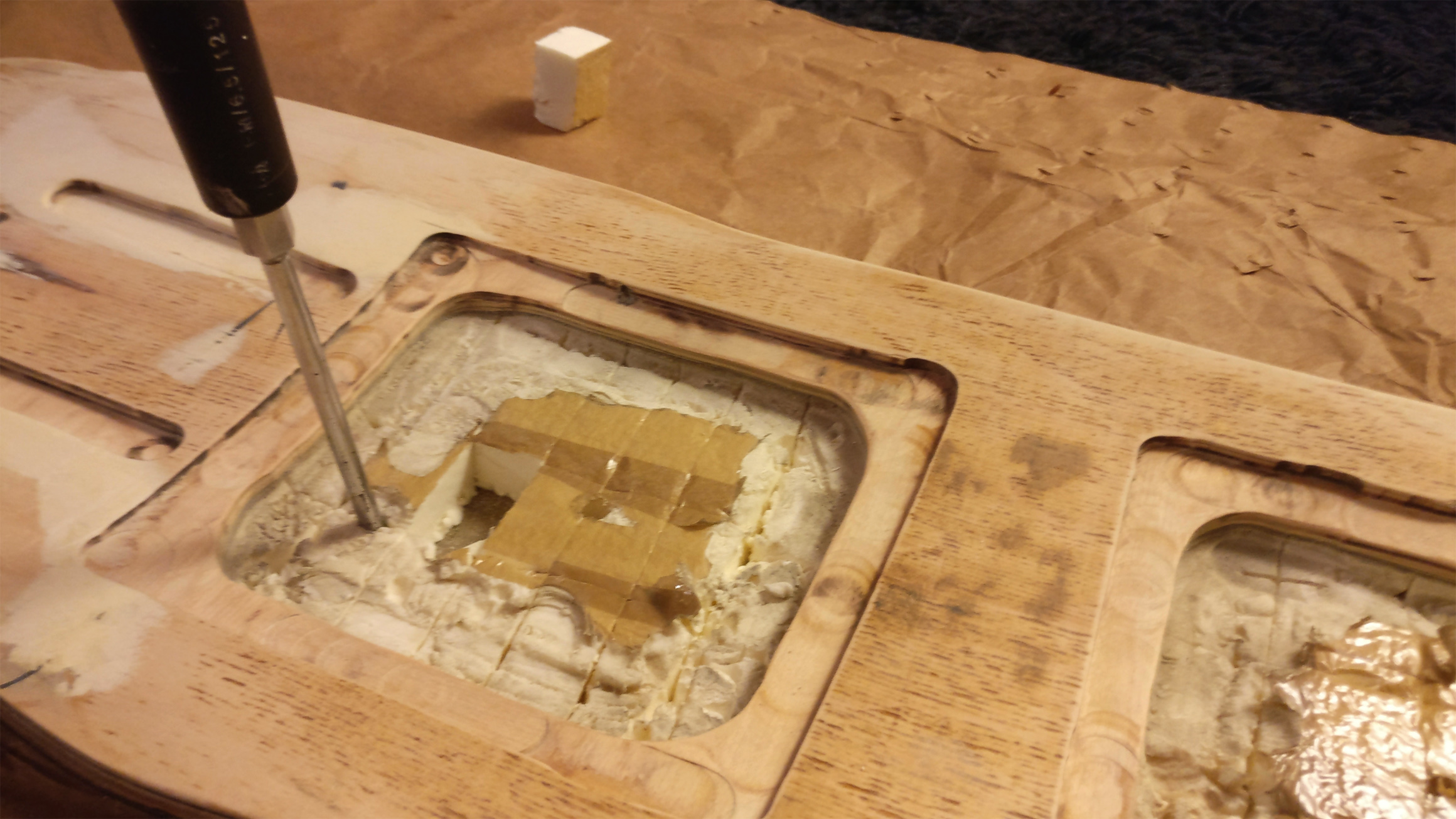

I hesitated for the top trap door,
Red line
and I leave a central reinforcement
Preparing access to the box,… Stitching haaaarrd !!
hahaha, yes my deck is crying !!!
And after :
Now empty it out of his mold !.. work work work !!
Design of the hatch for the top of the deck, I use my mold deck which served to make the DIY deck
The deck is empty !!
Now I just got to put all the electrical part in it and make some holes for wires

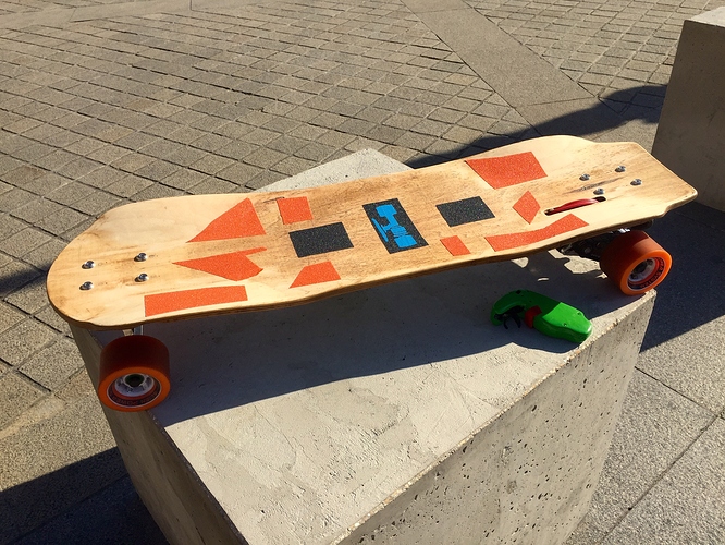

VESCs are updated FW2.53 Ackmaniac ! New remote Madmunckey case with CH3 made by Pimousse (Big thanks again !)
And I’m finaly done with my wheels
All good, test ride on real road soooooooooon !
I finaly did the restratification !
Yes I cut it because … the space for the lipo was to short, or they cant inflate !..
ok, between ride of this little baby
Complet new setup
And it’s really cool, perfect cruiser for summer !
Nothing exit from the back, no wires, no connector, fully closed just the trap on the top.
1th I parameter the vesc for this little 22amps motor … 0.01 start up boost, and I wasn’t really ready for so less power
But after some more prameters up (25Amps batt and motor max current control actualy (soone watt mode with 900w max) and the custom curve for more acceleration and less punch at top speed).
Cause when your rolling (lets say around 20kmh or more) when you push the throttle is pretty good for what I’m looking for. I go up to 30kmh and really could push more ! (enought for me)
But after just 3km of run they are terribly hot !!! (dont know how the indise support this …)
The freewheels is super cool when you kick the battery and need to return home at cut off start.
The urethane isn’t that bad, and the Ronin truck are just a killer for electric setup ! Stable and super carvy same time. Love them !
Finaly love this setup after some rides
