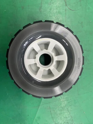

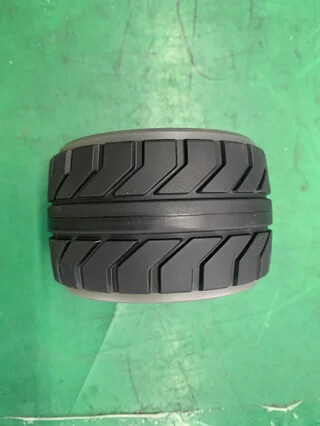

Rubber wheels, Small airless wheels that have rubber tread.

Hopefully the rubber improves traction on my toothpaste covered streets!
Anyone know how much these would weigh? Or even just the 100mm Exway version.
I wonder how long the tread will last.
Rubber wears down pretty quick. My onsra 115mm are 103mm after a few months

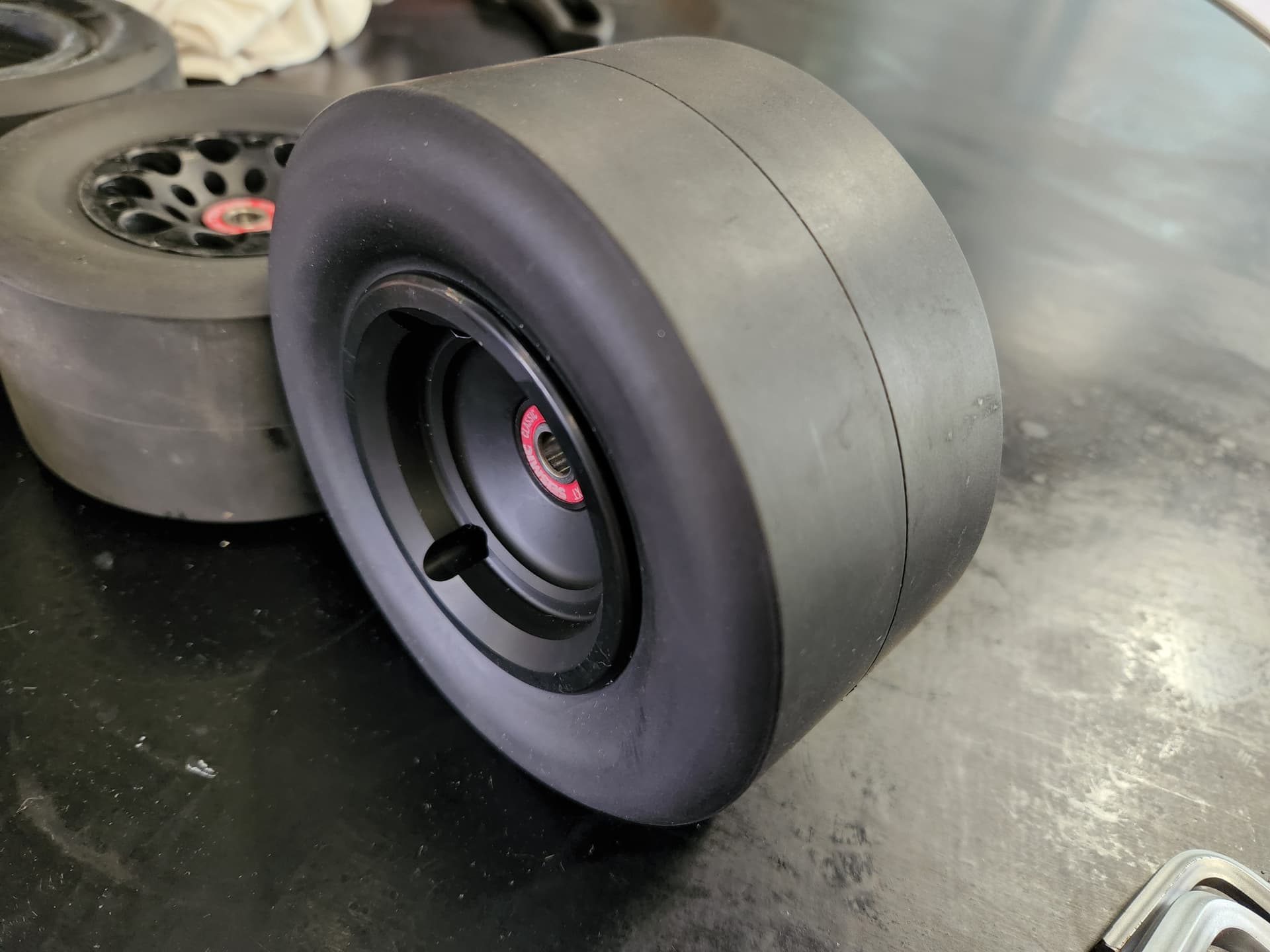

for anyone bored of fixing punctures…
Heres my DIY hurricane runflat inserts: Worked better than expected. squish equivalent to around 35psi. much flatter profile means larger contact patch and better grip (in theory). Feels almost exactly the same. i was expecting some tyre roll while carving hard or vibration but its spot on.
1x 20"x1.75 JUST exactly does 4 tyres. 26" insert would give some room for error.
Didnt actually need to trim them down. can JUST get them in without trimming and this would then be slightly rounder profile and firmer.
Should work on other tyres such as 6" Electric Skateboard Tyre Full Set of 4 150x50mm – Eskate.shop
I cut 1 end of each insert at an angle so that there was no dead spot on the outside surface. The photo of it inside the tyre shows a gap on the inside. test fit and if it feels softer at the join a small triangle piece can be added.
Nice, no balance problem at speed?
nope, better than the offset mass from a valve :call_me_hand:
Wow! The change in the profile of the tire is dramatic!
