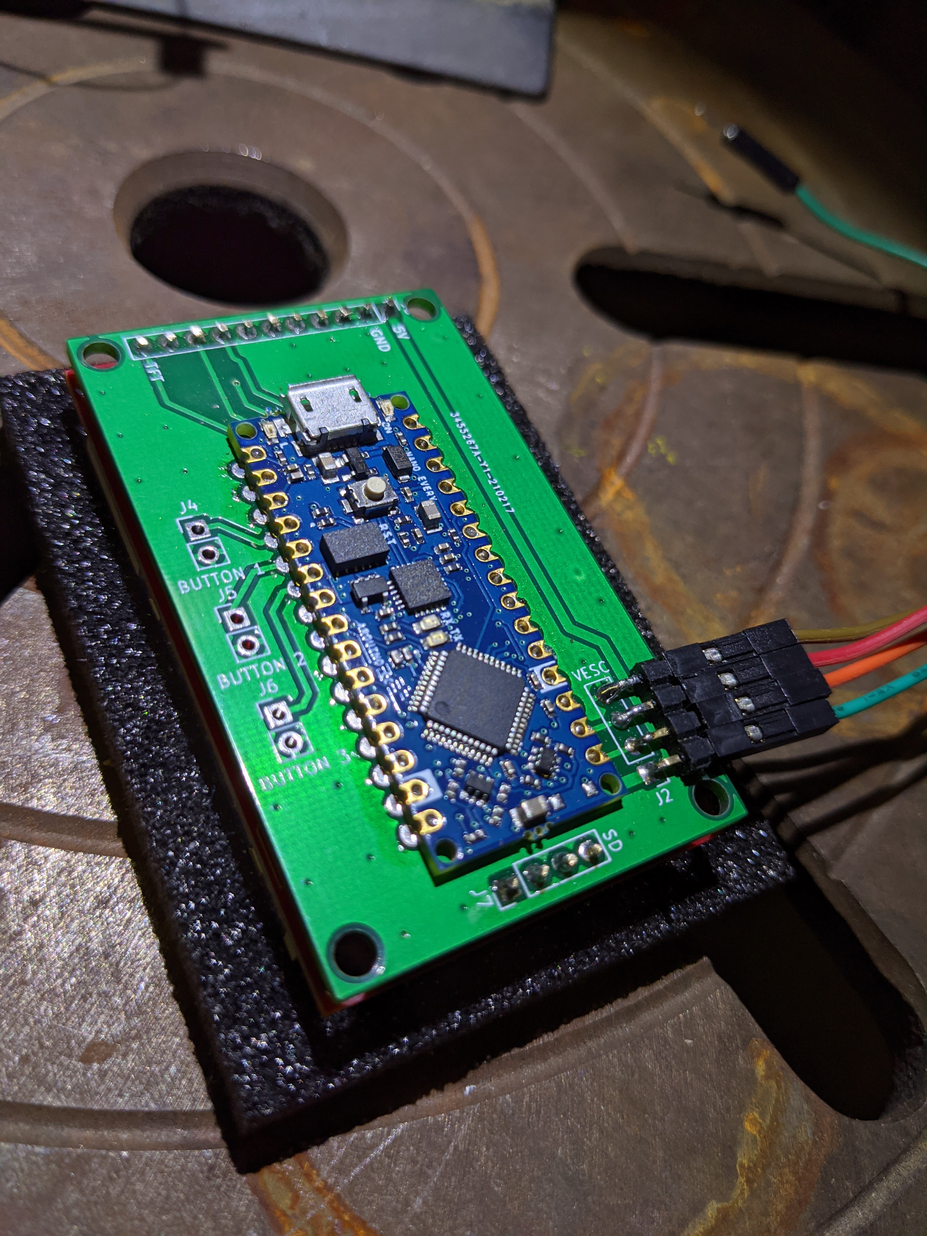

Hi Charclo, thanks for doing this ( and thanks to Janpom ). I’m having trouble opening roxie.ino in the arduino ide. Says the source file needs to be in a sketch folder of the same name. I renamed the file to “src.ino” just to get around this (prolly not a good idea but it worked to get it to open up in arduino ide). After this, it cannot find any #include files when trying to write to the arduino every. Any idea where I went wrong? I followed your instructions but no dice.
The main branch won’t just open in the arduino IDE as I’m developing in VSCode with PlatformIO. You can either install that or use the release .zip I uploaded (.zip). The code from the .zip file will work in the arduino IDE, the code from this is older however. I’ll upload a newer version tonight
I just uploaded a new release
Thank you, I was able to write to the ‘every’. I see where I went wrong. I clicked the bright green “code” button to download instead of the release .zip. I’ll download the newer version before I hook it up. Thanks again.
See the message I just posted

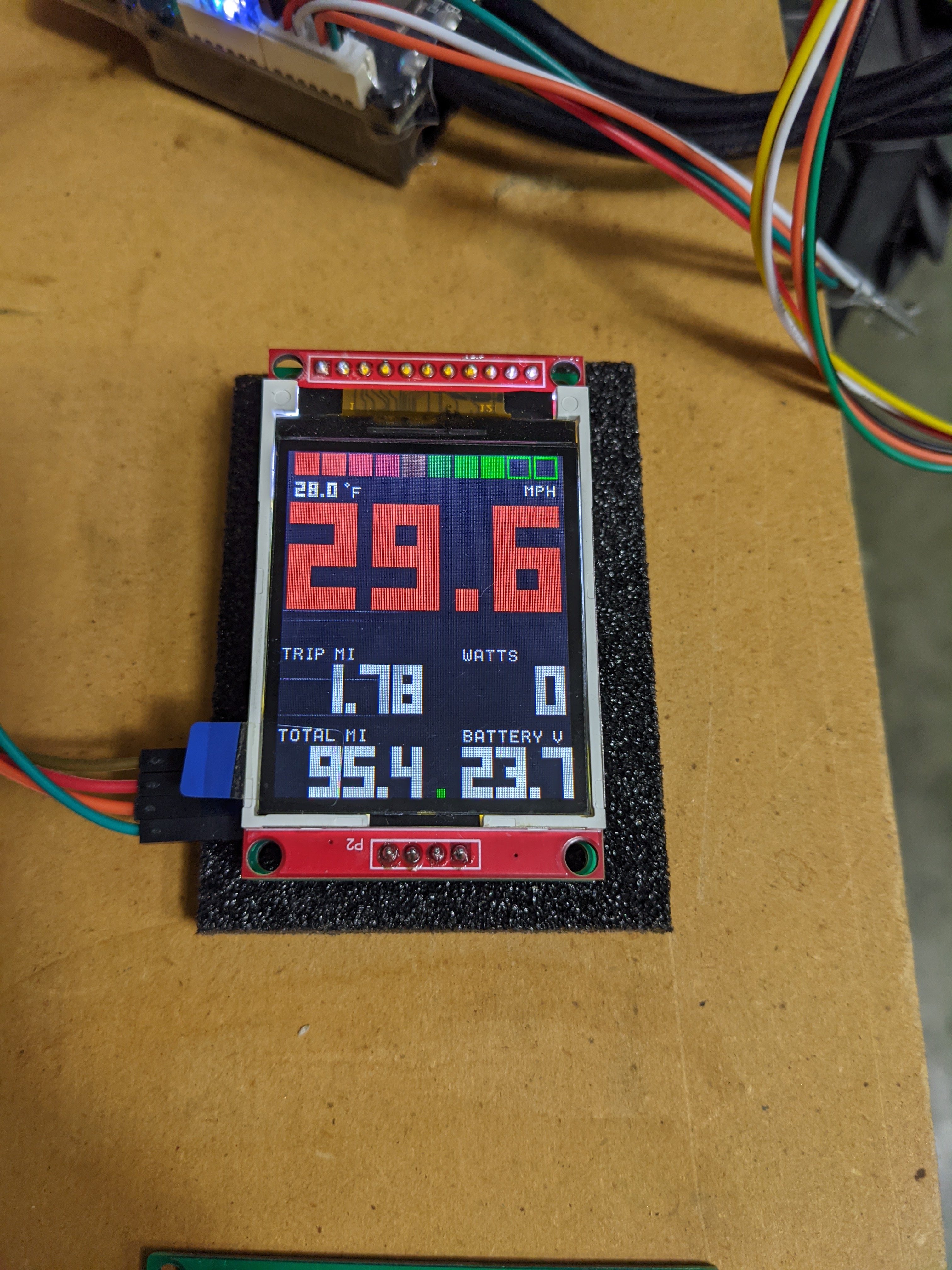

You’re the man. Works perfect. Buttons wont arrive until tomorrow so can’t test that yet but readout is flawless. Running on flipsky mini fsesc4.2 firmware 5.2. I’ll send you and Janpom a PM once everything is up and running to contribute something for your efforts. Much appreciated. Followed your instructions by uploading the gerber files to the company you linked. Cost 2 dollars total plus shipping for 5 unit minimum. Shipping was more than the boards. I’m in California and it took a little under 2 weeks. The wiki might confuse some while trying to write to the board if they know absolutely nothing about electronics like me. Your updated post on this thread fixed that. Thanks again and I’ll keep you posted after my project is all done. One thing, I did have to switch the RX and the TX as I found out reading Janpom’s old Davega os thread. Have a good day.
Thx, really cool to see this in the wild :slight_smile: The price for me was the same, 2 euros + shipping. I’ll update the wiki to make it more clear.
