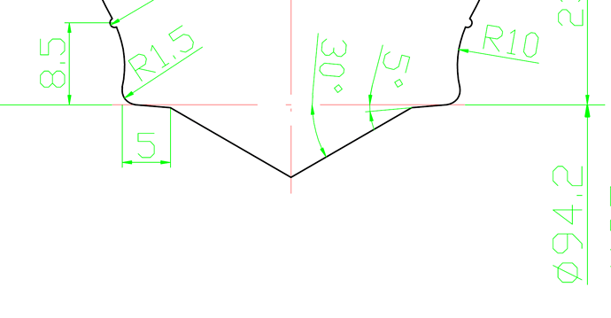

The problem is the size of the hub. Going smaller in diameter reduces sidewall height a lot and the tubes get smaller and likely more fragile. Split hubs prevent pressurized tires but id love to see that, hubs will cost a lot. hopefully the tire company you’re working with has some creative ideas for this.
Honestly, an air-less tire would be ideal. Puncture proof, flat proof etc. We have a few on the market, but they’re crap quality with no real engineering behind them. With proper materials and a design team, maybe there’s something there. Needs to have better than 110 thane ride quality, minimal losses in efficiency over the thane and be stable and balanced upwards of 40mph while weighted… oh and be rain proof :smiley:
As far as outside diameter and width go, I think a poll for the riders on here would give the best market intel.
The inside diameter is the main thing that you need to get right in my opinion. Tire size standardization is terrible in my opinion. I wish there was one true standard but it’s all over the place, some metric some imperial. MBS, Trampa, and Evolve are all based on the 200x50 standard. 200 refers to the outer diam in mm (8"), and 50 is the overall width of the tire. The ID varies but ours is basically 94.2mm.
