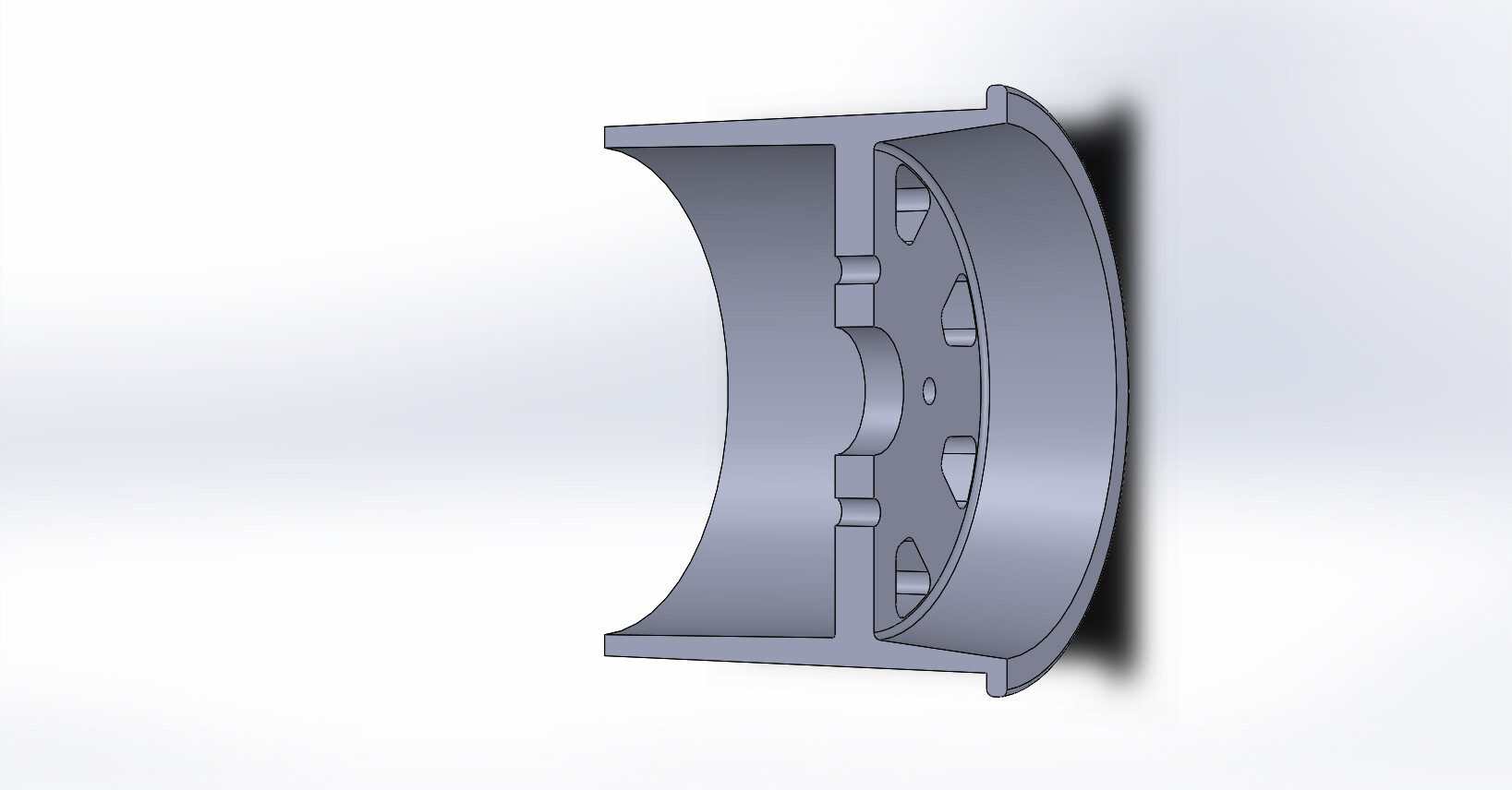

Here is a cutaway of the BRP Core

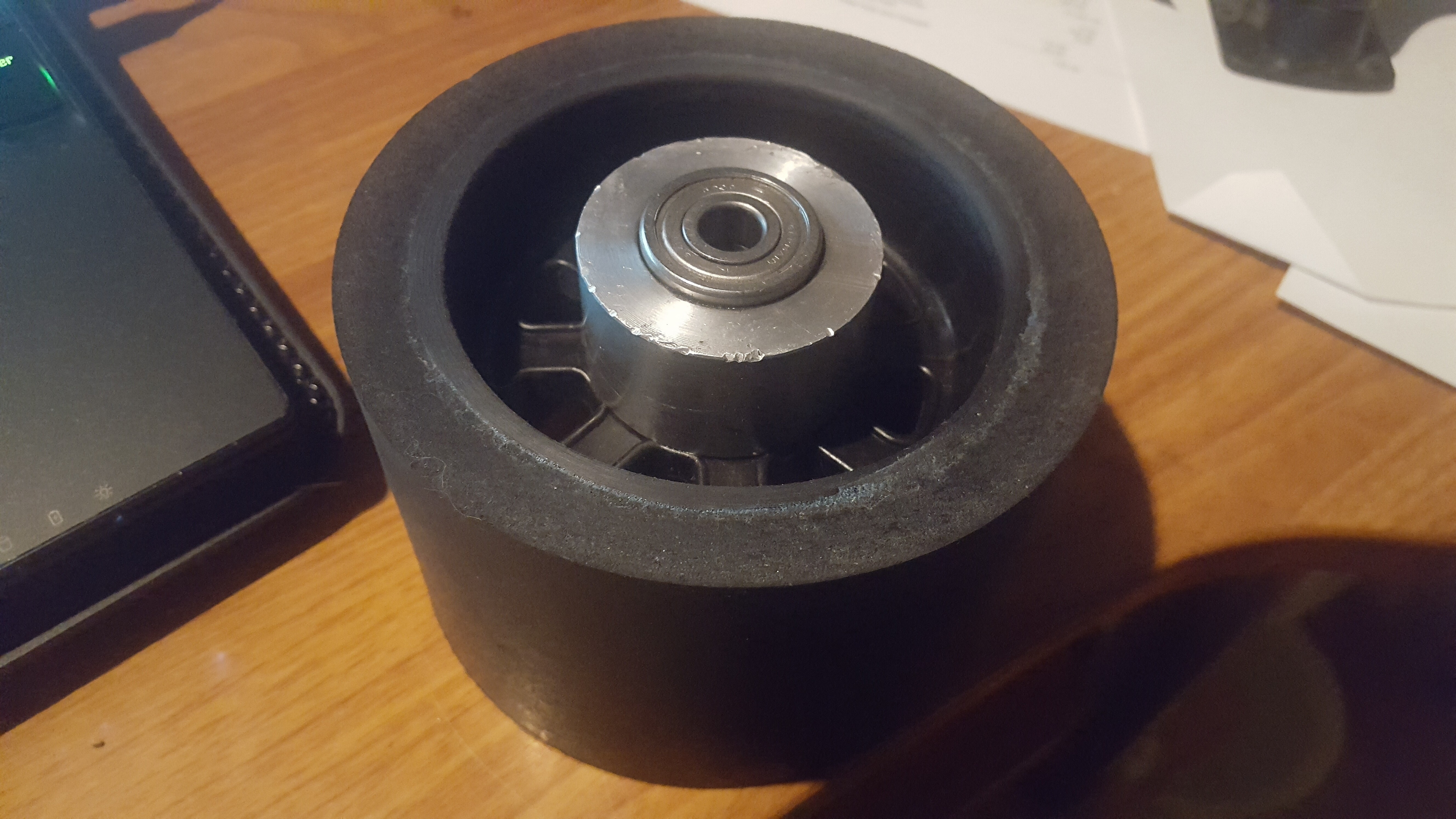

Weight is 800gm for the full dimension wheel with a massive aluminum hub complete with 30mm bearings installed. Our compound accounts for about 500 of the 800 grams.

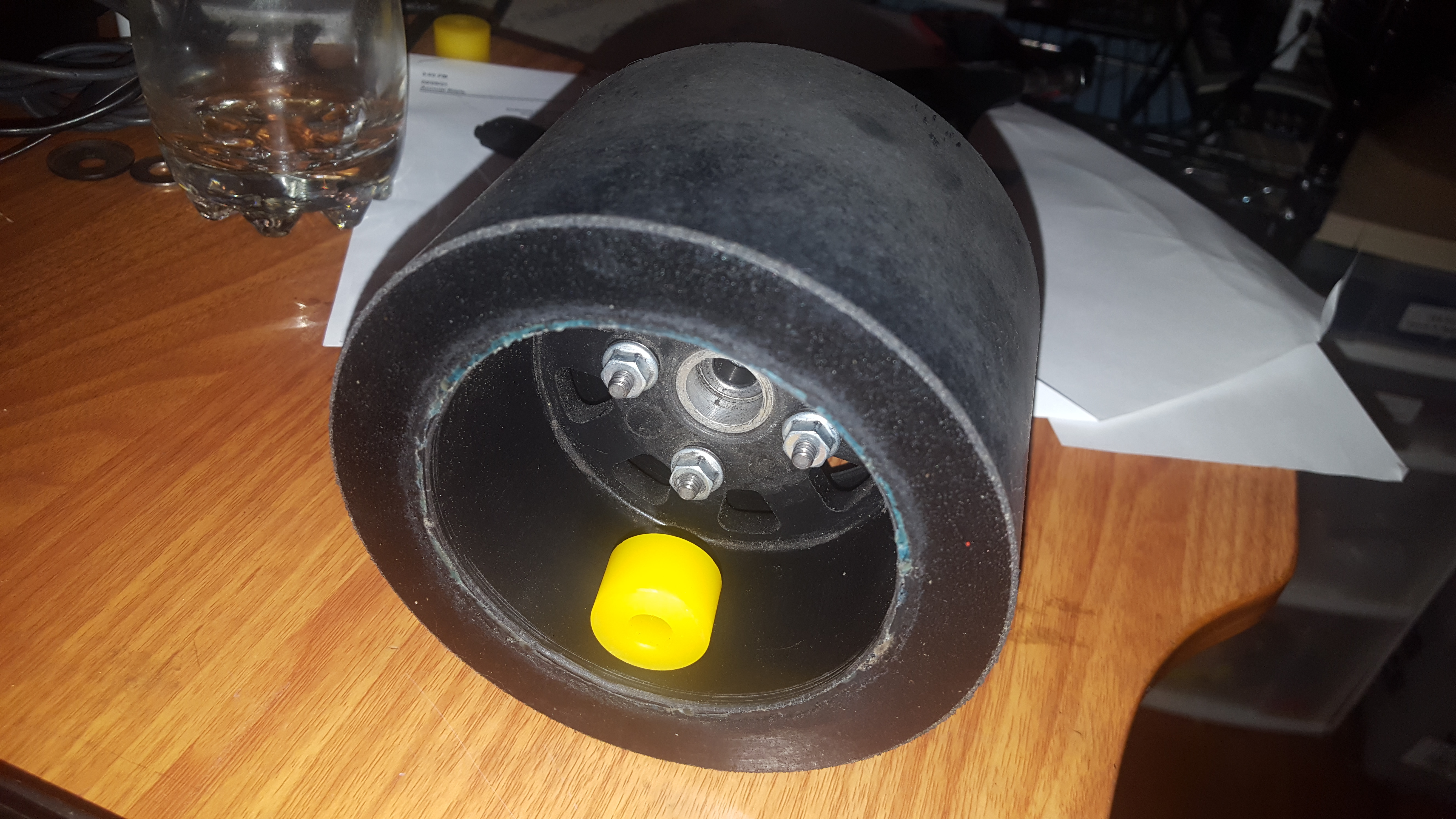

RipTide Barrel for perspective.
This ^, if you could make a 85-90mm version you’d have a crowd of DH, street and DIY peepz that would be able to mount em and get in on the grip game :slight_smile:
Bruh, I use 130mm wheels top-mounted on short decks. You’re just not trying hard enough :crazy_face:
I can look into this but likely in a harder durometer. The over molded wheels in the pictures above are 60a
