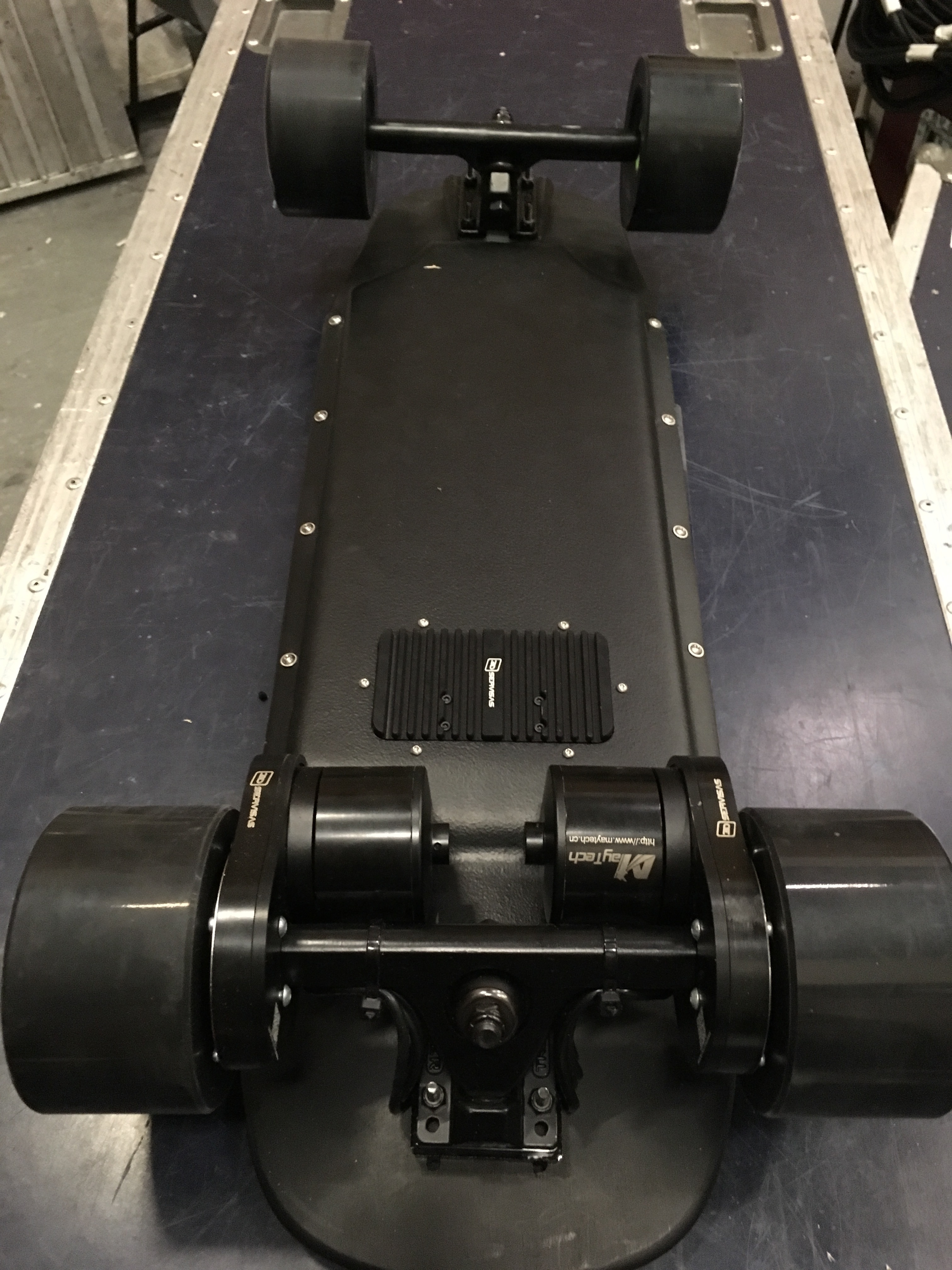

Let’s take the common curent premium commuter builds on this forum
31inch Tayto deck
4-4.5x the Wh of a 10-12s 3p so 330-400wh
6x the motor power Dule 6355 so 3000w
1.25 the speed 40kmh
5x the tork for getting up hills
3 x the cost but geting more than a 3 x the board in my eyes

Now that’s a bit high? Maybe eu? In the us a dual 6374, 12s4p, focbox build can be had for 1500usd~
I am talking a no compromise (premium lol) build with an expensive trampa deck, trampa vescs, etoxx drive etc etc. It sums up
The build I was talking about is no compromise, sk3’s focboxes, surfrodz, Hummie deck, 30q’s
I guess your talking bout MTB build while I’m talking about street build
