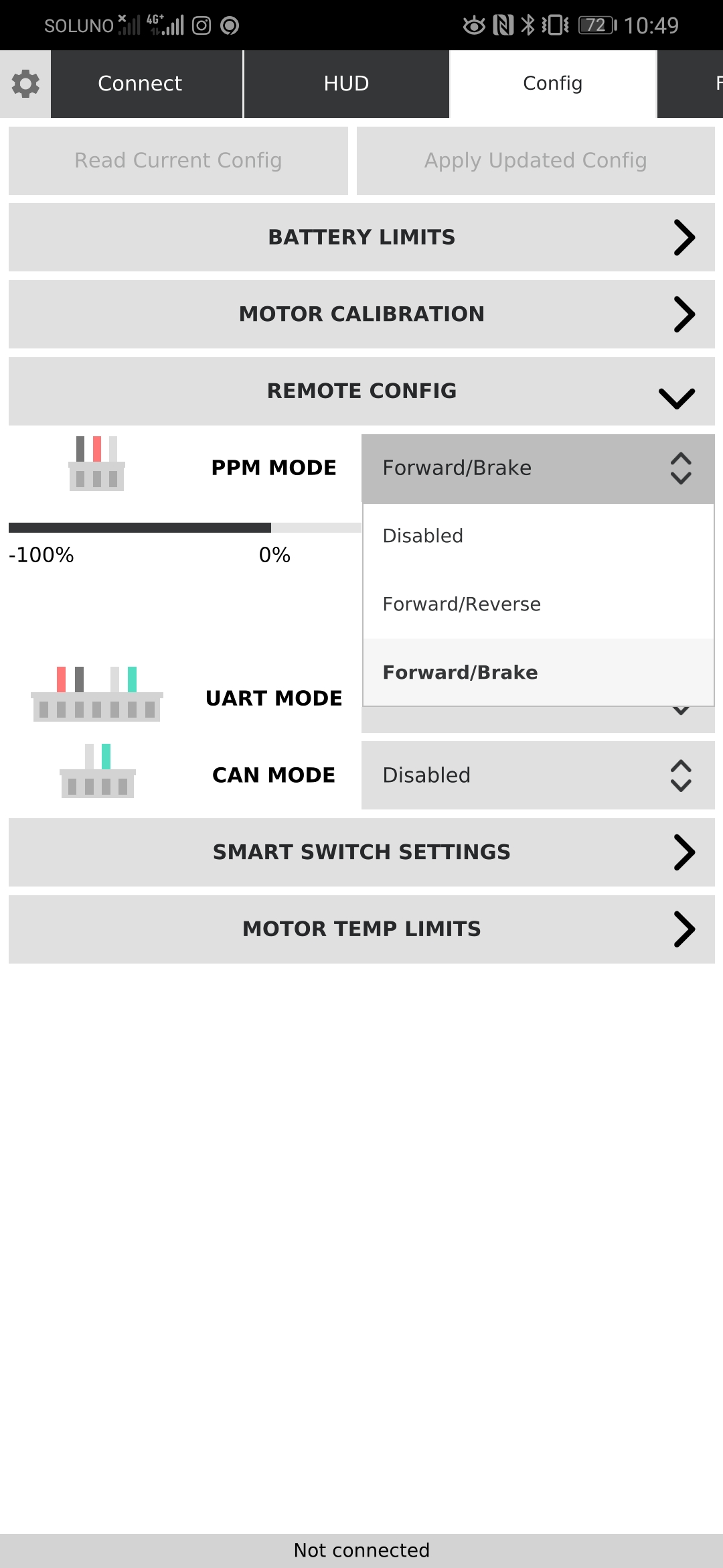

Has it all! It can also limit speed in reverse via MPH or Km/h value in profiles.
This is how easy it is on unity:
As far as I know there is no way to limit reverse speed on the Unity. This makes it very dangerous to use reverse.
