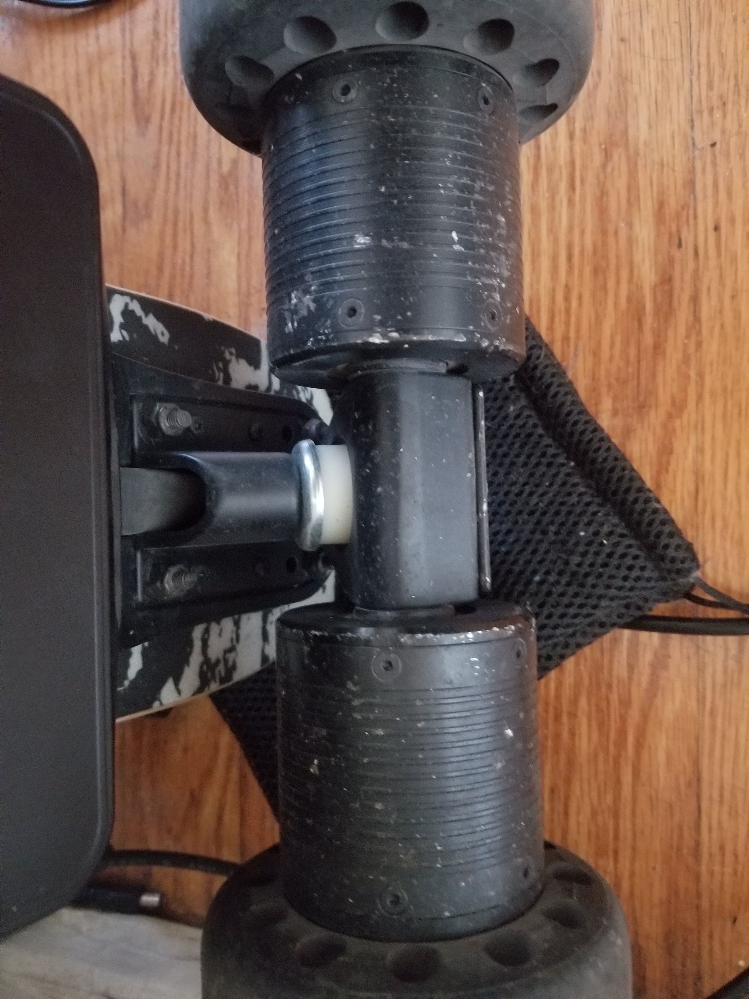

Lubricant used for cleaning.
The best would be opening the direct drive cans an adding fresh bearing grease, but I can’t seem to find the right Allen key Impérial or Metric to get them out So I’ve never done it.
You probably know that if you do find the right allen wrench, you will need to heat it to melt the red loctite.
So you need two keys. A sacrificial wrench to heat with a torch. A second wrench that never gets heated.
I’m not saying it’s a good idea to disassemble. Your spray and wash technique seems pretty low risk.

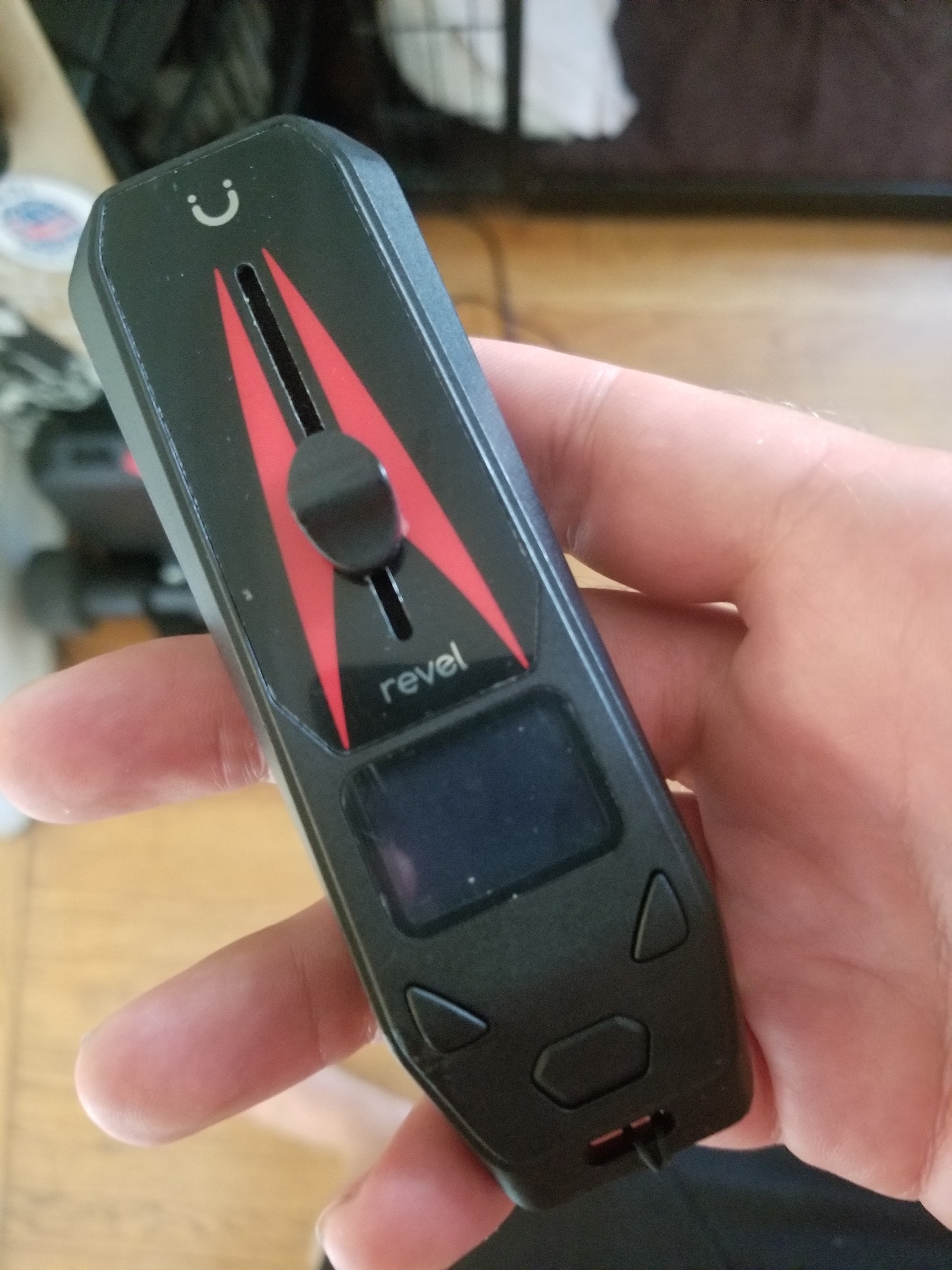

Some anker batteries have trickle-charge. You hold the charging button for a while, then one light turns orange. It’s made for exactly these small devices and never had issues with it.
I just tried charging a bunch of other stuff with the same cable and port, and everything charges except the revel remote
I had a random idea: I got a usb-c to usb-a adapter and tried charging the remote through the PD / usb-c port and it works. Guess it just doesn’t like the usb-a port of my anker

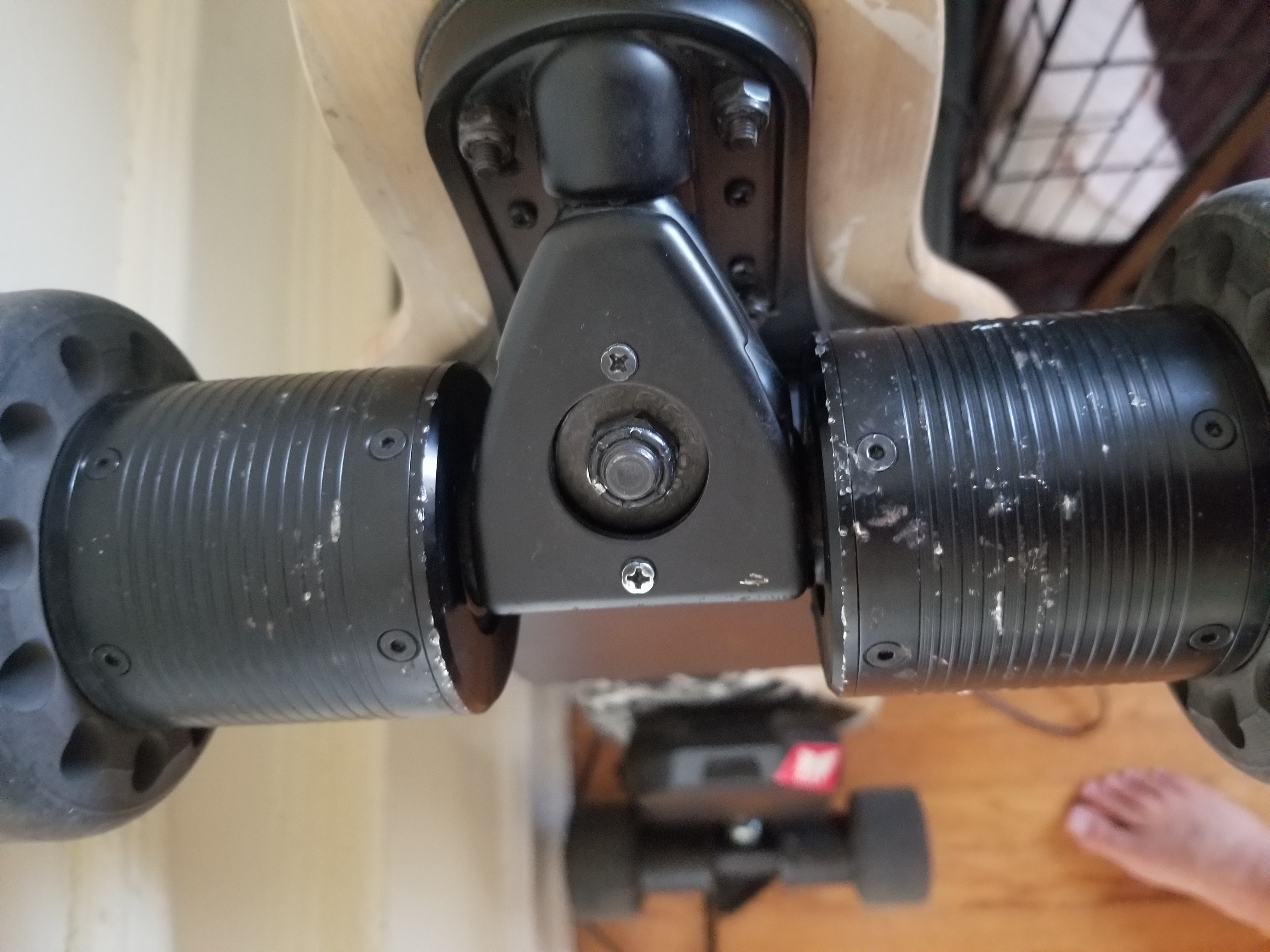

I am glad to announce that my video of a single motor spinning was caused by nothing but grime and dirt.
I cleaned out the wheels, motors, swapped in brand new bearings, put speed cream on them, and all is well.
Torque is back to normal and both motors spin at about the same rate

you replaced the wheel bearings right? not the Motor bearings?
So you fixed the problem with only one wheel rotating with a really throrough clean, swap and lubrication of the bearings. Cool.
Did you use the @SpeedyFrenchy motor cleaning technique? What was your cleaning fluid.

Yes, but not as severe. He mentioned going through 100ml of lubricant, I only used drops.
I used isopropyl alcohol for the outer layer of dirt, bones speed cream for getting into the motor bearings.
I suspect the reason @SpeedyFrenchy went through so much liquid is because he did not take his time to thoroughly clean the other layer first. But that is of course speculation.
I used a plastic pick with a fine point to scrape around the edges of the bearing, angled outwards so dirt would go out, not further in. I then gently used cotton swabs with isopropyl alcohol to absorb the dirt. Repeated that process until swabs came out clean (on both sides of the motors)
I then used bones speed cream with a few drops on each side, ran the motors and cleaned up any dripping with paper towels. Repeated about three times.

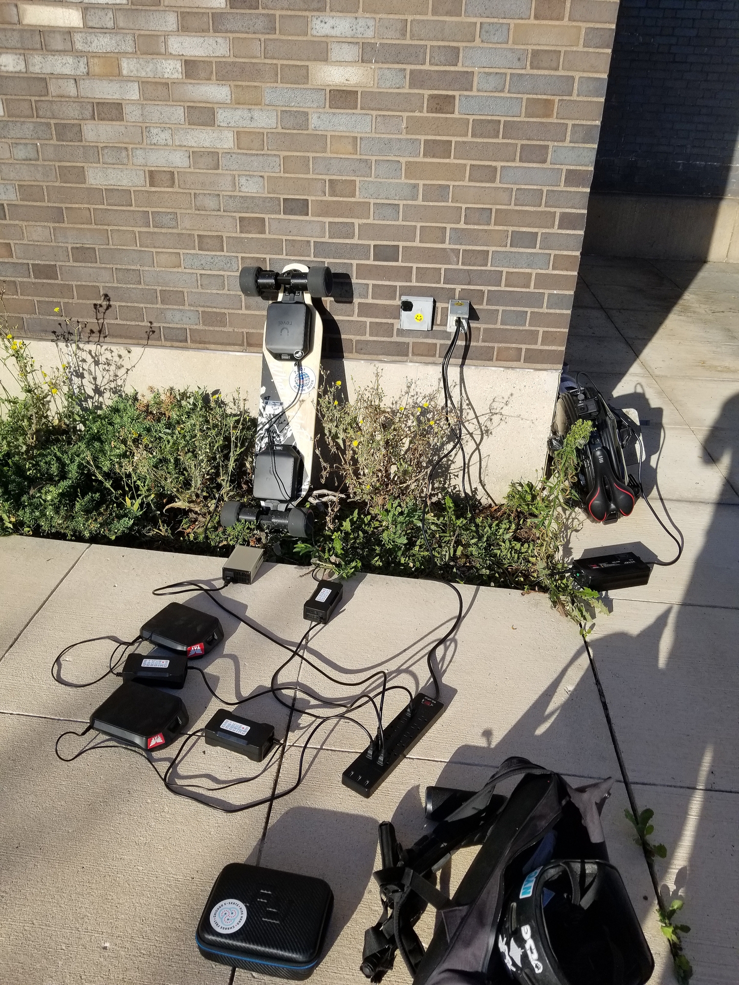

In case anytime has any questions regarding the durability of the Revel kits…just completed a 100+ mile ride on a 4WD kit with 2000 miles already on the odometer.
It performed flawlessly as did the 2 extra sets of XT batteries I brought with me.
So you got 172km with 6 XT batteries w/ a 4wd setup? That’s crazy! I’m guessing you stopped to charge up along the way?
