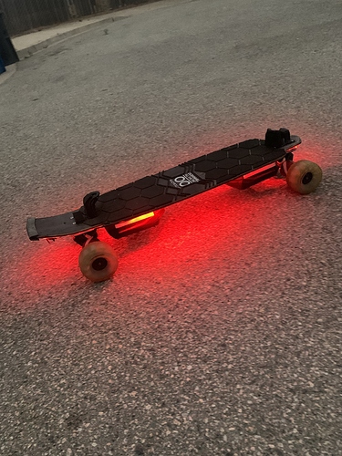

Also added some much needed LED’s connected to the USB port.
image|375x500
@SpeedyFrenchy
Super cool looking ride.!!!
I’d love to know more about the honeycomb Grip surface. Neoprene? Where did you get it?
Nice big kicktail. Is it enough to lift the front end?
I’m trying to figure out what the two posts are? Foot hooks?
I’m trying to picture how you get your rear foot over the hook and on to the kick. Must be tricky.
I do it all the time on the Tarib but there is no foot hook in the way.
Wheels? those are 120’s?
But you also have 105 discoveries. Do you notice much difference in ride comfort?
It’s Dope griptape from a company in Europe, but can easily be done DIY with 1/8inch neoprene.
Yes big enough to tic tac around and yes it’s a toe stop, it’s not that tricky to put my rear foot on the tail and back and forth.
They’ve help immensely with staying stable at high speed, avoiding wobbles and jumping over gaps
