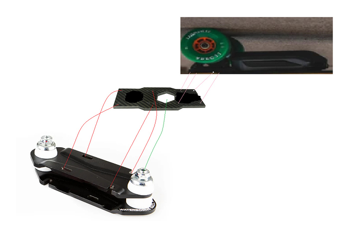

I was also hoping to get better insight as to what both Maven and I could do in order to best fit the Waterborne Adapter onto the board so that thereās no back lean or a gap between the board and the drive unit.

Is it possible to turn the bolts upside down on the rear waterborne adapter? if it is then just mount the kit right to the bottom of the adapter with an adapter as thick as teh bolt heads

- I was going to see if a raiser can be put between the truck and its holder. if that cant be done then the solution will be to put the raiser between the deck and the rebel kit. may be will look a bit wierd but it should work fine. also you could find some foam to fill the empty space between the deck and the revel kit.

You would bolt an 8 inch aluminum plate to the rear surf adapters and drill holes for the trucks on either side of the surf adapter. You would also need to rotate one axle by 180 degrees and reverse the motor wires left to right.
So back to 2WD, you could do something similar. Bolt a short aluminum plate to the rear surf adapter and cantilever the entire unmodified Revel drive off the front or rear of the waterborn adapter.

As for the rear adapter, try using an aluminum plate to cantilever the drive infront or behind the rear surf adapter. The rear surf adapter looks pretty strong. It should be able to handle some cantilevered weight.

@pkasanda had mentioned that I could possibly cantilever the Revel Kit while using the Rear Rail Adapter. Could you talk more about what exactly you mean as Iām quite interested.
