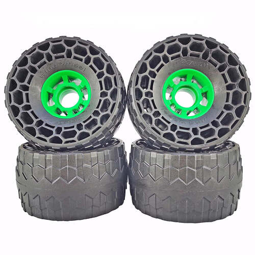

I’m planning on getting a few sets of the viper wind wheels to cut down on the weight and centrifigal mass. The wheels look pretty effective according to some youtube reviews. But they are not cheap. I tried to negotiate with them for a better price for multiple sets but they did not budge.

I was watching a review on the Beast board and wind wheels last week https://youtu.be/JNpYSy6NW9E I am a believer in honeycomb and similar designs… I’m writing this while sitting on a buckling column gel seat pad, and I sleep on a buckling column gel mattress topper. The honeycomb is obviously different, but same principle of pressure distribution. It might even follow a similar concept of collapse threshold (firm to its threshold, and then soft after collapsing)…
Would be nice if the Wind Wheel came in a different color besides white.

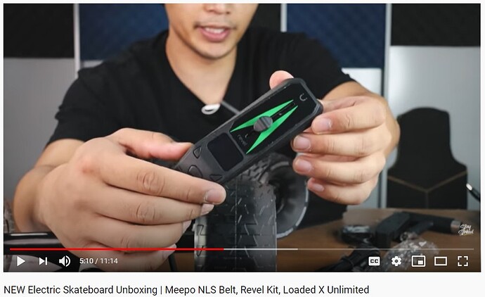

Hey Guys, I was watching a video by Ronnie Sarmiento and he opened a Revel Kit with a green remote vs. red and mentioned something about this being the latest drive from Revel. Wondering if you guys are aware of any changes, or improvements with this new drive or new remote.
