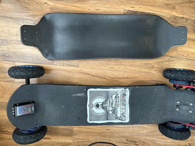

Also interesting i got my small boardnamic mounts to fit and 3d riser printing ok. Not again not the production deck not the motors or wheels for final build but at least i can get hangers sorted and test handling. Currently i feel i need to play with washers, maybe use cup ones and then also adjust angles to give it more carve esp at rear.
Testing the fit for battery case and wheel clearance. Overall clearance will be around 80mm with this 8inch wheel.

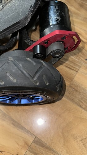

You’d think a motor bearing would go prior to using red locktite on the pulley but oh no… anyway managed to replace a seized bearing in the Flipsky 6374. I feel I’ve unlocked a new achievement! I was scared they’d break in the motor trying to get them out.
My engine mounts are far from ideal and I’m still waiting for 345mm belts to get here. Once things are going I’ll be looking to replace mounts with something precision.
Also had to design and print some walls for the prototipo pulleys as the belts fell off. Moral of this story is always go precision mounts so that the mount is square and the belt doesn’t move. Def worth the extra money always. Lessons learnt.
Went for a quick spin and got to say my second opinion is I’m loving this truck over my matrix2’s. Feels responsive, accurate stable and still very easy to turn.
The last piece of the puzzle will be the board and the lock-ins for my feet the concave will create, also ditch this ugly as sin dw2 lollipop board made even worse with my cutouts now.

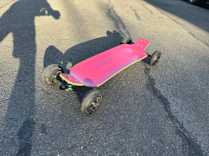

Deck is ready, now for inserts.
18/3 board mostly completed. Ive left radiums off for meanwhile and some basic grip tape while i wait for better stuff. Also gps not wired to board. Everything now Loctited in place. Ive had to add another set or risers so now 55 at back and 60mm clearance at front this is becuase the trampa housing sits low at the ends.
Deck is super amazing with perfect flex and concave. Love Flowstate’s work!

Managed to get my existing bn caliber mounts fitted is i use 62t pulleys. Practically a gear drive and a little ugly but works for now with 350mm belts. Wheel bite is very close with 8” so i’ve gone for 7”, 8 will work okay but maybe my toe might hit at times on a tight slow turn.
