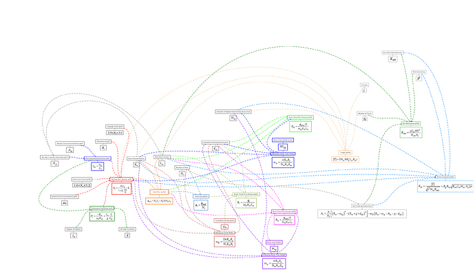

For those curious, this is all the parameters needed to describe the motor constant in a motor, the holy grail of the parameters, the one that matters and no motor manufacturer put in the specs
There is still some work to be done for a estimation of iron losses
Then it’s a matter of implementing all in a spread sheet, determining what motor configuration can produce a comparable performance as a geared setup, and further optimization using FEA for both mechanical and thermal simulations
Very nice diagram Pedro!, I’ll take a closer look in 1-2 days (MA thesis is due in 2 days).
Quite a fascinating project !!
Thanks Mathias, please do since you have significant knowledge
