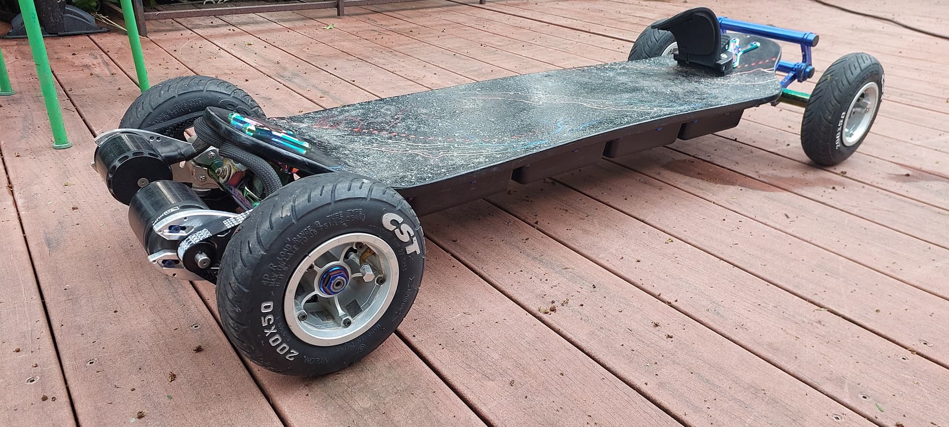

As nice as they look. As is the rods donāt have a rideable amount of clearance on the front. They would need to face upwards for the front truck.
Rear rod clearance not great either but on absolutely perfect roads maybe doable facing downwards. Small motors would allow them facing upwards which would be better
The trucks were setup like this just to try the angles out rolling around a bit before itās electric. Itās gonna have pneumatics eventually, not gonna stay like this.
