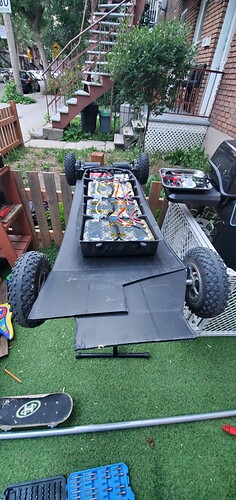

Could you share the dimensions you used for all the cutouts? Looks like a snug fit.
If you also wanna share the inserts you used and the dimension hole you used in cad for them that would be great too!
Great work!
Dimensions for the cutouts aren’t accurate, I imported the connectors from grabcad and used those for test prints. 0.3 offset around the outside of the connector fit very nice on my test cubes but I had to file the actual enclosure holes a little bit to get them to fit. I guess 0.35 would work fine.
The inserts are Ruthex M3 inserts but ones from aliexpress would work too, make sure you get the opposite knurled ones since they lock in very firmly. The holes are modeled 3.9mm according to the datasheet.
Thanks for the info. Could you give me the absolute dimensions?
For what holes specifically? XT90, MR60 or the inserts?
Lmao all of them if you don’t mind :grimacing: I kinda wanna copy you. Just got my printer working again
Sent you the files on discord :wink:
