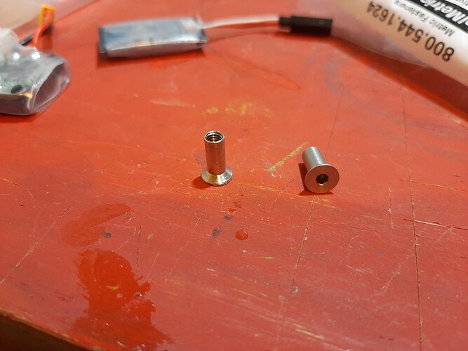

Imo if your gonna use riv nuts it’s straight up better idea to jam and epoxy a nut instead
You leave that tiller battery in your car?

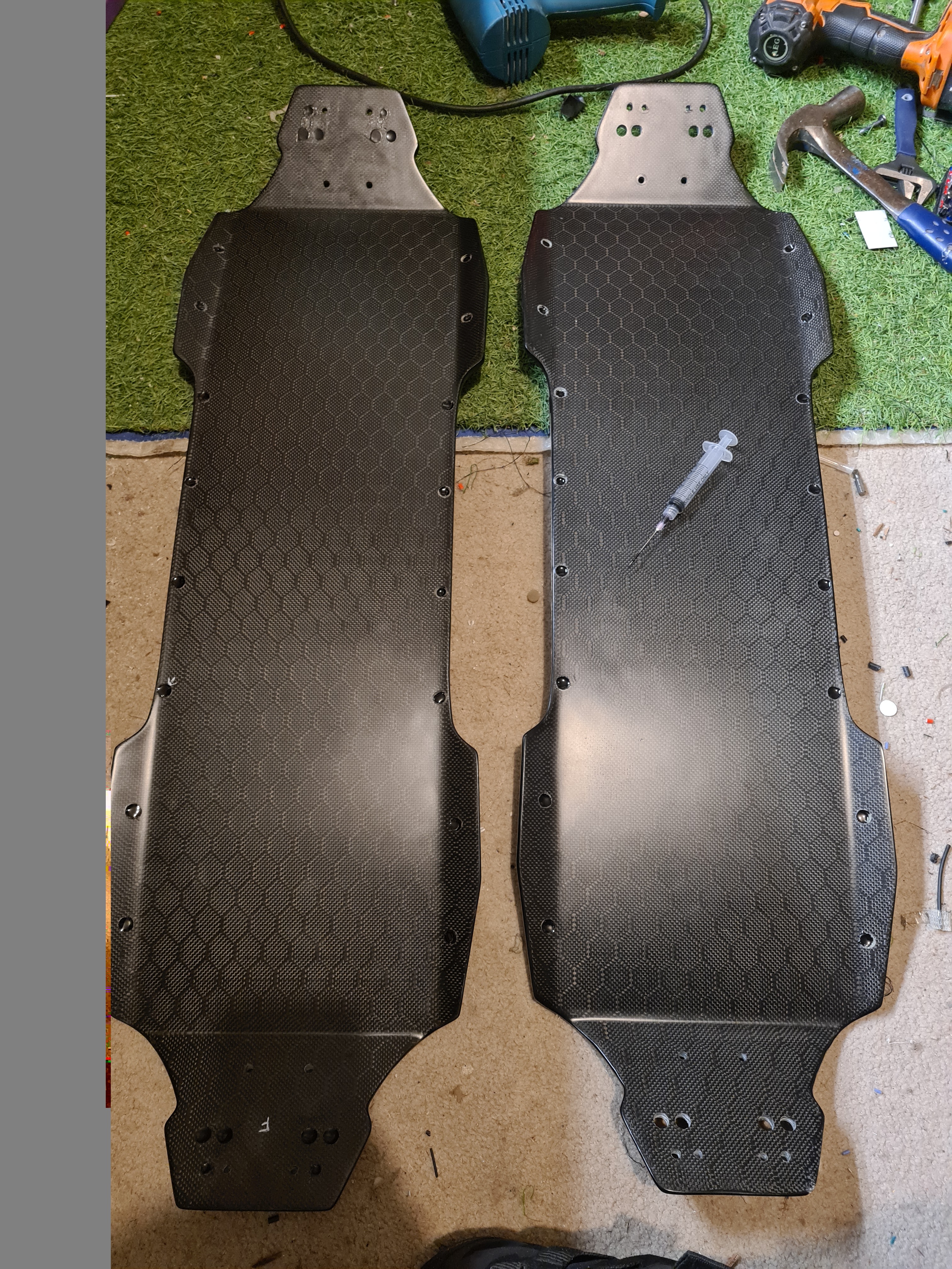

I think the rivnuts are fine. But i’ve installed gaskets to both enclosures and they no longer line up well.
Plus, they were all proud of the deck surface and i need to skin these decks.
Plus, they’re open all the way through, so skinning over them becomes troublesome.
Filled all the holes with epoxy, now i can relocate them and use barrel nuts instead

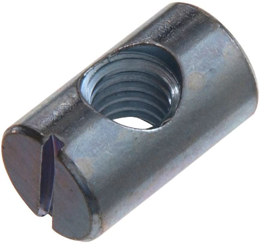

That damn near 45$ in barrel nuts here in the states
Yeah i dont think about that :rofl:
Barrel nuts like those?
But not those
Yeah the top ones.
You can get countersunk ones tho
Interesting, do you use loctite to attach the enclosure?
Like these
sex bolts
