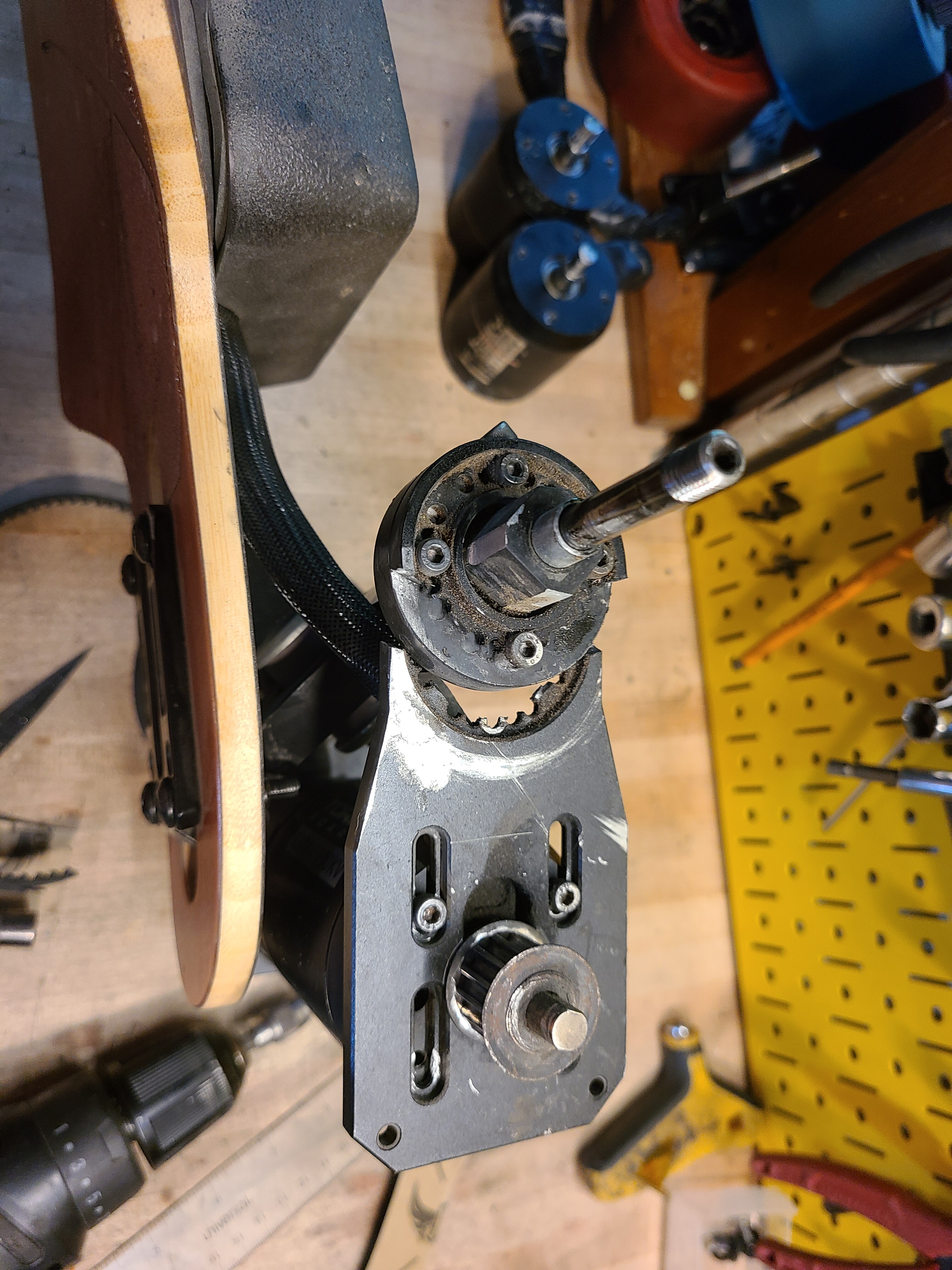

Is that the standard or reverse mount? :stuck_out_tongue: :heart_eyes:
got the standard, also adjustable baseplate, so i can get it closest towards the tail

Do you like using those on a deck? I thought the non threaded section was supposed to compress when tightened making it suitable for thin material like sheet metal.
Yikes. Manage to stay on the board?
Yeah. It was no big deal.
It was a gentle and kind slow failure…
I was going slow around a corner and it just got bogged down as the belt crept onto the wheel…
It probably works great on carbon fiber with a dap of epoxy, carbon is so hard that it probably would take a lot of force to get those out
Thats my guessing anyway
I am still not convinced.
A bit of epoxy would make it stronger i agree, but i would still be afraid it would slide off with vibration. I removed some of those on a wooden deck and it didnt take much, plus they came out almost undamaged.
Well it depends on if the screws go through the deck or not
Also, I’m pretty sure the rivet part is supposed to compress when the tool comes out, but I could be wrong.
Yeah the part that is splined is supposed to widen out when you install them
No i don’t like them. Hence why i pulled them all out :stuck_out_tongue_closed_eyes:
installedBottom Yeah found a pic, thats what it does
Now, i wonder why people use them with thick material, being composite or wood. Regular threaded inserts would be better in my opinion, specially if used correctly.
it’s just safer, there’s pretty much no way for it to say fuck it and become loose or come off, the tighter you screw the screw the tighter it grips to the metal
those shouldn’t be used as threaded inserts tho
The reasoning is
good threaded inserts $$$
good rivet nuts $
Custom threaded inserts $?$ and time
I think if you roughed up the outside of the rivnuts with lots of cuts and used good epoxy you could get away with them fine.
