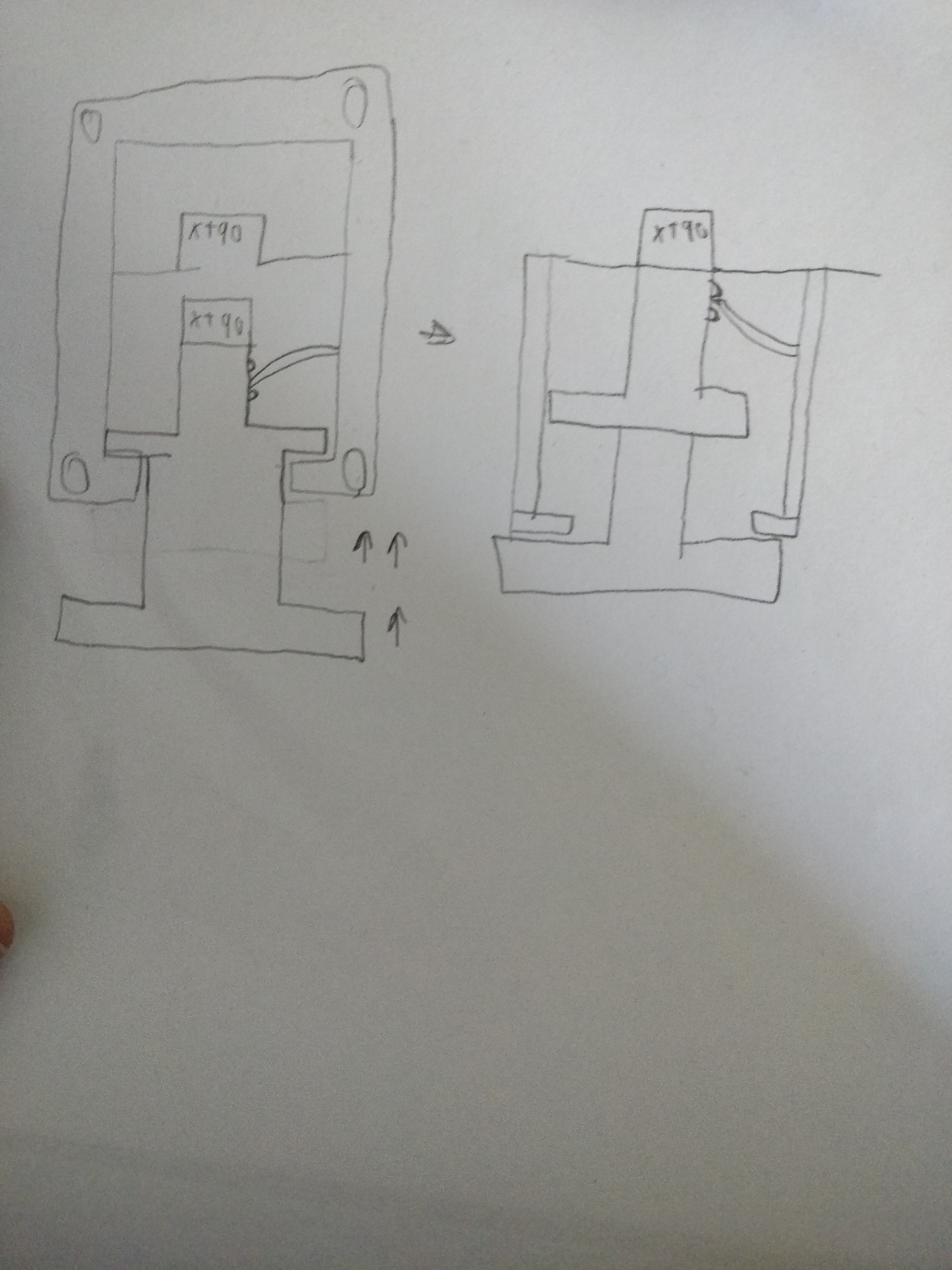

@janpom Could implement a very small and simple compliant mechanisim that would help locking the key in whichever position its in, so it requires a greater force to push or pull the key. It would need probably 2 or 3 iterations to get it just right but to mee it looks like a good solution.
Edit: Crappy drawing

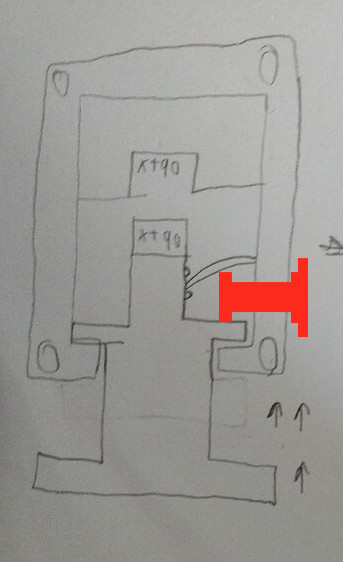

It already requires quite a bit of force, especially with a new XT90 male connector. The one I have is already pretty worn out and there’s less friction. I had a new one for mocking things up and that one worked really well. Still, even with the worn out one, if you hold the board in the upright position, the gravity on the loop key itself is not enough to close the circuit.
Your diagram is giving me other ideas though. I could add a simple locking mechanism that goes is from the side. Something like this:
Push to lock. Pull to unlock.
Maybe that’s too complicated though. I could just as well make a simple part that I slide on the handle and that will then sit between the handle and the deck and thus prevent the handle from being pushed in.
I think that would be an also elegant solution.
I feel that your loop key it’s pretty unique and that it deserves a cool and elegant way to solve the locking problem, even though that part would be very useful so you could make it and then iterate your design for future updates
