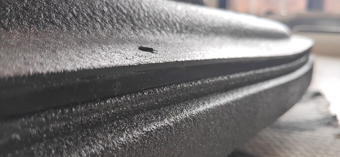

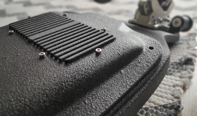

I’m not a huge guy, but I am 6,2, so the board is somewhat small for me, in general as a build it’s great, really light, great rolling, should be watertight. Running 10s2p 30q pack, at 15 battery amps only, so really interested to see the capable range.

It’s Raptor bedliner on first layers (and the enclosure, black colour) then 2 layers of texturized spray (grey/anthracite) for fences :laughing:
I still have to glassfrit the top but I guess it will be quite stealth due to the rugosity of the surface as it is now.

Nice I used similar product for a integrated deck as well. It’s a nice sturdy coat. The combination with the raw truck is crazy good.
What drive train are you gonna use?
Yep i also added a 6mm neoprene stripe just before spraying the Raptor so it looks like integrated with the deck + 5mm regular neoprene gasket (which will get compressed when bolted so it won’t be 11mm, more like 7-8mm). I need to raise the enclosure as a brand new 10s3p with fat p42a cells is coming from @pjotr47
For the drivetrain I’m also waiting for @3DServisas v5 urethane helical in raw, of course :heart_eyes:
Don’t forget your Hammock baseplates are also there :love_you_gesture:
Edit: Shit the colours seem the same depending on light but deck + heatsink are anthracite and the enclosure is black.

It doesn’t look like your axle nut is fully engaged. Careful you don’t lose a wheel while riding

is the case for the gear drive only 4mm off the ground?
i have been wanting to try the BN gears, but have not opened my heart to the idea of using them with Caguamas as i was worried about clearance.
