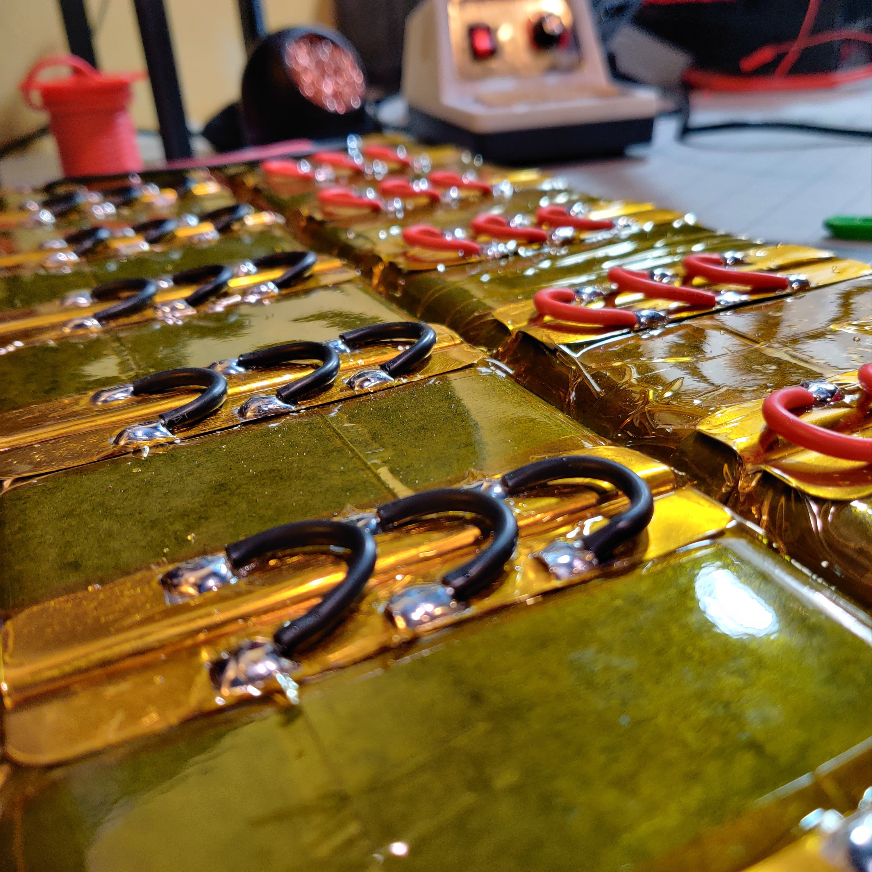

How do you (or anyone here) keep the cables bent like this while soldering them to the tabs?

Want to know as well.
I hold them gently with large hemostats that aren’t locked. Just using them as tiny pliers.

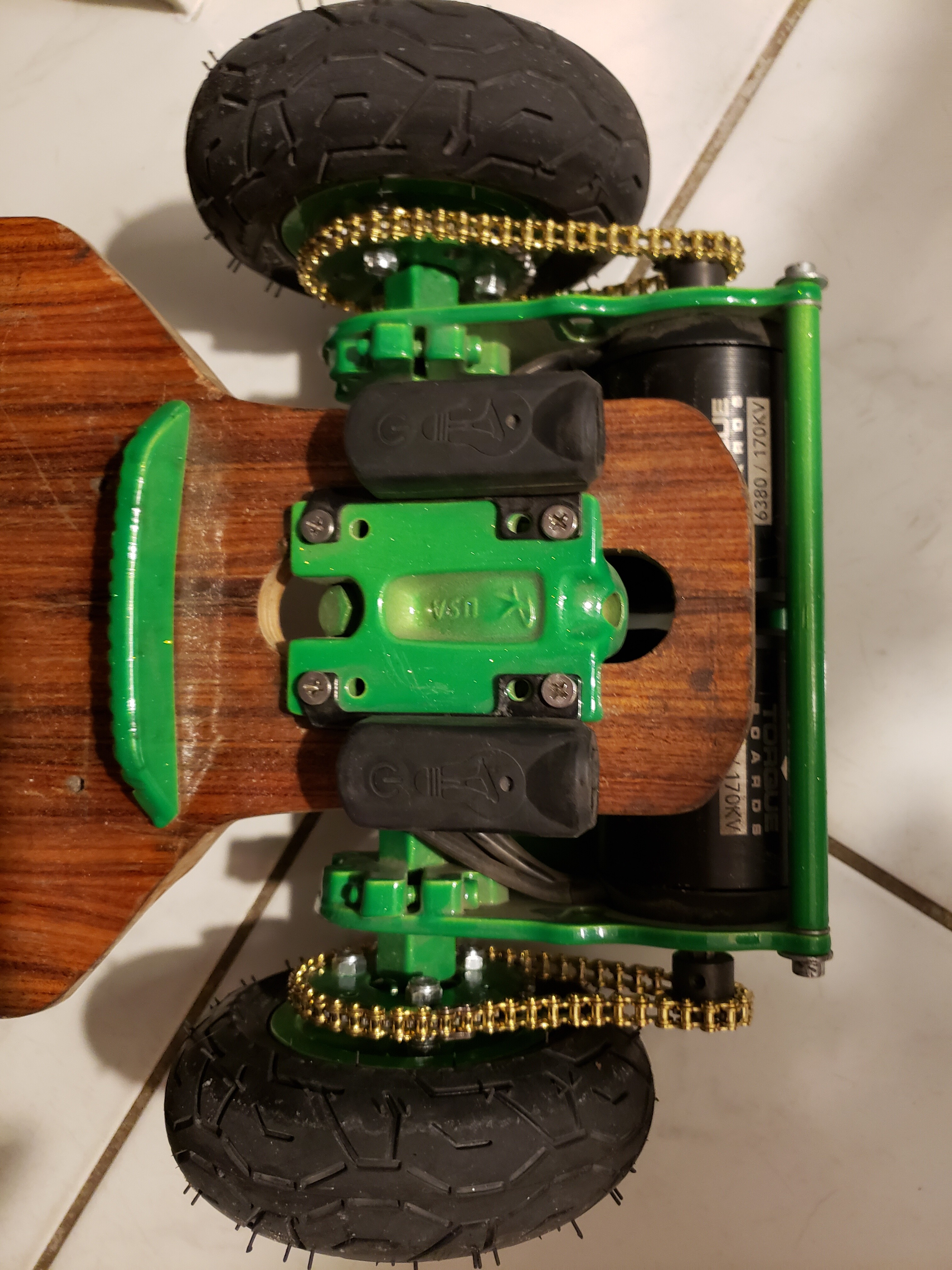

Somebody say chain gang?
What size chains are those? Do you like them? Are they noisy?
Do they work well at high speeds?
From where did you purchase the sprockets?
25h, this is my backup board, so it doesn’t get much use now. But I trust those chains with my life.
You can lock up the rear end and slide with chains.
They make noise. But aren’t crazy.
I hit 42mph with that setup.
I got the sprockets on ebay and drilled them myself.

I tried keeping it bent with my fingers once for a loopkey, couldn’t stand the heat. The wire whipped back in position and threw some hot solder on my tummy :joy:
They are copper, and copper will hold its shape if you bend it :man_shrugging:
I usually have to over-bend the cable, so not just into a U shape but into a full loop. Then it will be deformed enough to stay in a U shape
But I dont just let the cable sit there while soldering. What I do is:
  • I line the wire up over my prepped solder pad with my left hand,
  • press the wire down with the soldering iron in my right hand,
  • grab the solder spool with my left hand while the wire is pinned by the iron,
  • flood with solder,
  • press it all together with the soldering iron until it flows nicely,
  • then using a snap knife in my left hand to press and hold the wire exactly where I want it in the solder puddle until it solidifies.
  • Finish by dabbing with a damp sponge to cool off the nickel quicker and reduce the amount of heat that is allowed to penetrate into the cells.
At all points in the process something in my left hand or right hand is holding the wire exactly in place, until the solder solidifies.
I hope that over-answered your question!
Thanks for the detailed explanation man.
Nope that’s exactly what I wanted to know
Cool beans. I have found that if I am not pressing the wire down into the puddle of solder with the snap knife, then it kind of ā€œfloatsā€ to the top of the puddle and doesnt get that really clean domed-over look that Bill was creaming himself over in Artem’s pic.
