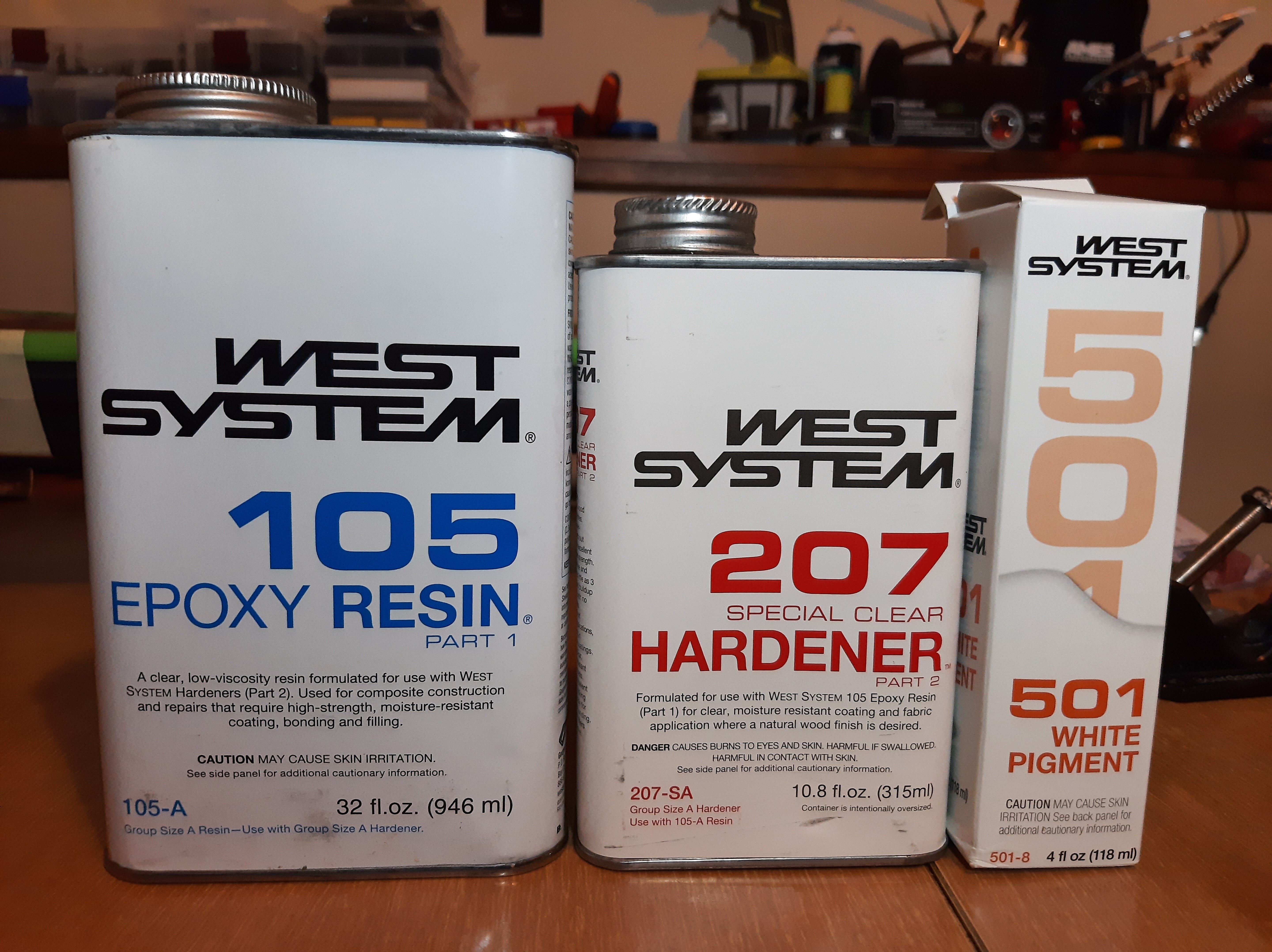

Lol, didnt get pumps, saved 30$. Gonna mix by weight and use large syringe for transfer.
Gonna be fun learning in the shop when rest of materials come in. :metal: :crossed_fingers:
