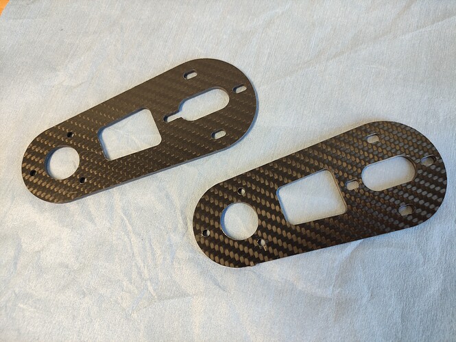

Had a small glitch while manufacturing but overall easy to do with Fusion360 and Mach3
